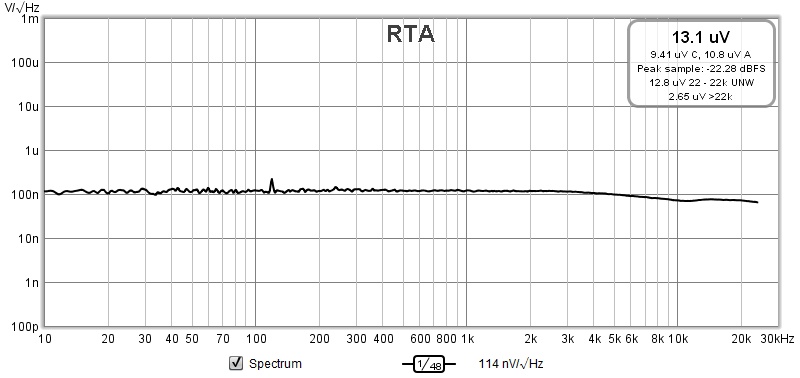

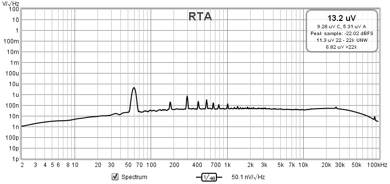

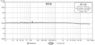

2nd try at VRDN Measurements
I calibrated my LNA and ADC with a 1K resistor soldered into a BNC connector right at the input of the LNA. Then adjusted the gain on the ADC to get approx. 4uV/square root Hz. 1000 times 4nV/square root Hz.
I then attached the VRDN positive rail to the LNA through a coaxial cable terminated with a BNC connector on the LNA end and the wire and shield at the other end.
If I am reading this correctly, I divide by 1000 for the LNA and get approx. 20 nV/square root Hz.
Let me know if this is correct and I will measure the negative rail to get a baseline.
After that I can start to make changes and verify if they are helping or hurting.
I can also perform the with and without denoiser tests again.

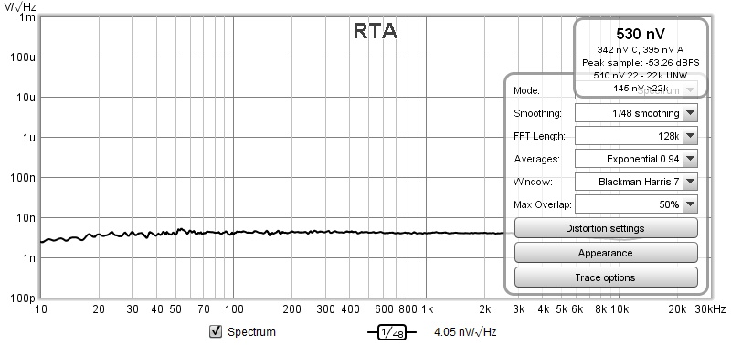

Joined 2014
@tombo56 I calibrated the input level at 1mV, the second I hit enter it changed it to the FS sine Vrms of 1.351. Anything you enter in that calibration box it changes.
Just had a thought, are you hitting the calibration button and opening the other box or just entering 0.001 into the FS sine VRMS box?
Joined 2014

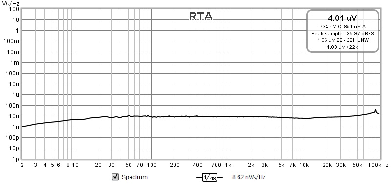

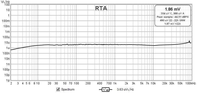

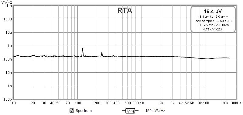

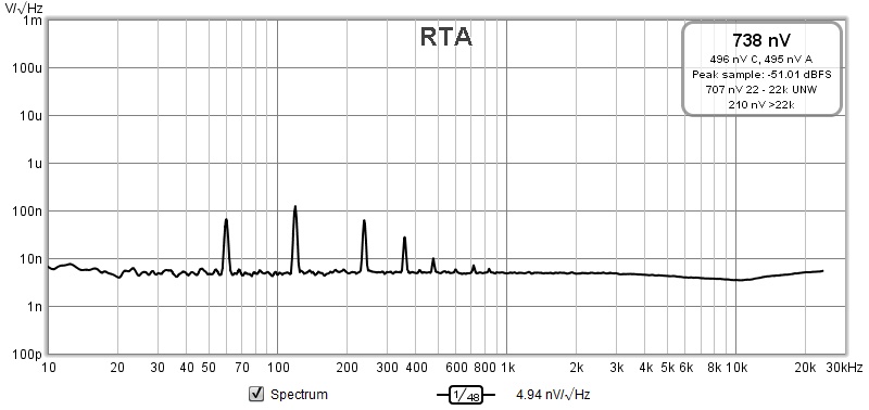

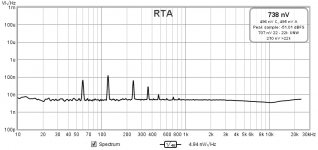

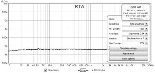

I think I calibrated wrong with the pictures above. Correct me if I'm wrong, I should use the number in the upper right box to calibrate to 4nV with the 1k resistor on the input, right?
If that is the case, here are the corrected graphs.
Calibrated with 1k
VRDN Positive Rail

Joined 2019
Don’t look at that box. There is a total voltage in the specified bandwidth. Just read V/rtHz scale at left. For the1 K resistor, fft graph line should lay at 4 nV/rtHz value (look at 1 kHz frequency and disregard lowest and highest frequency readings due to the shortcomings of the audio interface and LNA). After confirming that, proceed to the VRDN measurement. Expected noise level is below 10 nV/rtHz.
Yes, with 1k resistor you should get a straight line that lays on the 4nV/rtHz value on vertical scale (see post #352). The plot becomes much more readable if you change the vertical scale to run from e.g. 1uv/rtHz to 100pv/rtHz. You can also set the horizontal scale to run from 10Hz to 30kHz.
Joined 2014
I did some more reading last night and this is all starting to make sense. The 4nV/rtHz is the noise at that particular frequency or bin (Noise Spectral Density). The reading in the small box to the upper right is basically the total of the noise over a set bandwidth. By using the resistor noise calculator software, I get the following results:
1000.0 Ohm resistor at 20.0 °C within 22.0 Hz to 22000.0 Hz frequency band will have :
Noise Spectral Density = 4.023618e-9 V/√Hz or 4.0236 nV/√Hz
Noise within desired bandwidth = 5.965005e-7 V or 0.5965 uV
I can either use the graph line and line up 4nV/rtHz or use the number in the small window and use .5965uV.
Either method should be accurate as long as the low and high limits set in the REW software match the readings above.
BTW, I used 22-22k, because REW already shows you that number in the small box at the bottom all the time.
