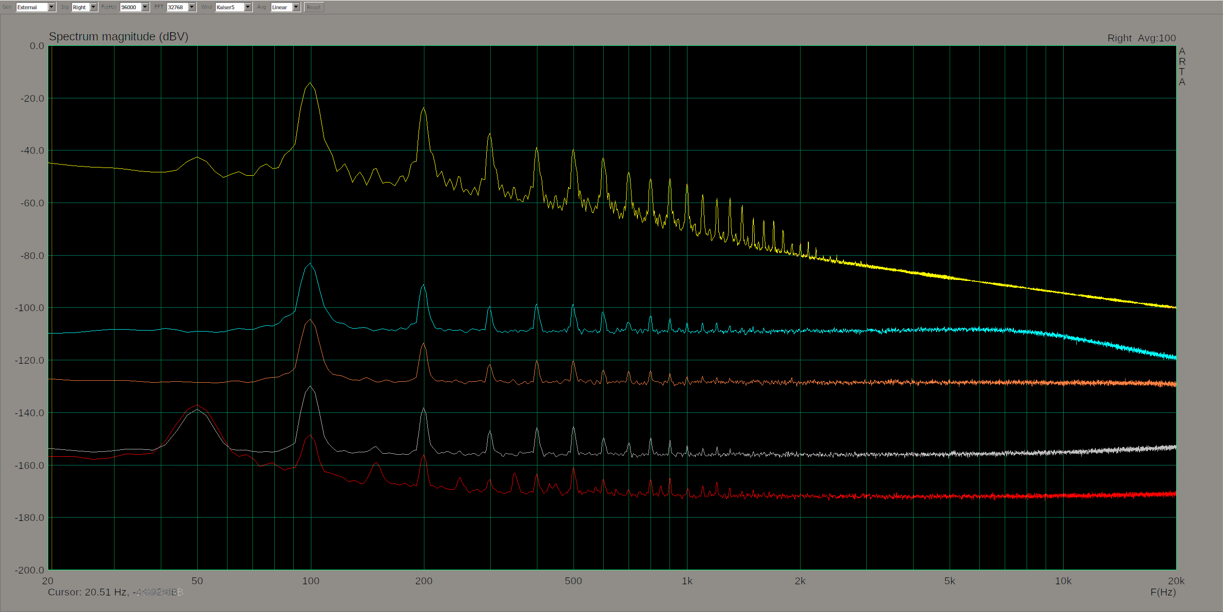

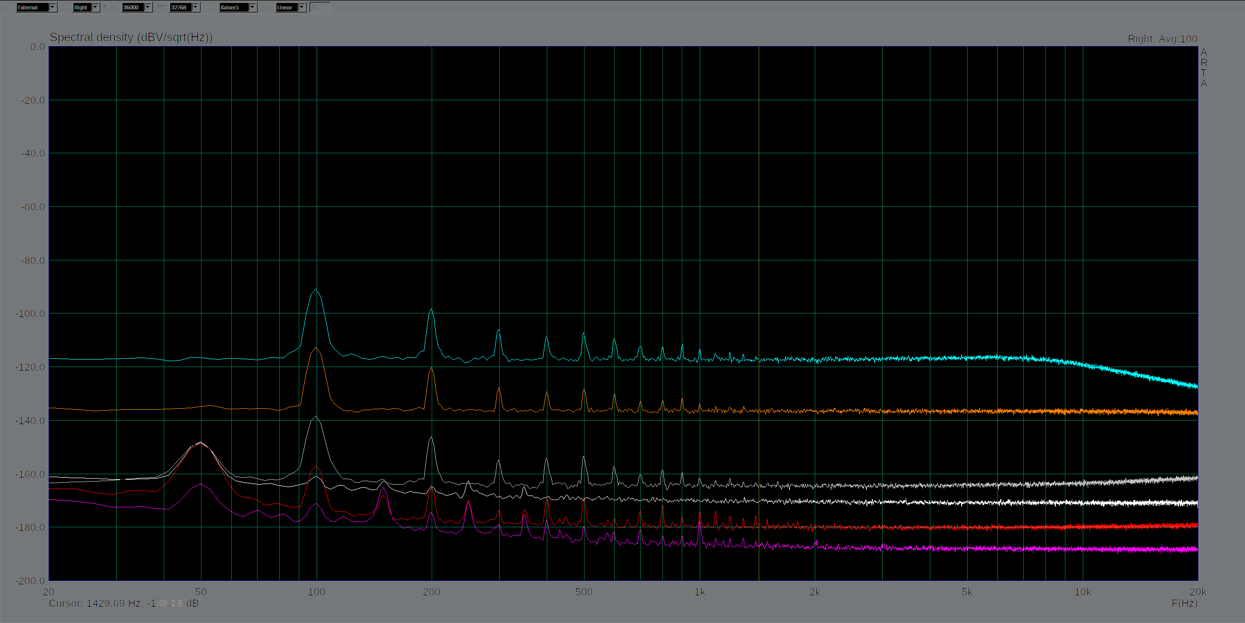

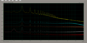

I made a zip file with each individual measurement with the value of the signal of interest. The files with the N_ prefix are of the dBV/√Hz measurements. I attached here just two photos so to not be cluttered, and I overlayed all measurements in each.
The first photo is of PSRR measurement. I set the scale to dBV this time, I also added the 1000x gain, I used 1x gain for the input ripple measurement, I connected the ADC directly to the filter cap through a 47uF cap.
The traces in the photo are as follows from top down:
- yellow trace - input ripple
- cyan trace - normal LM337
- orange trace - LM337+Cadj
- grey trace - LM337 + denoiser
- red trace - LM337 + dienoiser
Second photo is in dBV/√Hz and traces are as follows from top down:
- grey trace - LM337+denoiser
- white trace - 1k resistor
- magenta trace - LNA input grounded.
As seen in each individual measurement photo, the LNA noise/1k resistor match in previous values with 1300mV set in ARTA for 0dB.

Based on your noise measurements your denoiser has about 7nV/rtHz@1kHz and the dienoiser has about 1.3nV/rtHz@1kHz which match quite well to what both Tombo56 and myself have measured (see e.g. here). So apparently both Tombo56 and myself are capable of making satisfactory denoiser layouts :D
One note on your measurements. When measuring noise there really is no need to have any ripple on input. So you could use e.g. battery voltage as input.
