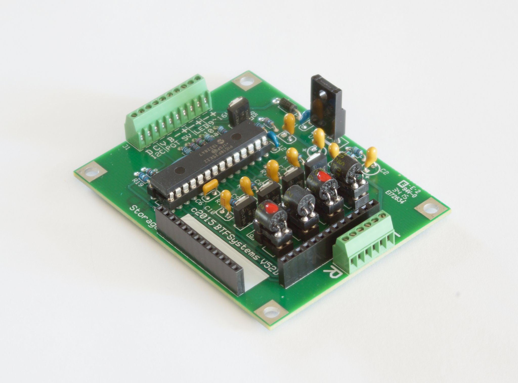

Just came across this thread, thought I'd put in my two cents worth -- I designed a PIC-controlled LDR volume control years ago and was astonished by the sound, I loved it. I guess it was my introduction to second harmonic tube-like sound. Started to market it and found that I didn't enjoy doing that so stopped.Most solutions seem to either use matched LDRs (a pain to match) or use processor control, which then often is used for relay input control as well as both kinda go together.
Someone who was in a position to actually measure the performance found that the channels tracked within 0.2db of each other and to a true log curve (as I recall, the calibration routine used more than twenty points on the curve). And, yes, I used a relay-controlled input selector and it was all controlled by an IR remote and rotary encoder with OLED display to manage it all.
The attached image is of the LDR controller board, everything else was on separate boards.
