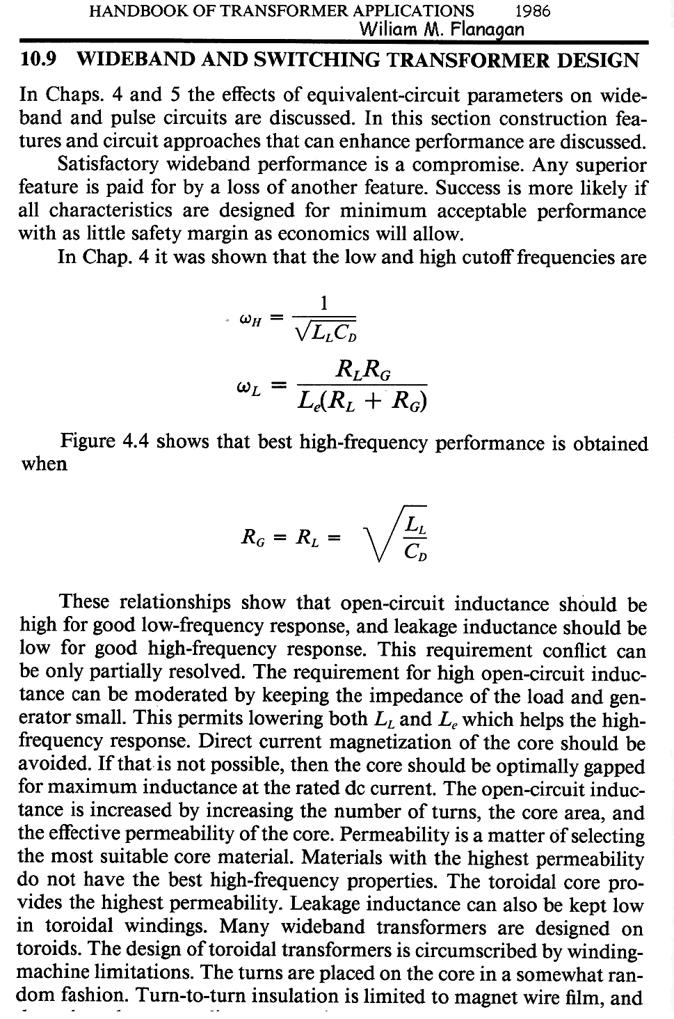

I don't have the specific book at hand, and am too tired to go up the attic for my Ruben Lee. Here's Flanagan Handbook of Transformer Applications 1983. If you think he is wrong, please write the book.a low source or load impedance is not absolutely necessary as the transformers parameters can be adjusted to handle it.
"Satisfactory wideband performance is a compromise. Any superior feature is paid for by a loss of another feature."

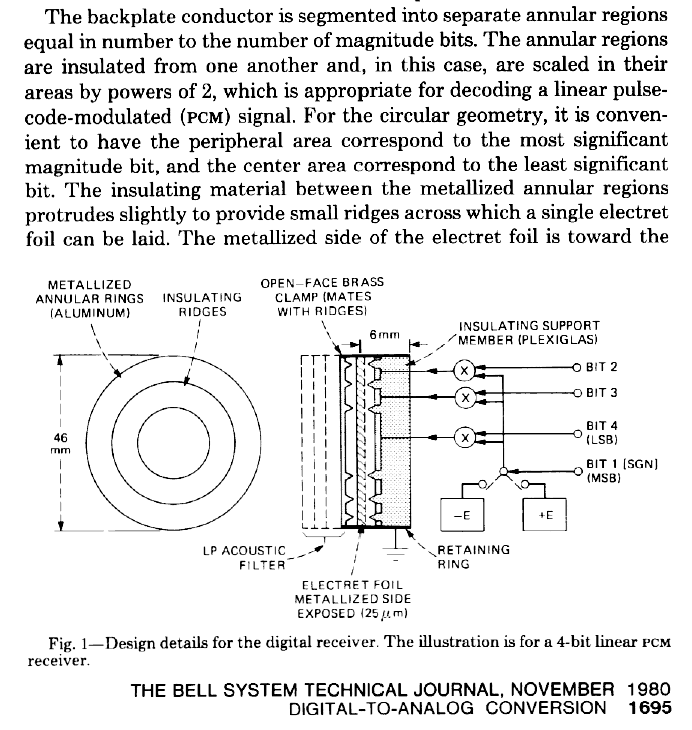

I love the picture of the 1948 analogue to digital converter: a special cathode ray tube, see pages 33 to 35 of https://archive.org/details/bstj27-1-1/page/n33/mode/2upThe most astonishing one I saw (I don't know if it was published outside the Labs) was the direct digital receiver (earpiece). The electrostatic diaphragm was divided in 8 sections each twice as large as the one before. 8-bit data was put right to the sections, LSB to the smallest etc. The ear-cup integrated and filtered the pulses. This may have been very late 1960s. And yes, it gets impractical along about 8 bits, unless you do a further division with voltage leves.

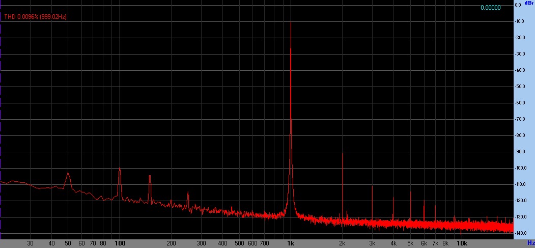

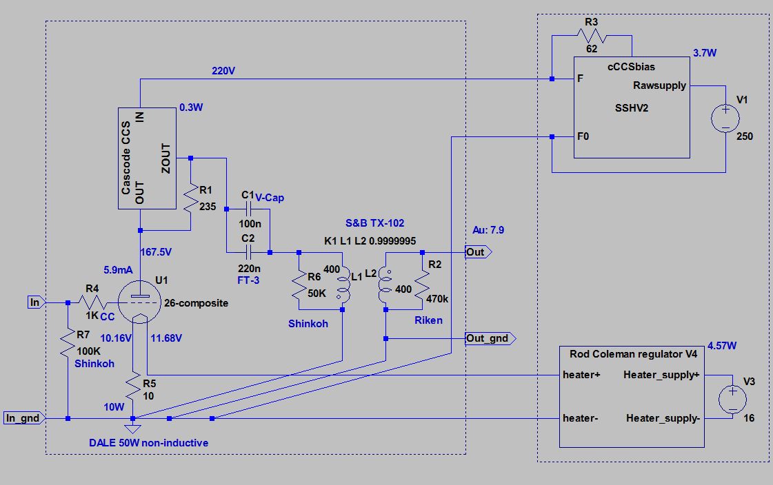

Nice #26 peamp measurements. I see you used a TVC.
Was the TVC on the output?

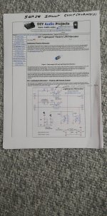

Tracking?Cough.... LDR based systems anyone? cough.... 😀
Most solutions seem to either use matched LDRs (a pain to match) or use processor control, which then often is used for relay input control as well as both kinda go together.Tracking?

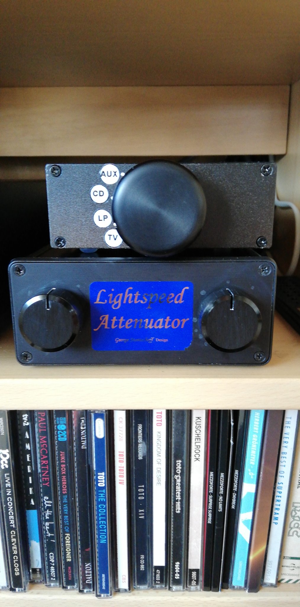

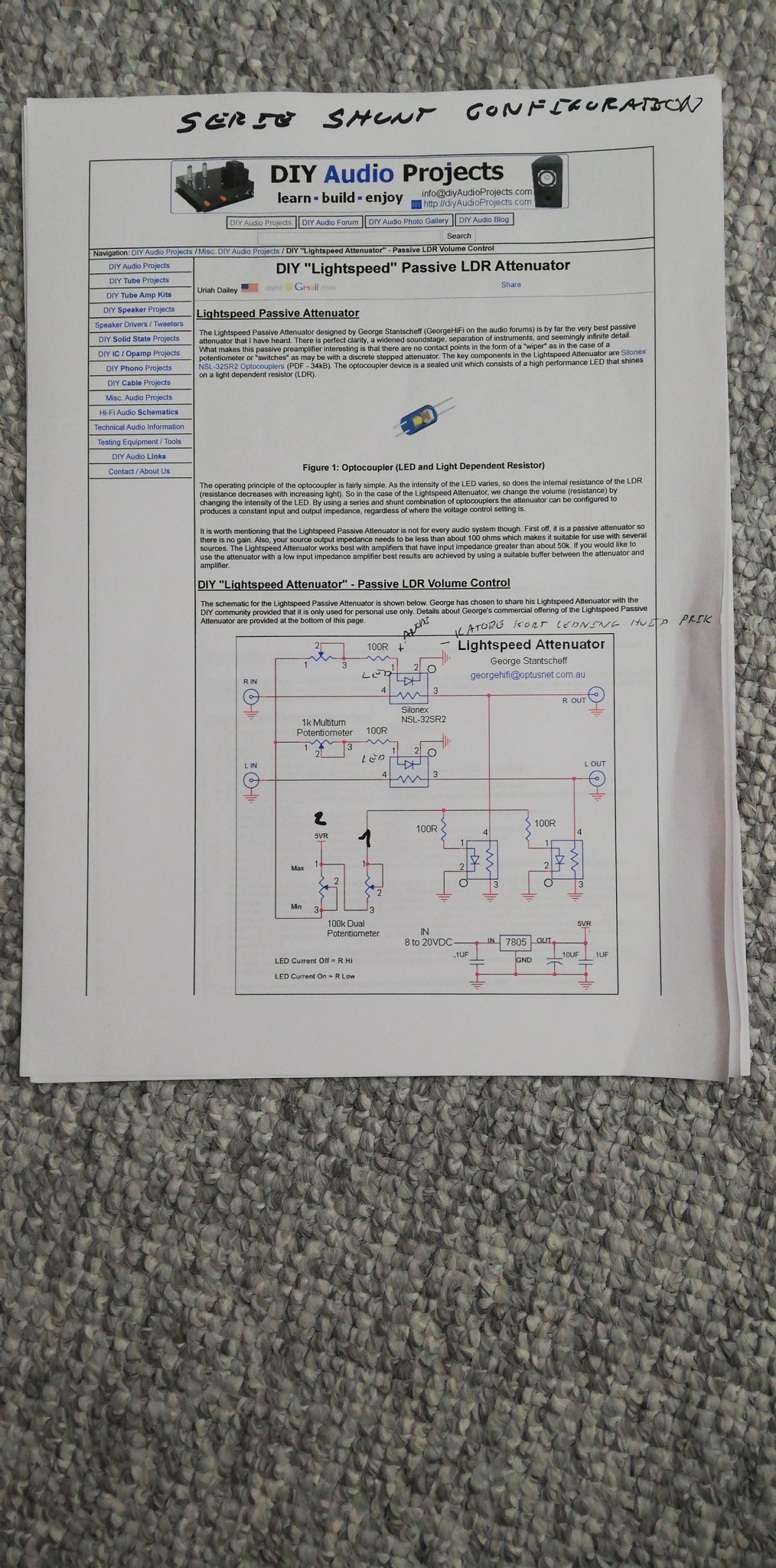

Translation by Google: "I have George Stantscheff designs from Australia. Joints and light-sensitive receiving teeth (Optocoupler) this variable on both L and R channel."Jeg har George Stantscheff design fra Australien. Led og lysfølsomme modtande (Optokoppler) det her variabelt på både L og R kanal.
Remember, all posts much be in English or have a translation included 🙂
