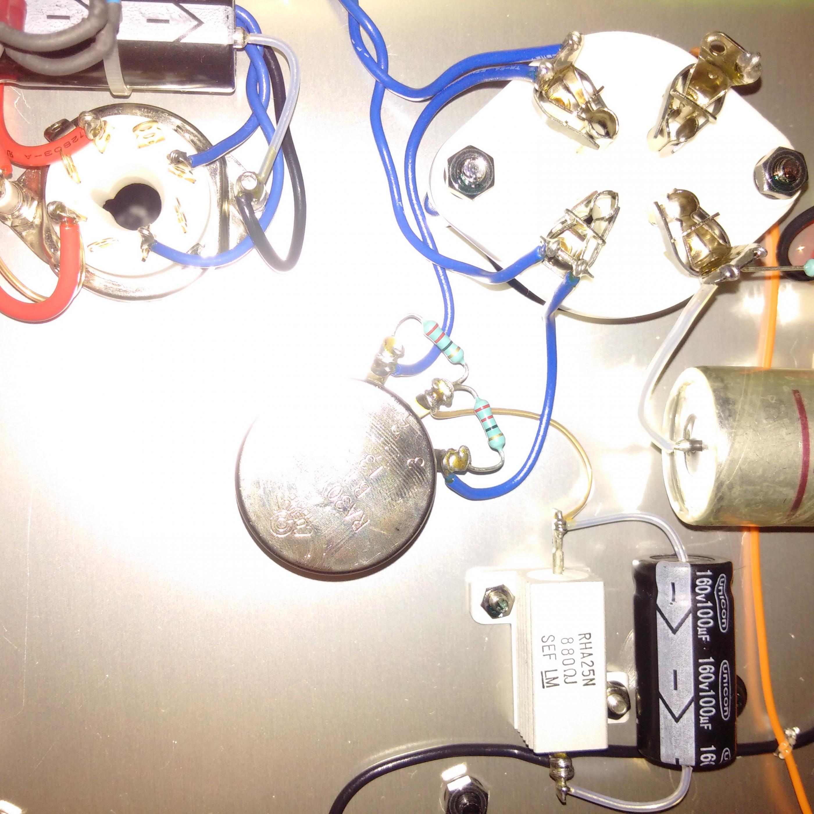

volume control by pass power tube
There is a volume control placed between the two big Pins power tube. Can I by pass it? What is the effect of turning it down (counter clockwise) and turning it up (clockwise) on the power tube it self? More or less power? Thank you for your help

This is not a volume control, but a humdinger pot.
It is used to minimize the hum when using ac to feed filaments/heaters.
What DHT are you using?
With low voltage types like the 45 and 2A3 you can get away with ac, higher voltage types like the 300B often are better off with regulated dc.
The minimum that you should do is properly twist the wires to the 'big pins'. The way it is now surely gives unnecessary high hum levels.
edit: read the sticky about heater wiring http://www.diyaudio.com/forums/tubes-valves/211731-heater-wiring-good-bad-ugly.html
Hi, thank you very much. I am using 2A3. When i turn down all the way the hum goes up and when i turn up all the way up the hum goes up as well. I found the lowest hum at 10 o clock. The bass seems a bit punchier and lower, is it safe? I do not remember the correct or original set up but it is more than 10 o clock.
That pot should be standard equipment for any DHT with AC filaments and should include the two resistors attached to the wiper. There is no "up" or "down" since it is in parallel with the filament transformer. It should be left in place and adjusted for lowest hum.
Your amp is cathode biased: the 880r resistor is the cathode resistor.
Without schematic and measured voltages it is all guesswork, so keep in mind things could be different...

Essential: improve the wiring and/or move to regulated dc on the filament.
