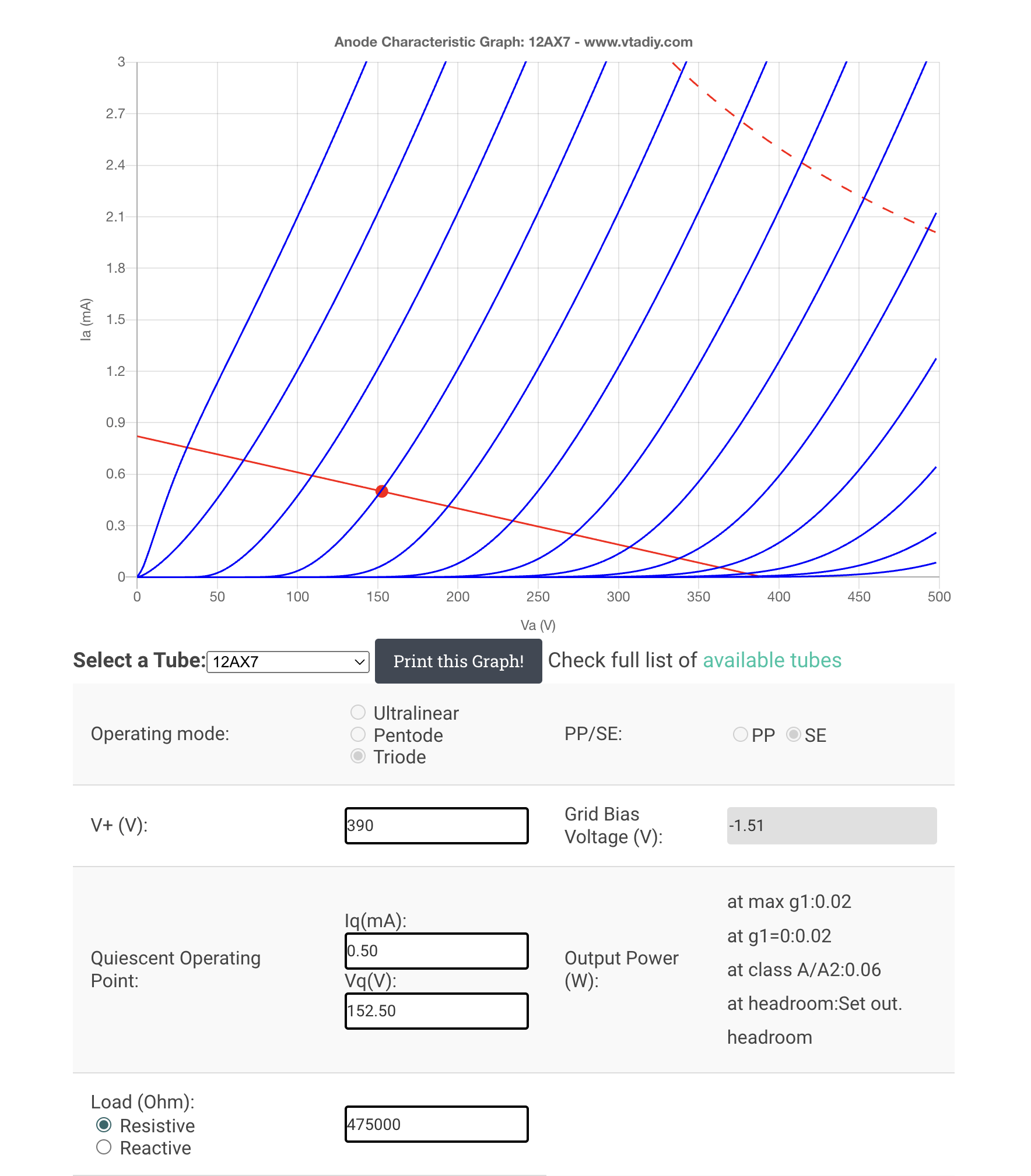

voltages making no sense - help!
V2 has a special case where the load impedance "downstream" of the valve's own anode resistor is so high that it can be ignored - excellent! We need only mark two points on the axes and draw a straight line. Your posted curves are close but not exactly on classic American curves for 12AX7, plenty close enough, and the missing grid voltage curves' markings are in 0.5 VDC increments from zero (left).
Your operating "curve" (although we're drawing a straight line resistive approximation, the actual loadline is slightly elliptical because stray capacitance "fattens" the line, linearly variable with frequency; not a significant issue within the audio range in this particular case, but surprisingly significant in other cases) is a straight line from a point on the X axis at B+ (let's call it +378 VDC) and a point on the Y axis at +378 VDC / 301K Ohm (the anode DC load resistor). This is the current that would occur if the valve were able to conduct completely - a dead short. So, the reverse slope of this line is 301K Ohm.
As the voltage on the grid (blue lines) varies, anode voltage (on the red loadline) varies with it. 12AX7s are amazingly linear, so some amount of grid voltage change causes pretty much the same amount of anode voltage change at various places along the loadline, but there are definitely better and best places to operate.
If this is too simplistic, or not the actual thrust of your question, please restructure it and I'll try my best.
All good fortune,
Chris
