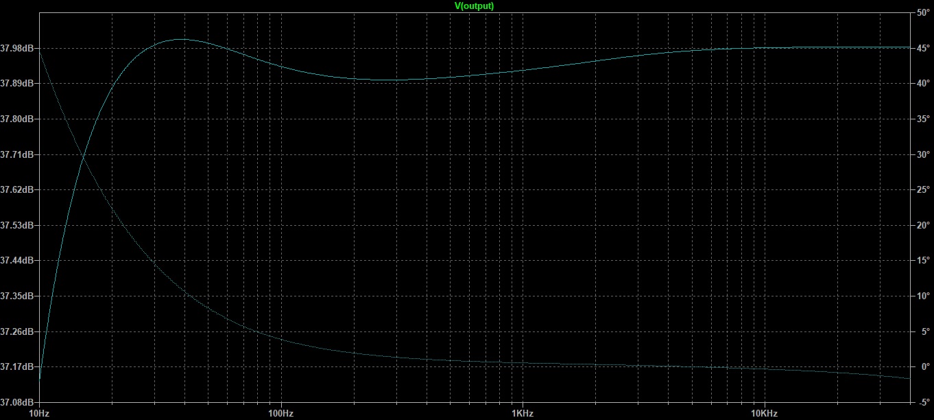

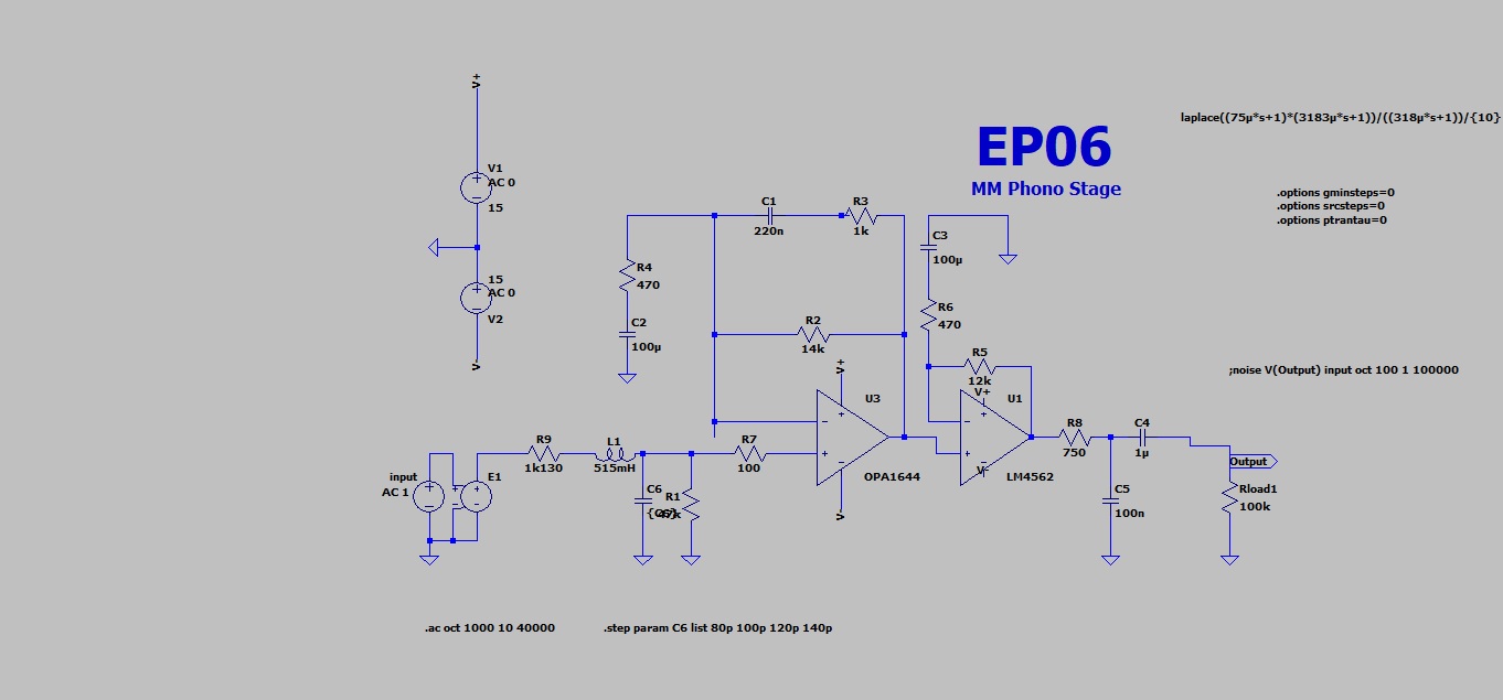

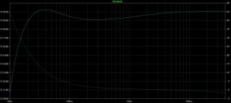

With the help of tutorials such as https://www.analog.com/media/en/training-seminars/tutorials/MT-038.pdf , datasheets are the easiest way to select the best opamp for the application, be it for noise, offset current, voltage etc. However, there is also the price and availability factor. You simply can't buy the best genuine, current products for just 50c through an online selling platform, as I've seen OPA2134 offered recently.
Also visit TI's site for the masses of multiple references, docs, tables and performance comparisons they keep there in the public domain.
The EP06 is a good one.
Use the "right" values to get a flat response with little noise:
