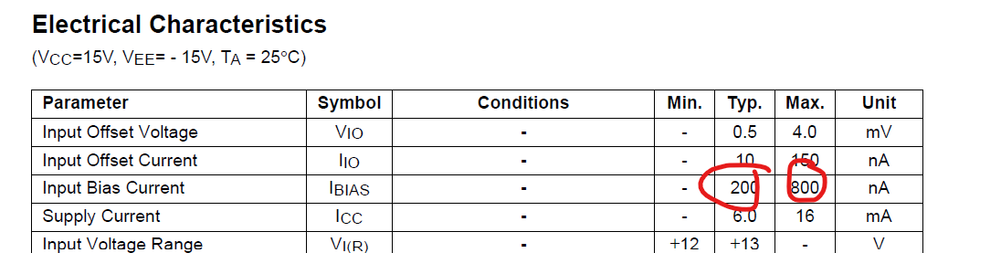

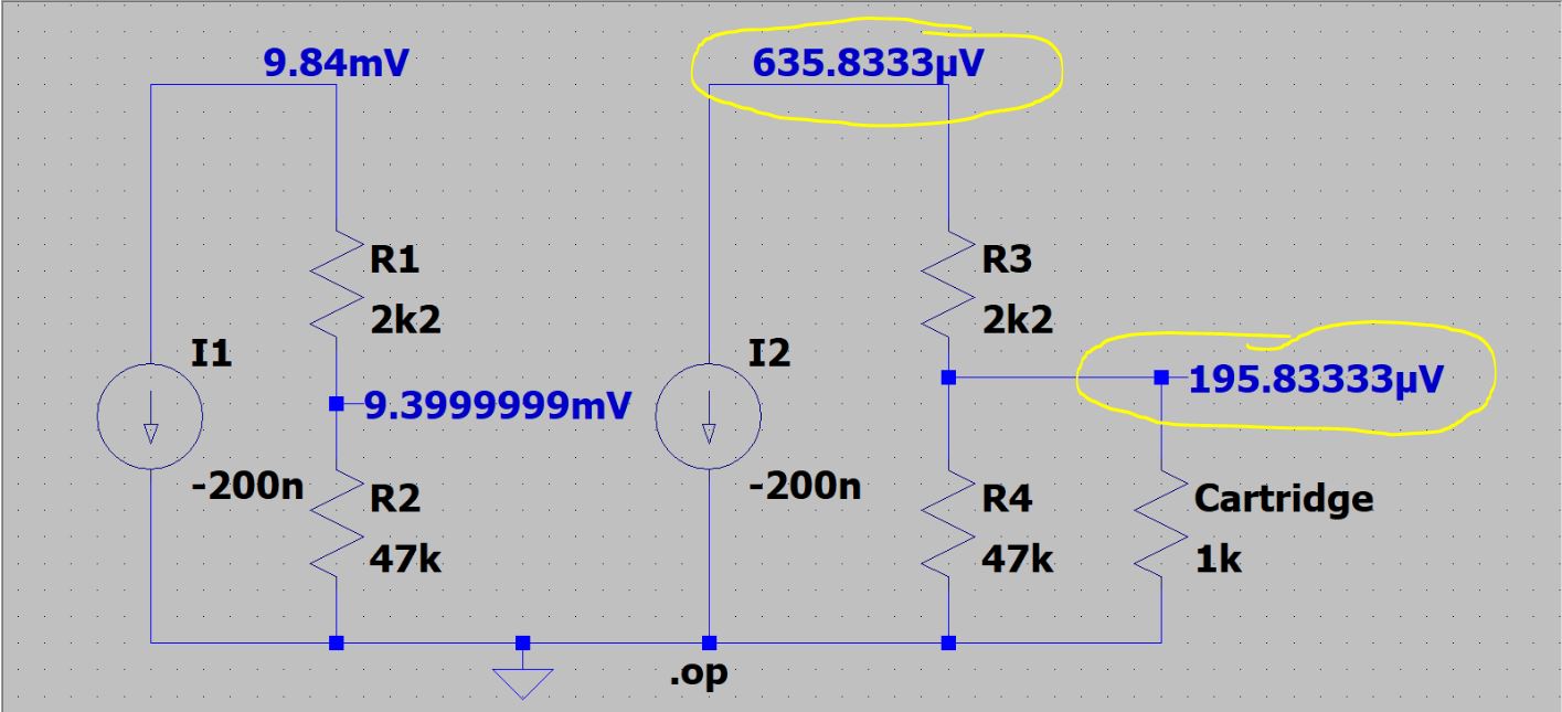

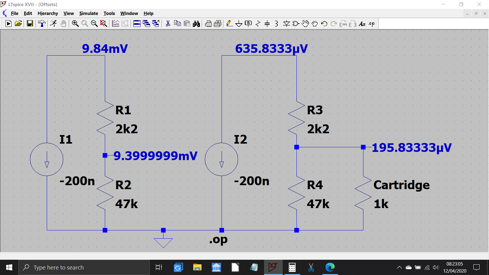

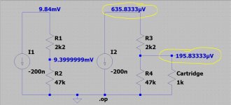

Actually, on Rod Elliott's construction page for the P06, more specifically the op amp section of the "Guide to Components" page, he specifically mentions the use of the OPA2134 (versus the NE5532) because of the very low input current in case you are concerned about reducing the DC offset.
Question - does anyone have measurements of the input currents / offsets for other well-regarded phono preamp designs (commercial or DIY)? I think it would be an interesting comparison.

With the help of tutorials such as https://www.analog.com/media/en/training-seminars/tutorials/MT-038.pdf , datasheets are the easiest way to select the best opamp for the application, be it for noise, offset current, voltage etc. However, there is also the price and availability factor. You simply can't buy the best genuine, current products for just 50c through an online selling platform, as I've seen OPA2134 offered recently.
Also visit TI's site for the masses of multiple references, docs, tables and performance comparisons they keep there in the public domain.
