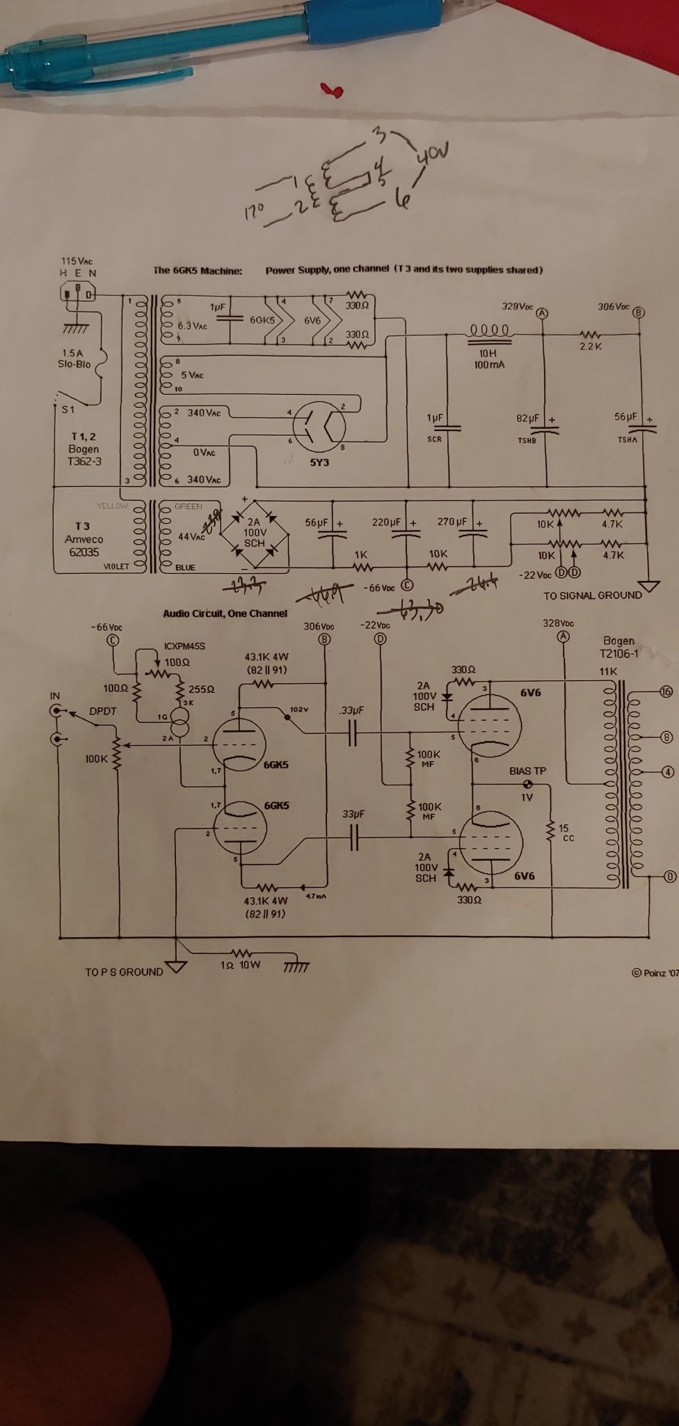

Why would heater leakage current take a different path? Why would it never go through the CCS? The heaters are practically grounded, so sit at 0 Vdc. The CCS is being fed with -66 V. So if there any leakage between heater and cathode, why couldn't there be current flowing?

I've tried the center tap on the filament transformer grounded, not grounded and hooked up exactly as schematic with the same results.
That is ground lift resistor. The electrical earth is connected to chassis and electrical ground of amp is connected to earth via a resistor so it's avoid pick up unwanted noise, hum, buzz etc below the difference of two ground potentials.

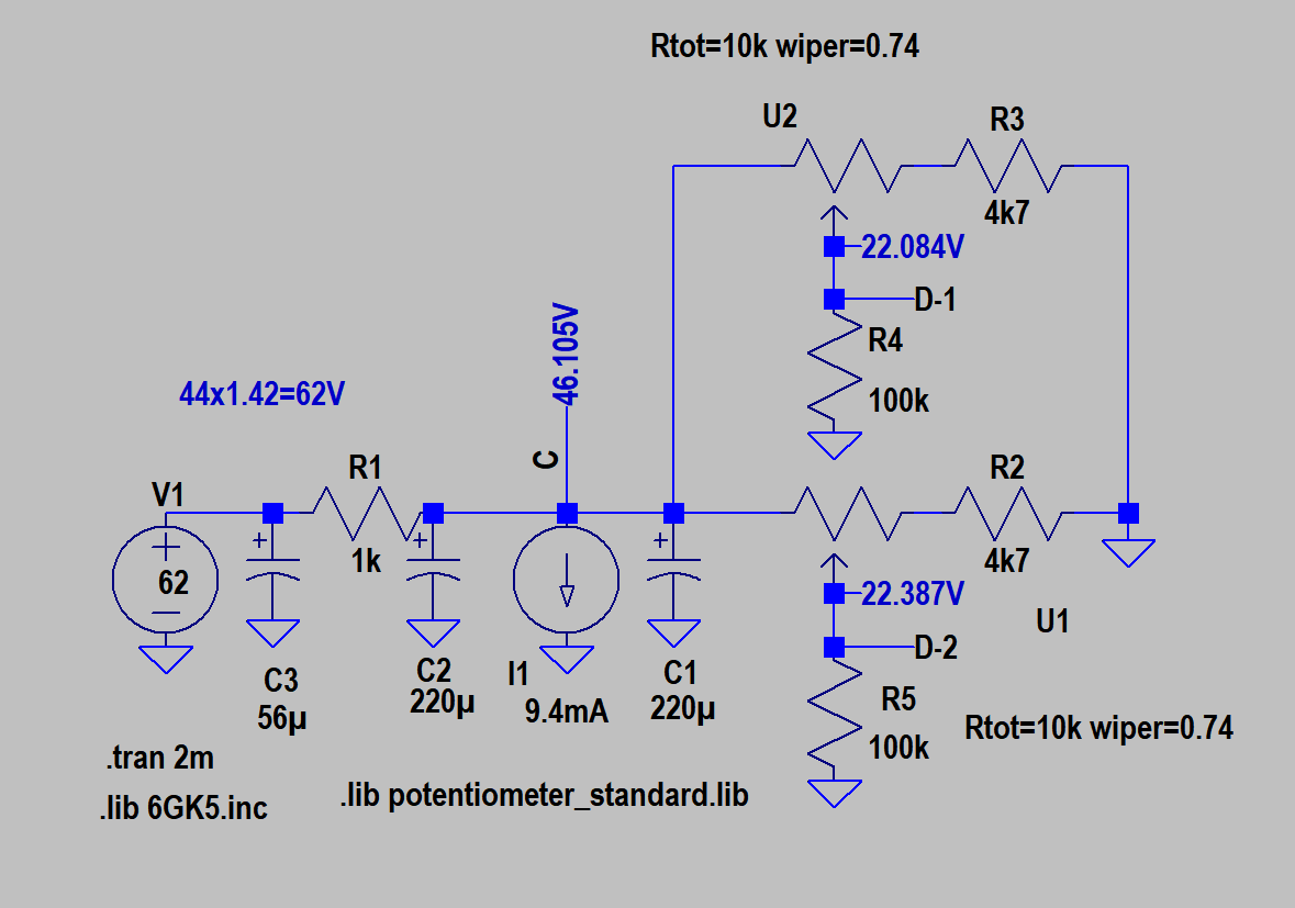

This sim shows that CCS current flow in both grids when B+ is 0 or not connected, regardless of whether a heater leak or not.
So that is considered normal, there is no leakage after all.

It is you who didn't prove anything that you wrote in your post #14. You started to use ad hominem arguments, starting in that same post # 14. I assume that it was caused by you being oversensitive for arguments that are not in line with your line of reasoning and/or me pointing out that you didn't get all that TS already wrote and showed (schematic in post #1) before.

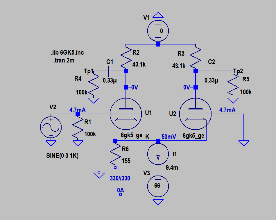

About your simulation in post #30: What is the internal resistance of V2 in your simulation? If it is anything more than 0 Ohm, it would be impossible that the grid currents of U1 and U2 are of equal value.
A grid current of 4.7 mA at a voltage difference between cathode and grid of only 50 mV (with the cathode being positive with respect to the grid) seems unlikely to me. I know that grid current already starts from about -1.3 V (with the grid being negative with respect to the cathode) so I know that some grid current surely will flow. But could this grid current really be 4.7 mA at only 50 mV voltage difference?
