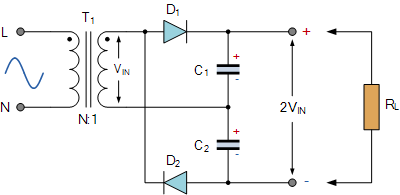

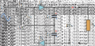

Here's an example using capacitors that are far too small. Ideally, you'd use HV diodes and 220u caps...
Well they need a lot of large capacitors and aren't very stiff.

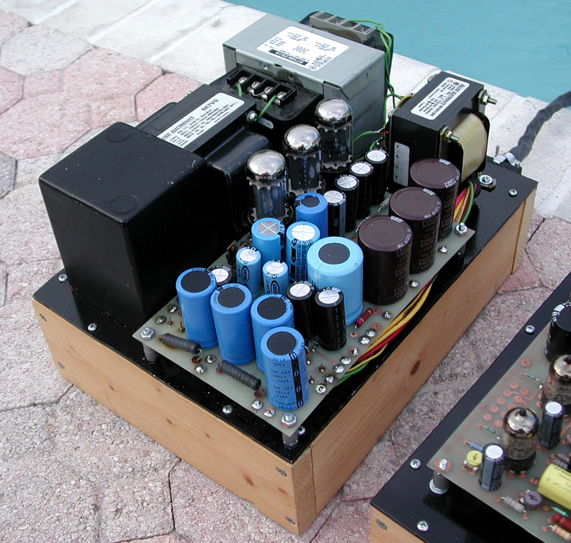

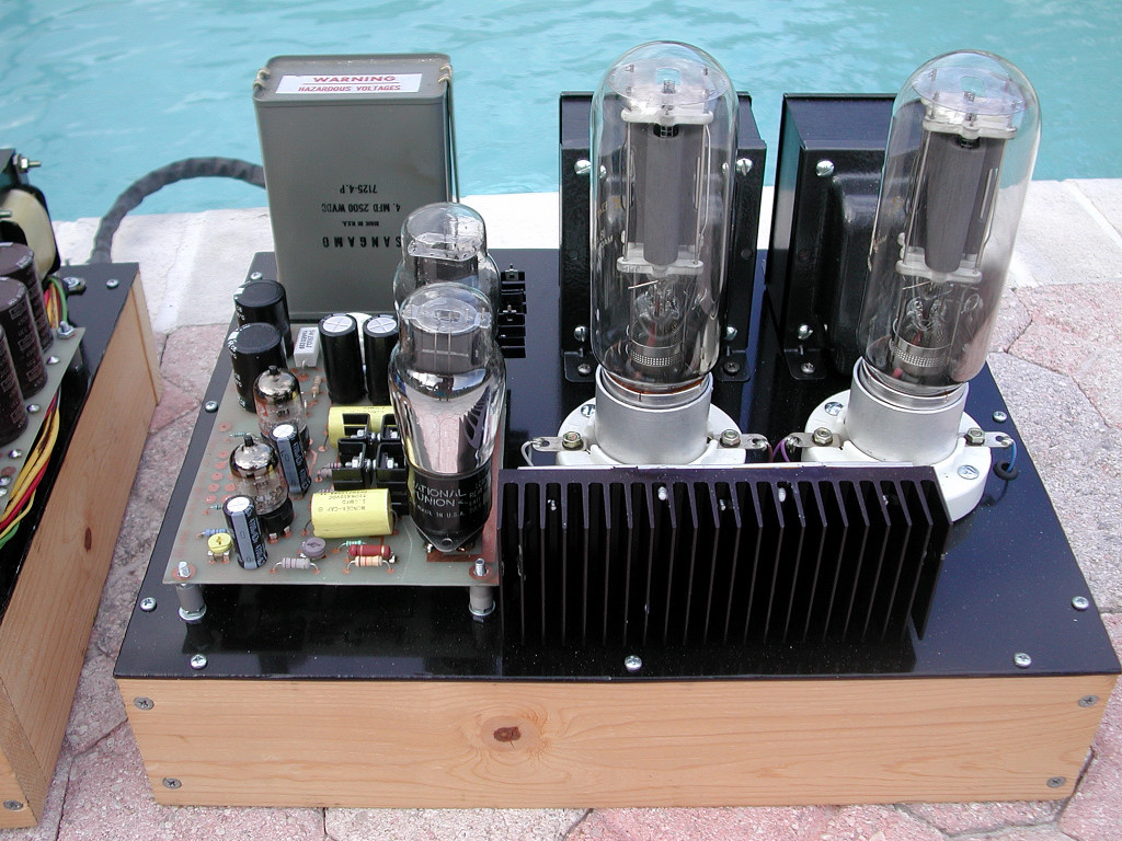

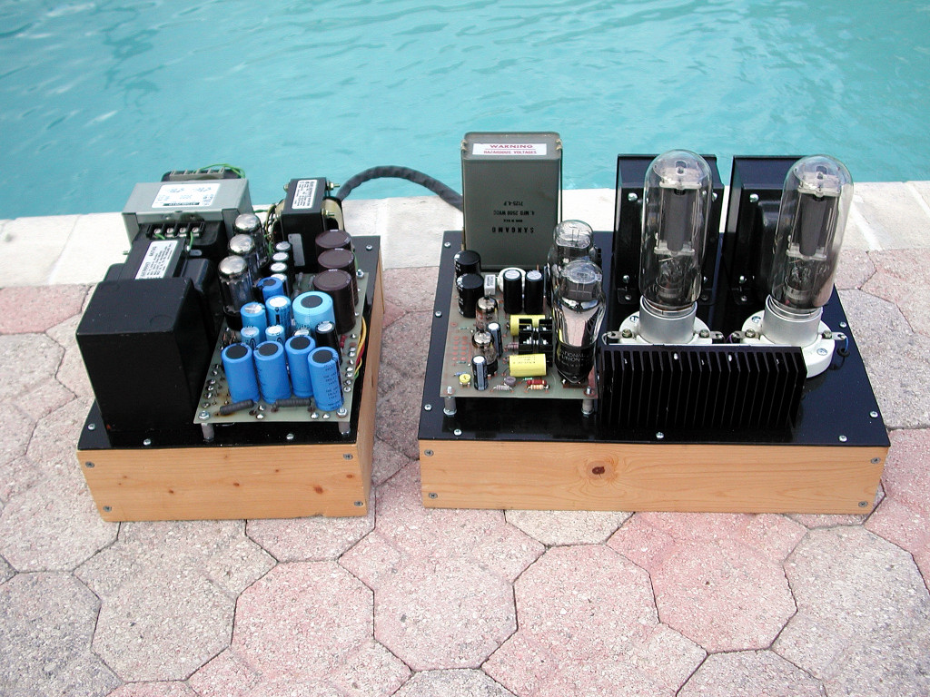

I built an 845 SE amp that used a voltage doubler made with 5AR4's running from a 480 to 120 volt industrial control transformer wired in reverse. It works, but I think that I would use a conventional rectifier circuit if I ever rebuild the amp.
I get a bit over 1150 volts with the output tubes cut off. It drops to 1050 with both channels at 75 mA, and 1000 volts at 100 mA. Silicon rectifiers would probably improve on this.

A SS "full wave" doubler working into a cap. stack, where each part is equal in value to the 1st cap. of of a SS full wave bridge's filter, will produce "identical" results.
Where the doubler can demonstrate an advantage is in the copper loss dept.

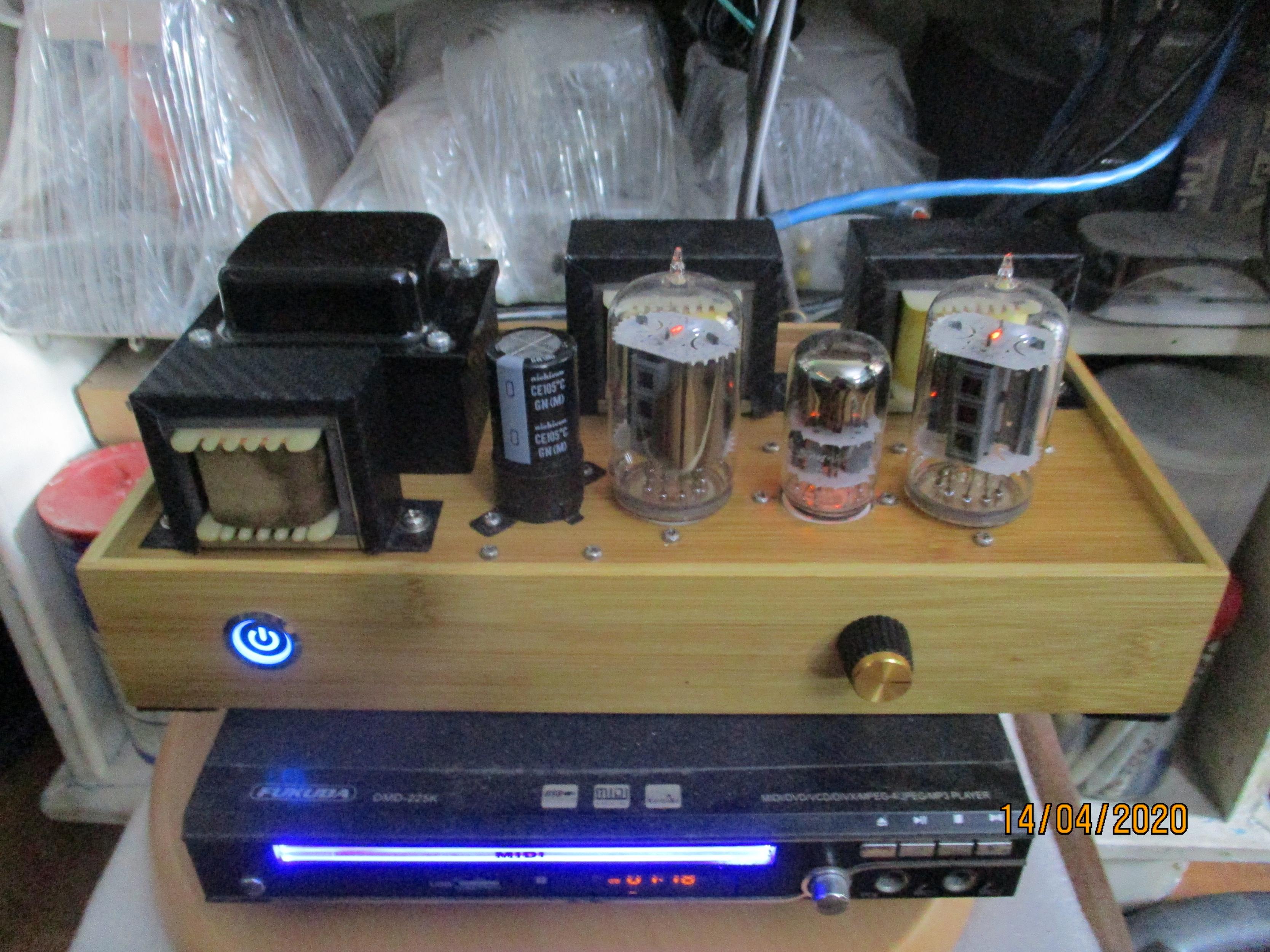

for someone who makes traffos and chokes, the full wave bridge traffo is very easy on interwinding insulation and quicker to wind and is cheaper in the long run...
thicker wires are easier to make and costs cheaper than very thin wires for traffos...
another big plus, is when running TV tubes with lower G2 voltages, you can tap the midpoint of the caps for half the voltage, then you need not use big and lossy power resistors to drop the voltage to say 150 vdc..
this is what i did to my recent all pentode single ended amp, 12gt5 and 6bn11 supplied about 150 vdc using a CCS depletion mosfets shunted by two 75volt zeners...
btw, all irons used in this amp was done by me...
