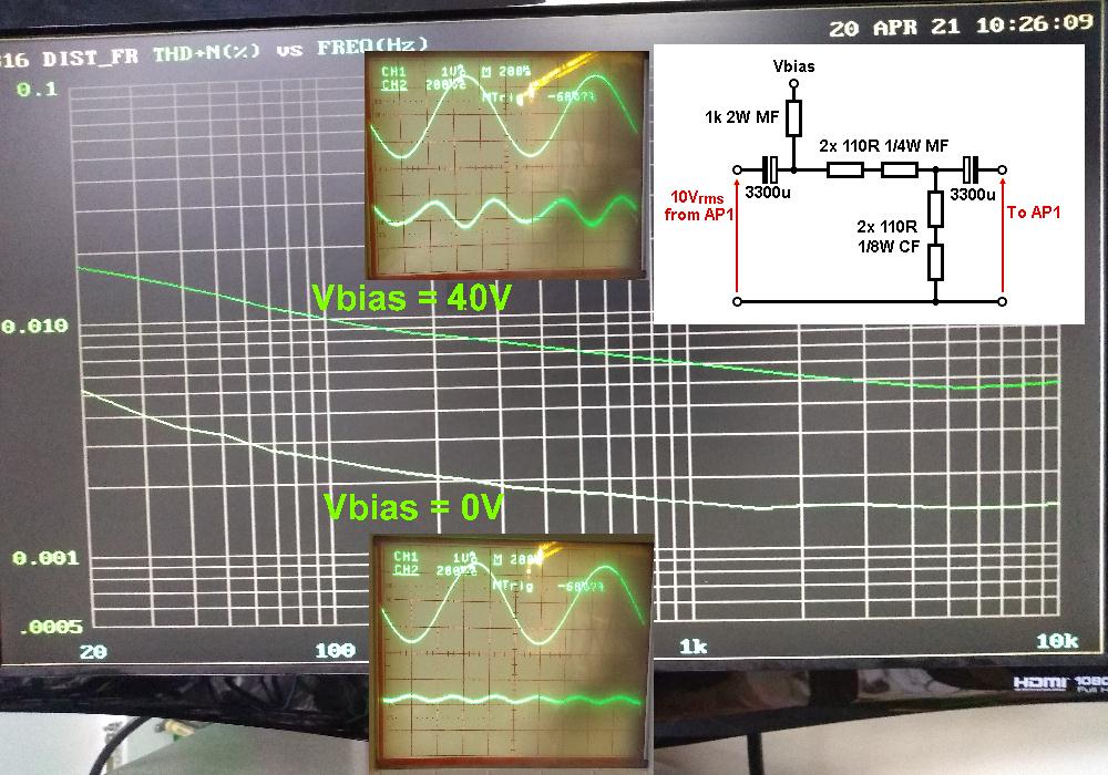

A quick ghetto test using what I had on hand. The two 1/8W carbon film (CF) resistors are the ones producing distortion in this setup, which rises at lower frequencies.
With no bias current they're both dissipating 50mW. The oscillogram shows the signal (1kHz) and the distortion residual, which is clean 3rd harmonic.
Cranking the bias voltage up to 40V results in 90mW dissipation in each of them. The overall distortion rises and is now dominated by 2H.
