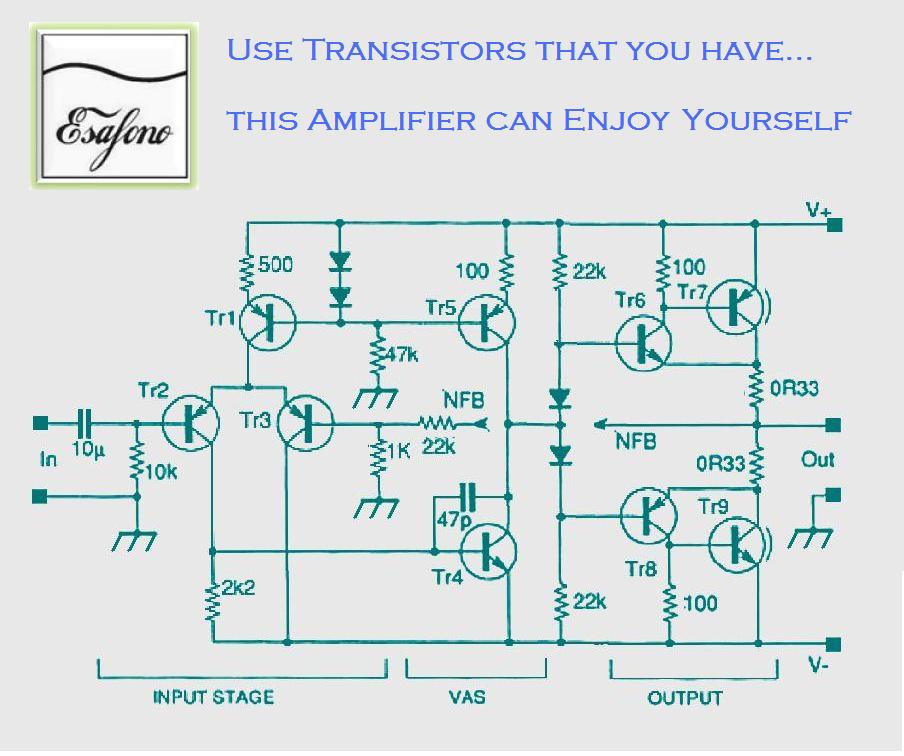

Voltage Differential Amplification
Bias adjust
this output stage can govern alone fixed biasing
and NFB can govern alone DC offset
need a big dissipator:smash:
please measure DC output on power resistor before connect loudspeaker
be careful :
--> this circuit do NOT have protection in RF / DC / Thermal <--
