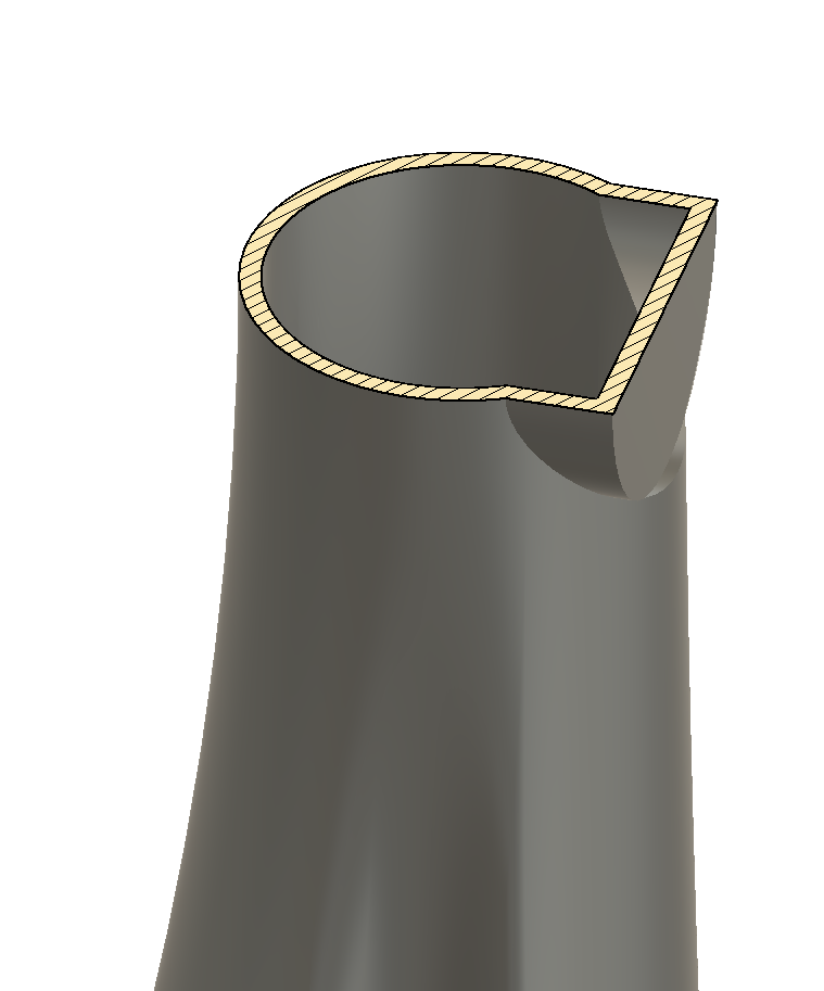

Your original design is basically fine as is with bottom vent, just may need to shift the driver location, so figure at what floor height you want it and adjust taper to suit; no need to fold it unless wanting a horn tuned to a low Fs.
Re edit: ?? so will just say that yes, there will be some comb filtering between the driver's, vent's outputs that can be critically damped at the expense of reduced vent output.

This is only concept massing atm. The speaker mount facing is show sectioned here...so Im saying normally the back plane of the enclosure would be planar/reflective whereas in this case there are no planar surfaces so there should be no chance of retransmission through driver cone or freq nodes/nulls?

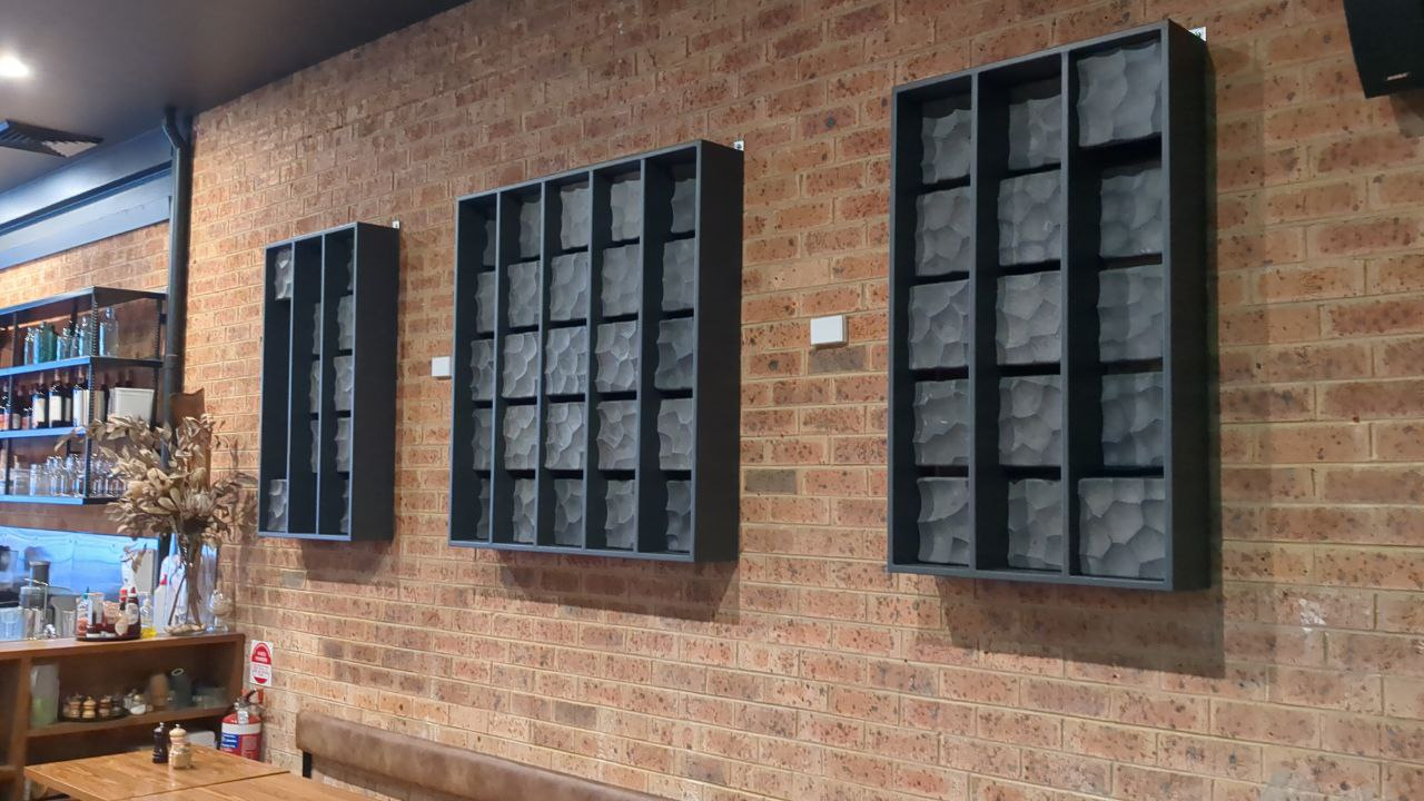

AURASPHERE..."The Art Of Sound"...that kind of thing.
I do hybrid QRD/Helmholz studio acoustics...although this was at a friends cafe...but a deaf lady with a cochlea implant could actually hear properly on a saturday morning breakfast whereas she couldnt before. This is tuned to 600hz but because of the surface scattering and some other stuff means you can sit almost on top of it without resonance
Acoustics of listening space is of course part of the speaker system

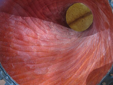

Relating to laminar flow and velocity optimisation; in the voigt pipe application relying efficiency and speed of flow, why are the internal facings not variegated/dimpled to assist in reducing drag since the air is moving quite fast ie thing golf ball/hulls of racing yachts?
It may seem negligible but its effects can be easily heard in master made Djembes in mali, which as far as fluid dynamics go, have helix dimpling sculpted in by hand and create the best sounding of all...which we employ on our synthetic djembes, its also stops the annoying over bearance of head ring...like this

As I recall, the bass fundamental of a djembe lies in roughly the 65Hz - 75Hz region, but being an instrument of equal / more relevance are its tone regions about 2 - 3 octaves higher up, which is significantly higher than you'd want any LF back-load playing or group delay & directionality would become major issues. It's certainly higher than almost any VP would be playing. Absolutely no harm in doing so of course, but the value is unlikely to be particularly high relative to the fundamentals of the design: alignment, inc. Vb, length / expansion & mass-loading as appropriate, driver & terminus offsets, and damping. Do those well & the rest largely falls into the window-dressing category. Which doesn't make it any the less fun to play with of course. 😉It may seem negligible but its effects can be easily heard in master made Djembes in mali, which as far as fluid dynamics go, have helix dimpling sculpted in by hand and create the best sounding of all...which we employ on our synthetic djembes, its also stops the annoying over bearance of head ring...like this

Yep pretty close. I tune 14" to tie in with E and at 432hz reference (either B@40hz or E@61) depending on context.As I recall, the bass fundamental of a djembe lies in roughly the 65Hz - 75Hz region

Is it possible/advisable to replace the round exhaust with a rectangular bottom exhaust ?Ye gods, that was quick. 😉
Nice work, Dave! 🙂
Possible, yes, if you're willing to sacrifice some performance. So advisible -not so much. But it depends where your priorities lie -performance or aesthetics / philosophy or something else. That's not a reflection either way -we all pick & choose which compromises best suit our own requirements.
Believe it or not, it's also my day job these days. You want the honest view? Acoustic relevance for LF applications is roughly nil. But as I say, that doesn't make it any the less fun to play with. I've included (functional) vortex generators in some designs before now for e.g. Audible? Yes -just. Would I do so again? Probably not -there are better ways of working.I watch a lot of Hexibase; great vids and the outcomes are always well detailed, I guess because its his day job. There has been a lot of mention of laminar flow efficiencies in the subs project...so Im mostly going off that...Im always a noob...as there is just so much to know hehe
I realise I would have to mod the VP formulas but is there any issue you could see using a rounded cone type shape vs the rectilinear?
No 'formulas' that I know of beyond the same laws of physics we all work within; a 'rounded cone' shape however really is a cone, whereas a rectilinear (assuming there is a pair of parallel sides) actually has parabolic expansion, although since as noted they're both standing wave generators the practical relevance is about zero in most cases, and particularly when Vb swamps Vas. Which is a bit boring, but unfortunately (fortunately?) is the reality. So the short answer is 'no -no issue' because assuming you're not working with an extreme case, there's no practical difference & if a cone is your goal, you'll be fine.
A slightly different scenario since with subs you're dealing with a much more demanding set of contions as far as pressures & air movement is concerned. A wideband based VP has much less in the way of LF volume velocity etc. to handle. Its own challenges, yes, but outright volume displacement and turbulance, no.Im thinking much more in terms of turbulence, noise etc The kinetic energy of the airflow has often been problematic esp when I was first doing subs so I guess that has stayed with me.
Despite what Scott suggests it is possible— maybe --but requires some trickery. The Terminus will probably have more R and depending on sizing, might not be of sufficient cross-section.
Or at least i think so. Been having thot eperiments with a similar issue. I could see if i can work it out if you would like.
x
dave
performance wins.Possible, yes, if you're willing to sacrifice some performance. So advisible -not so much. But it depends where your priorities lie -performance or aesthetics / philosophy or something else. That's not a reflection either way -we all pick & choose which compromises best suit our own requirements.
Indeed, with the pioneers concluding that the average ratio limit relative to circular area is ~1:1.273.Despite what Scott suggests it is possible— maybe --but requires some trickery. The Terminus will probably have more R and depending on sizing, might not be of sufficient cross-section.
Right, but while we can convert to a recilinear easily enough, he mentioned down-firing; since I designed that pipe with an offset vent to help reduce some of the upper harmonics, it'd need a fairly large increase in ducting CSA to get the length necessary to maintain the offset internally without changes in the alignment. Since we don't know the floor condition & how much elevation is wanted to step it off either the ground or a plinth, I'd say 'not advisible' (on current information). Might be able to if we know those of course.
