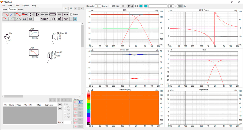

Here is quick GIF demo attached, ideal drivers with ideal 4th order LR xo at 2kHz. Shifting acoustic center of the tweeter just some 3cm towards the listener cause phase misalignment which creates wide droop ~above xo.
My droop was wider than that. I am also still hot between 3 and 6K. Quick fix is just some eq, but I will need to pull the drivers out and make new FRD and ZMA files before I fix it properly. Moving to the DXT tweeter may make it a lot better as the offset is then less than a cm. I have an old Old Colony "Pulser" I can use to get very accurate AC delta measures.

It's said that achieving good phase/time alignment w/2nd order LR filter is difficult, especially on a flat baffle without making a ladder delay circuit. Have you tried this?
Nope but have realized that. On the other hand, I tend away from higher order electricals. 3rd max for passive. A ladder really gets the parts count up there. Kind of a band-aid I think but have not built one to listen. I am leaning to swapping to a DXT so I get closer to acoustic center alignment without new boxes. I was only able to get to about 15 degrees across crossover with an acceptable response. Simulation says I can do better with offset.

Rather than going to these lengths, try adjusting the filters to produce the wanted phase interaction.It's said that achieving good phase/time alignment w/2nd order LR filter is difficult, especially on a flat baffle without making a ladder delay circuit. Have you tried this?
I could not get exact matching through crossover. When it was on, the response was off too much. Now it could be the best solution is to get the phase correct and then add DSP eq. as it is then not fighting phase.

Maybe try adding a woofer 'spacer'/stepped baffle to time align the drivers, or try the DXT tweeter (might even fit without modification to the baffle?), then remeasure and redesign the XO.
