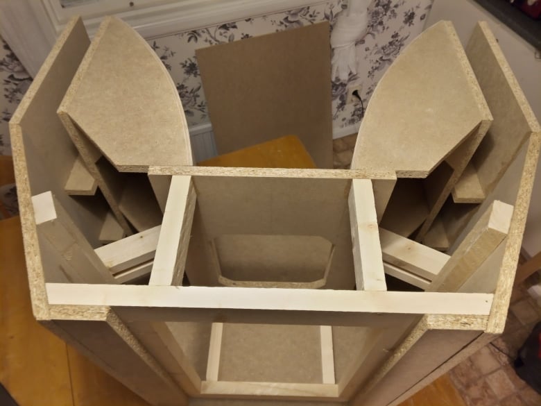

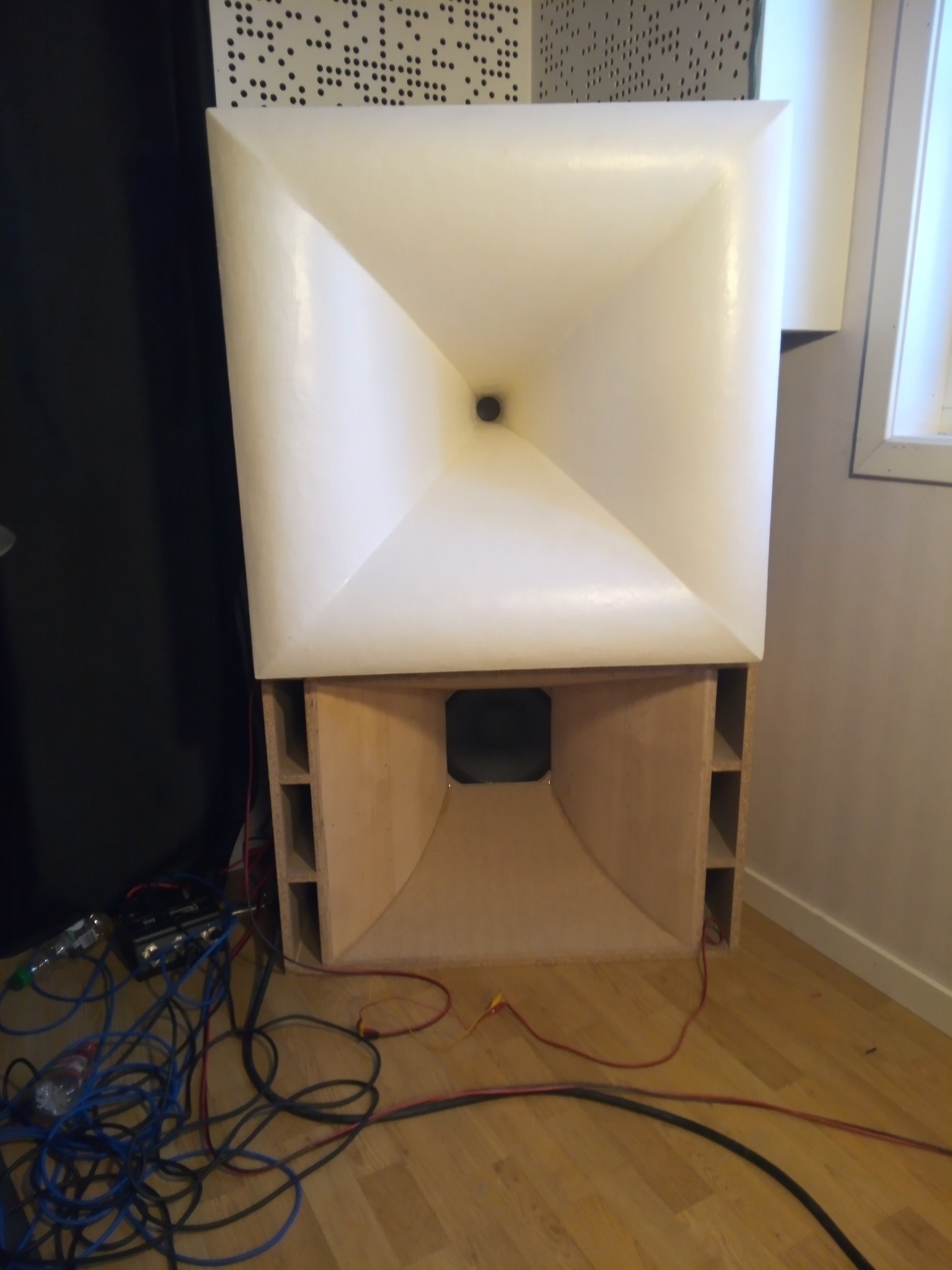

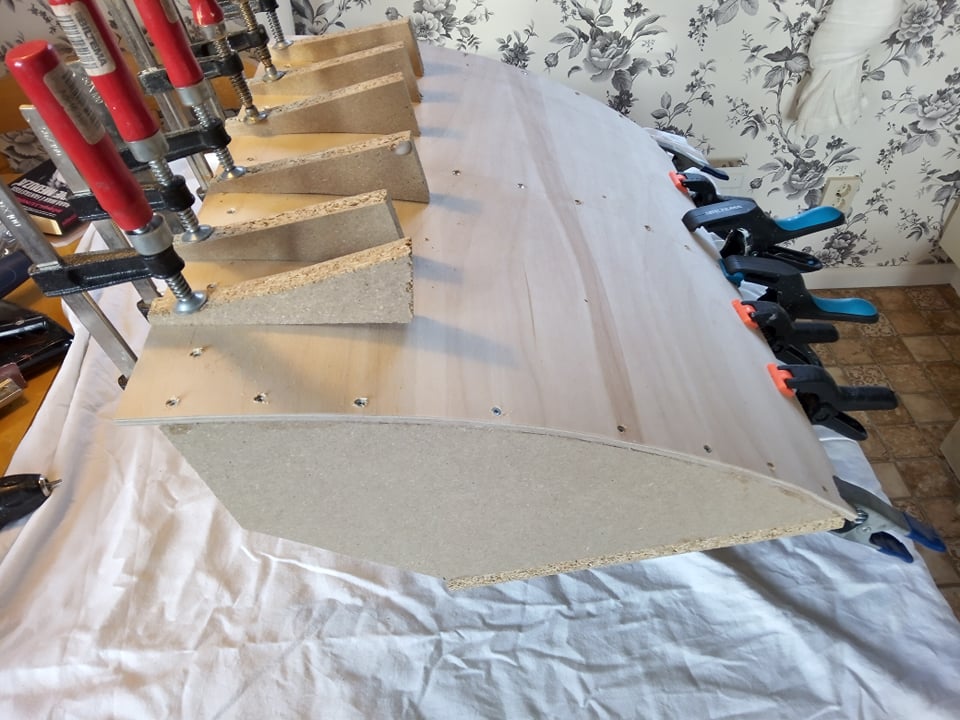

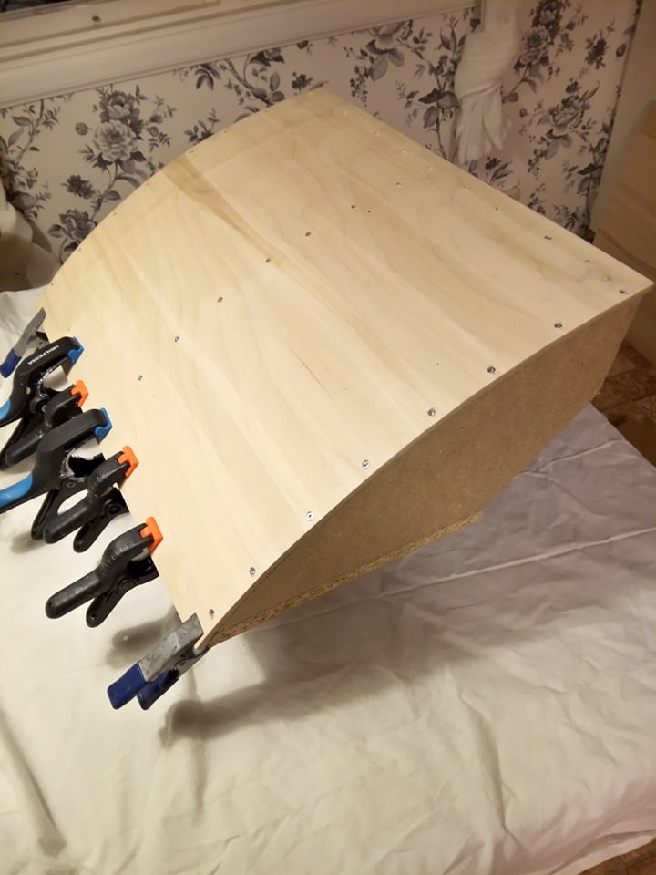

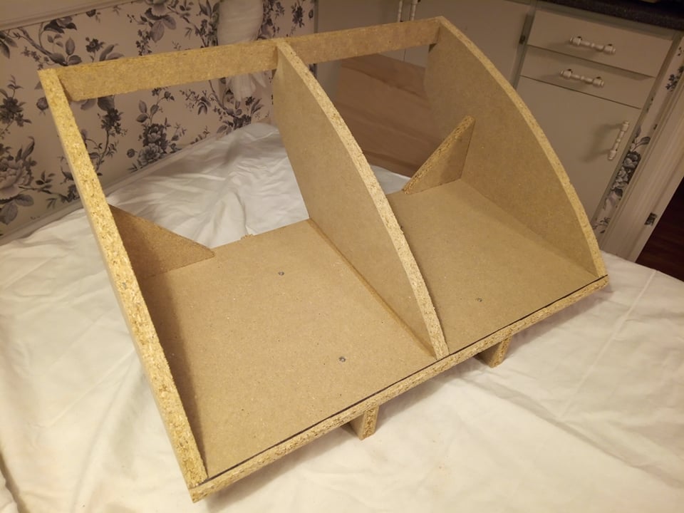

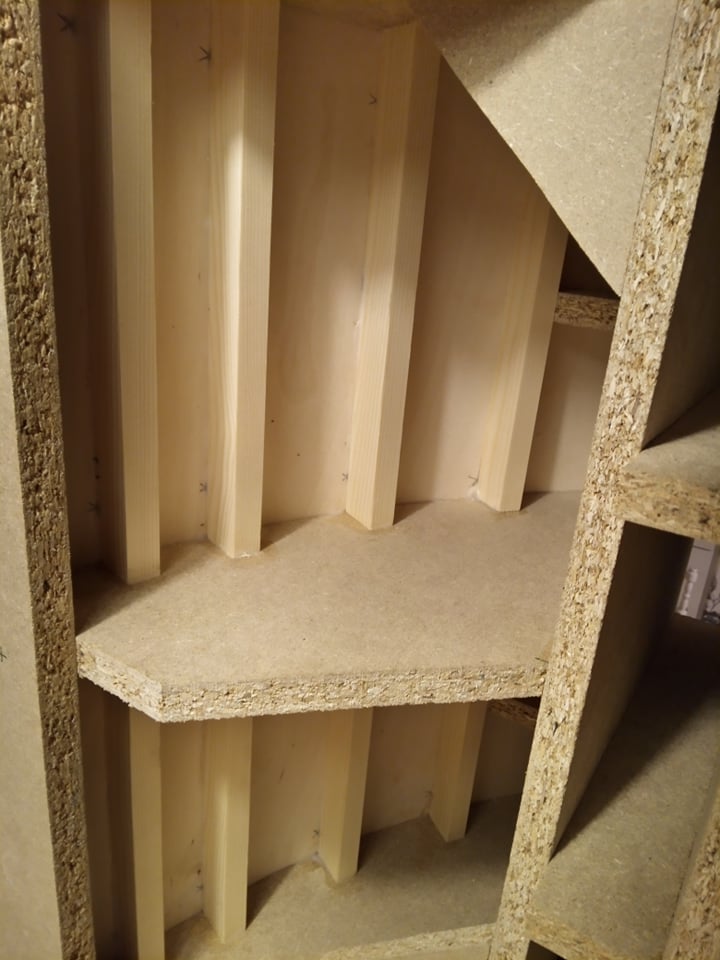

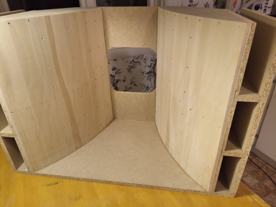

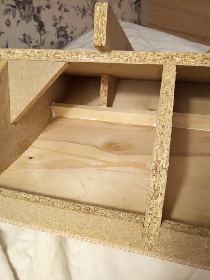

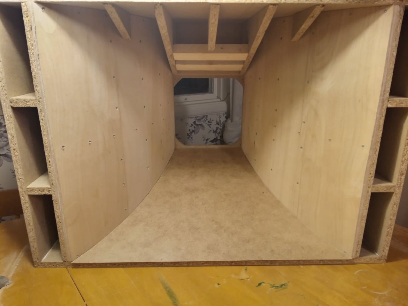

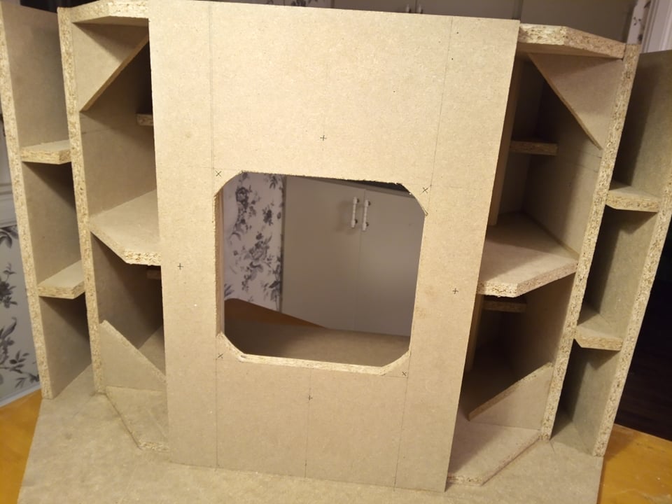

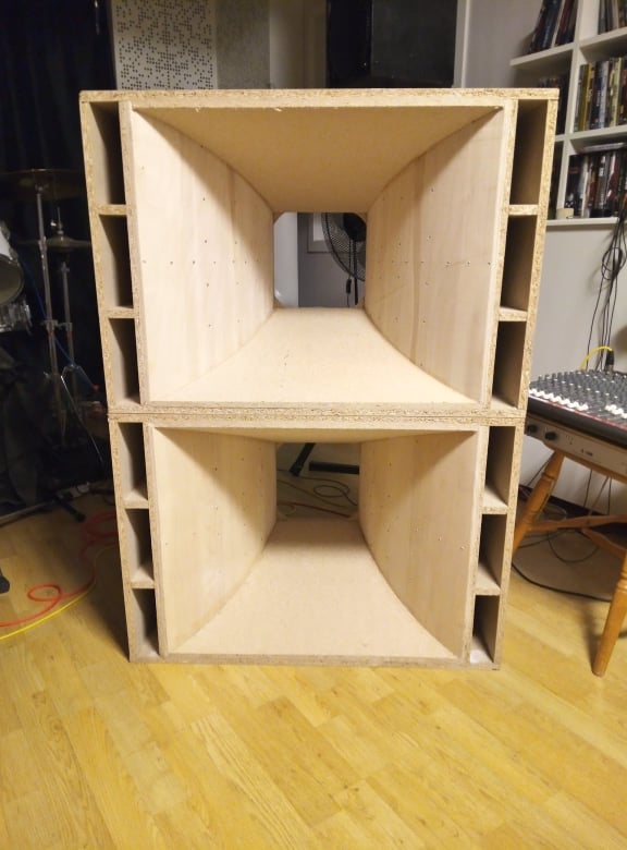

Some pictures of my latest project: a couple of "hornflex" boxes. My own design but obviously very inspired by old Altec cabs from the late 40´s.

Thanks! Most of the job was done with hand tools in my kitchen, 5/8" chipboard is easy to cut and rasp into shape.
They play quite well along with my 200Hz LeCleach horns but there is still work to do on the crossover and cabinet damping.

The first step in any crossover is the cabinets, and these look as though they'll go together. They look good too.there is still work to do on the crossover
So far, the cabinets behave pretty much as expected: prominent mid-/upper bass and a bit shy below 100hz or so. The extra midbass energy allows the basslines to cut through the mix which is interesting for me as a bass player, but it also makes most singers sound like Johnny Cash. A bit unfortunate on male vocals, disastrous on female vocals...
I have a few strategies on how to achieve a better tonal balance before I resort to using line-level EQ:
- Add baffle "wings" like they did on the real Voice of the Theater speakers (and Shearer horns) 70-80 years ago.
- Add more damping inside the cabs.
- Add BSC-filters to supress the upper bass a little bit.
