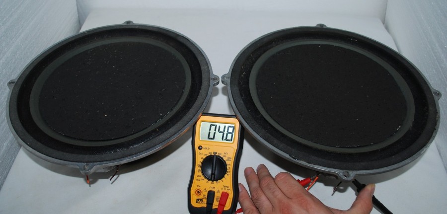

I recently got given a pair of 12" Wharfedale vintage drivers, both with blown voice coils, so I thought I would post pictures of each step in the process of voice coil replacement. I carry out a lot of repairs on speakers, so will make similar threads for different repairs. (If this is in the wrong section feel free to move it to the correct location).

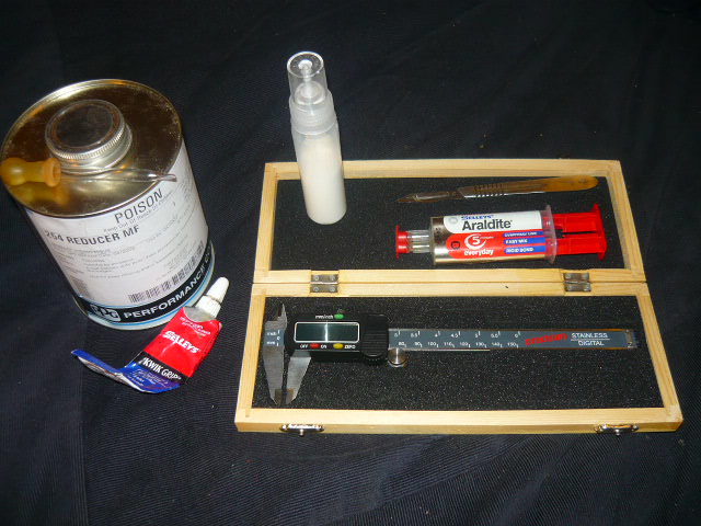

First up are the basic tools you will need: Scalpel, solvent and eyedropper, adhesive and some vernier calipers. I use toluene for the solvent, as it quickly softens most glues (not epoxy though) and doesnt harm most speaker materials. Please note it is not suitable on some types of plastic or foam surrounds, in that case a heated knife is a safer option.
Calipers are essential for accurate measurement of the voice coil dimensions for when you buy your replacement. The important dimensions are former height, winding height, overall thickness, and inside diameter.
The scalpel must be sharp and it is used for slicing through adhesive and separating different components.
I use Araldite for securing the coil to the cone and spider. I use Ados or similar for gluing the spider to the basket, as well as rubber surrounds. For dustcaps and foam surrounds, I use a white PVA based adhesive, which is similar to wood glue but more tacky.

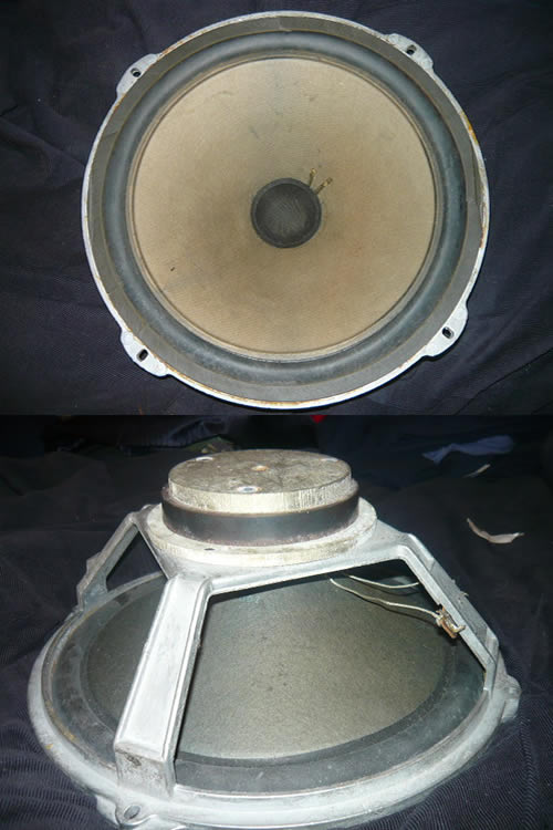

Here is a photo of the driver in question. Has no model numbers, just says "Wharfedale, England". The have a very light cone, thin rubber surround, and an aluminium damping ring attached to the cone beneath the dustcap. This is to add mass, and I imagine to raise the drivers Q. From looking at the driver they would have been in a sealed cabinet.

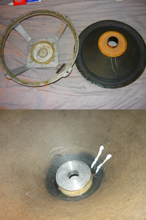

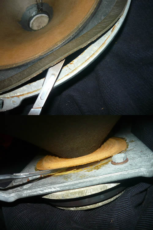

The first step is to remove the speakers software, ie. the cone, surround, and spider. To do this, I apply a small amount of toluene to the edge of the spider where it is glued. And depending on the type of surround, I either apply toluene to that too, or carefully cut the adhesive holding it to the frame with a scalpel using a curved blade. Care must be taken not to slip and slice through the surround or your own hand.
Another option is to use a heated blade, this works better with delicate surrounds such as foam as it slices through the adhesive but doesnt damage the surround if you work quickly and efficiently.
Once the adhesive is softened, you can work the scalpel between it and gently prise it upwards, and you can use the back edge of the blade or a blunt butter knife to help separate the surround or spider from the basket.

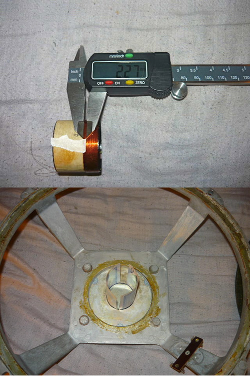

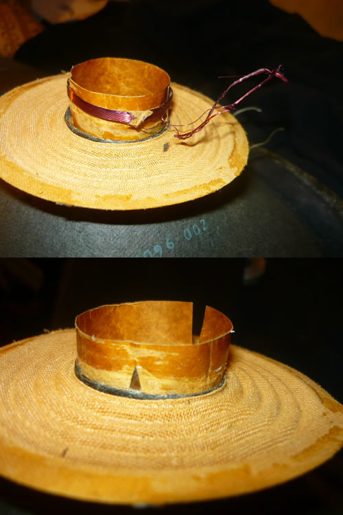

Now it comes time to inspect the voice coil and take the necessary dimensions. What you need to know is the height of the former, the height of the actual windings, the thickness of the windings, and the inside diameter of the coil. If any of these are not correct then the coil may not fit in the gap, or it may rub, or alter your X-max. Sometimes it is possible to deliberately use a different coil, for example if you want a longer X-max then fit a longer coil, but check the depth of the gap first or it may hit the back plate.
As you can see, this coil is well and truly busted. It is only on a paper former, and the adhesive had probably dried and perished over time.
After you have taken your measurements, carefully cut the coil free. I use the sharp straight blade, and go in from the front. In the second pic, note the scalpel blade, carefully work your way around the circumference of the coil. Better to go slowly and not slip and be accurate, than to rush and slice through the cone. The coil should slide out freely and leave a neat and tidy hole.

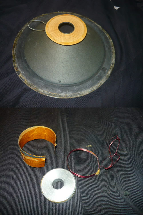

Here is a pic showing all the separated components: The cone/spider, the old faulty coil and its former, and the damping ring.
The damping ring could be omitted if one wanted to customise the driver and experiment, but I will be re-installing it to keep the drivers as close to original spec as possible. In this case I was able to keep the cone attached to the spider which is preferable, but not always possible. Always try to keep the hole as neat as possible and close fitting, as it will aid the centering of the assembly when it comes to re-assembling it.

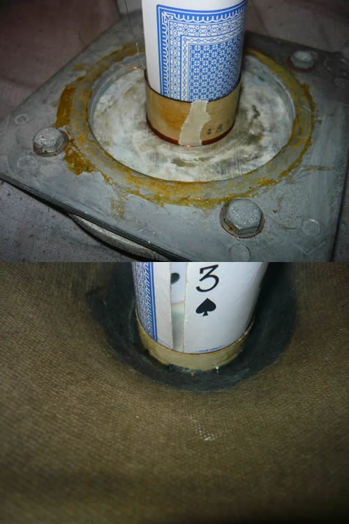

Well the coils have arrived! The replacement coils are on a polyimide former, so these drivers will ow have a higher power rating as the previous coils were made from paper. Now the fun part, re-assembly.
The first thing I do is mark on the coil its correct height. There are various methods to do this, and it i essentially the same process as calculating the drivers X-max (linear excursion, for those that don't already know).
I measure the coil winding height, in this case its 10 mm. Then I measure the thickness of the top plate and subtract that value from the winding height. In this case it is 5 mm, so that leaves 5 mm. Then I divide that by two, to give the amount of winding overhang either side of the top plate, which will be 2.25 mm. I set my calipers as close as possible to 2.25 mm, in the photo it shows 2.27, but 0.02 mm will not make a difference.
I then put a piece of masking tape on the coil to mark where it should sit in the gap.
Next up is to find some shims of suitable thickness that can firmly hold the coil in place, but loose enough not to distort the coil and allow adjustment. On these drivers, I found a pair of cardboard playing cards to do the job nicely.

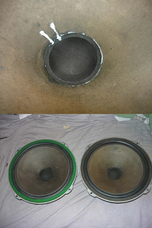

After everthing is glued and soldered, the last step is to re-glue the dustcap. After a successful re-coil, this is like putting the icing on the cake
I just use Ados or PVA depending on the particular speaker.
Once its all dry, I then run a swept sine signal through it to check for any rubbing or buzzes or other problems etc. Both drivers checked out perfect.
After doing all that work and testing it, there is always a sense of self reward when listening to music through the speaker, that a couple of days earlier was in bits and had it's new voice coil arrive in a box from the courier.
Below is a picture of the finished drivers, ready for action. The cones are bit darker since I gave them a light coating, but now have their strength restored, and are not fraying at the surface. One has green felt around the edge, the other has grey foam. I now plan to buy some green felt so that the other driver matches, and then think of something to use them for, but I plan to sell these on to someone who has a use for them.

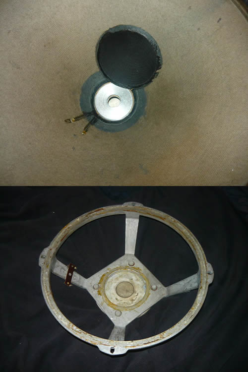

My challenge is to get my cone out, without access to the dust cap. The woofer is from a W90, and has a foam (polystyrene) diaphragm glued into the cone. Pic below.
With the help from your post, I'll give it a try. I'll have to center it without shims, using a tone to the speaker. I guess I've got nothing to lose.
