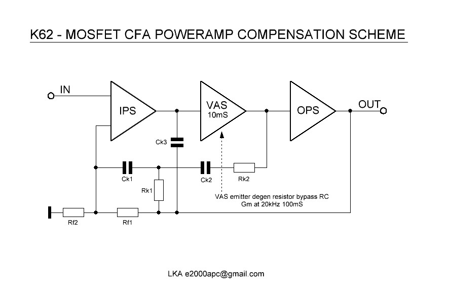

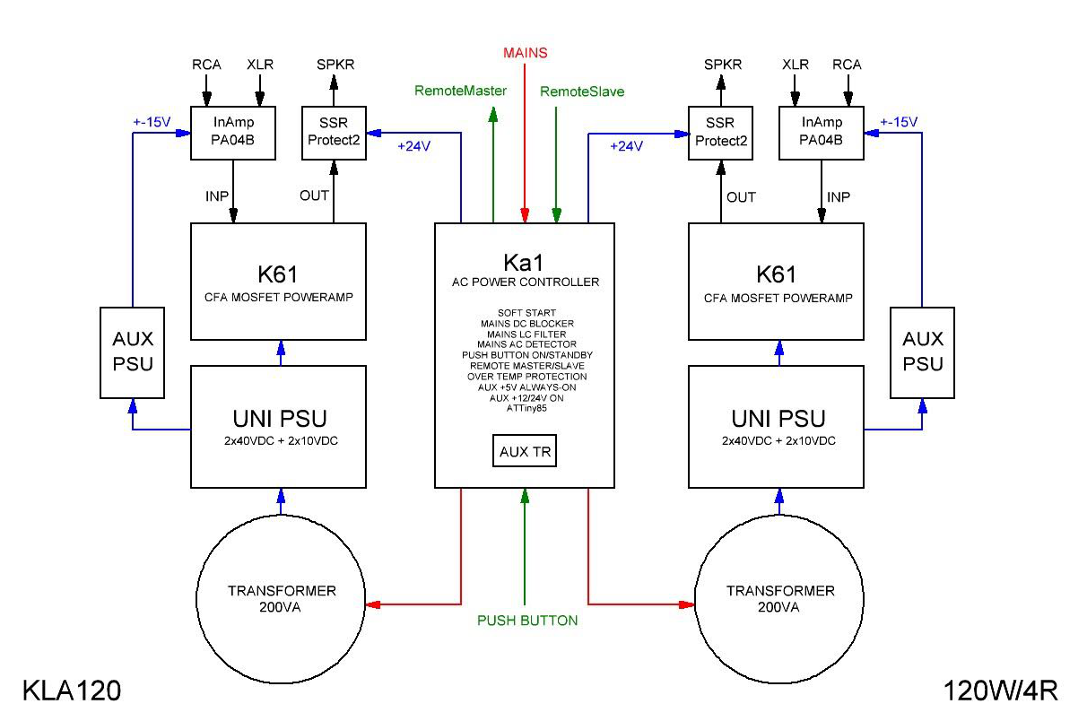

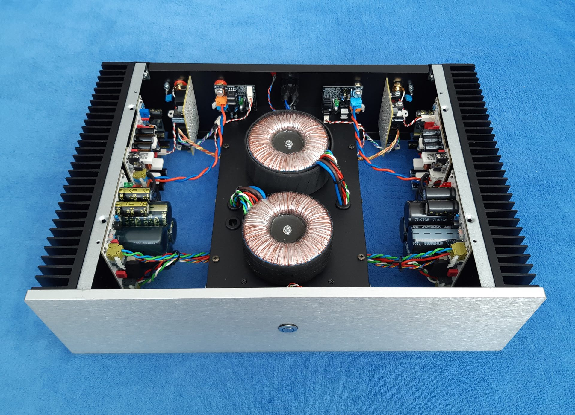

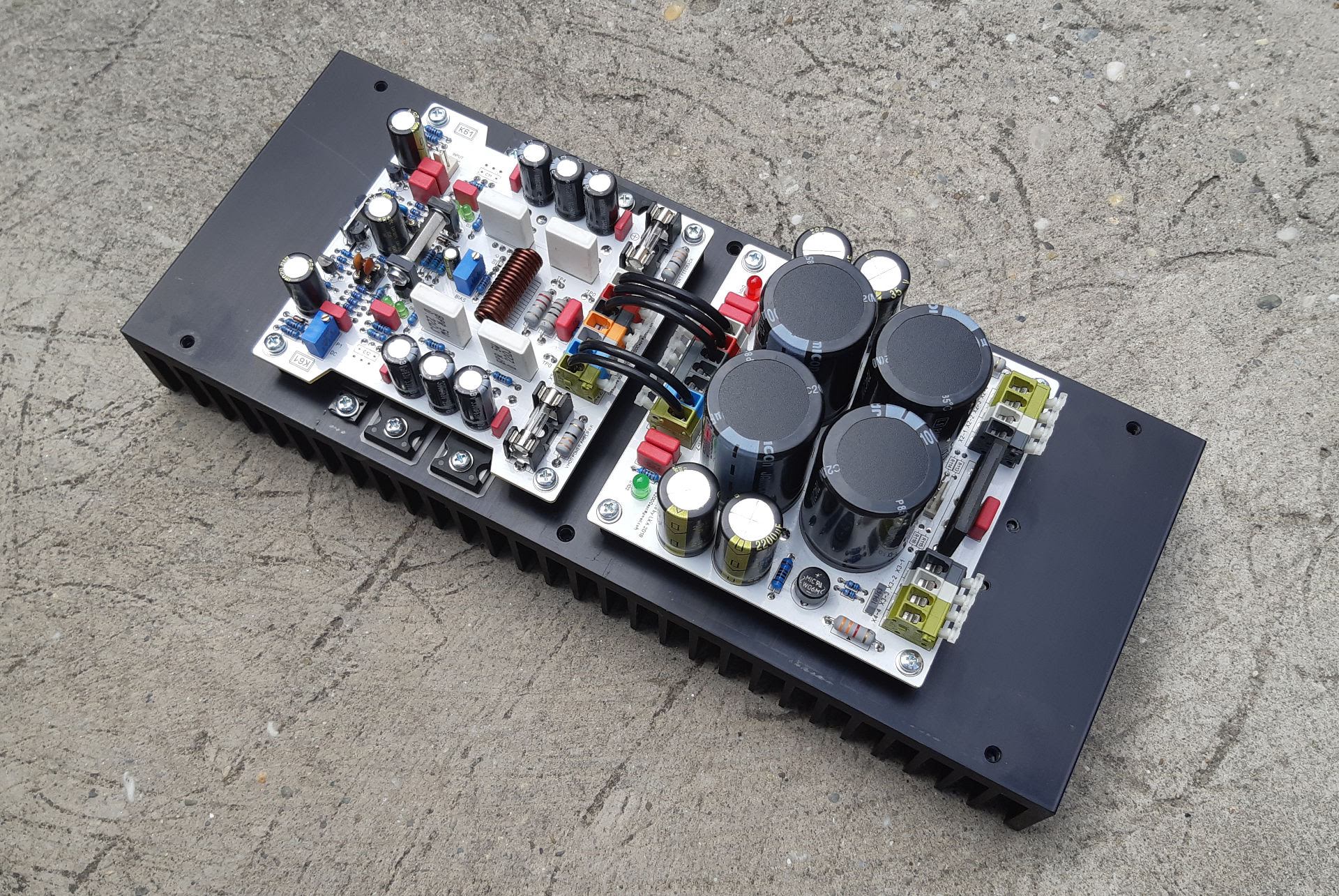

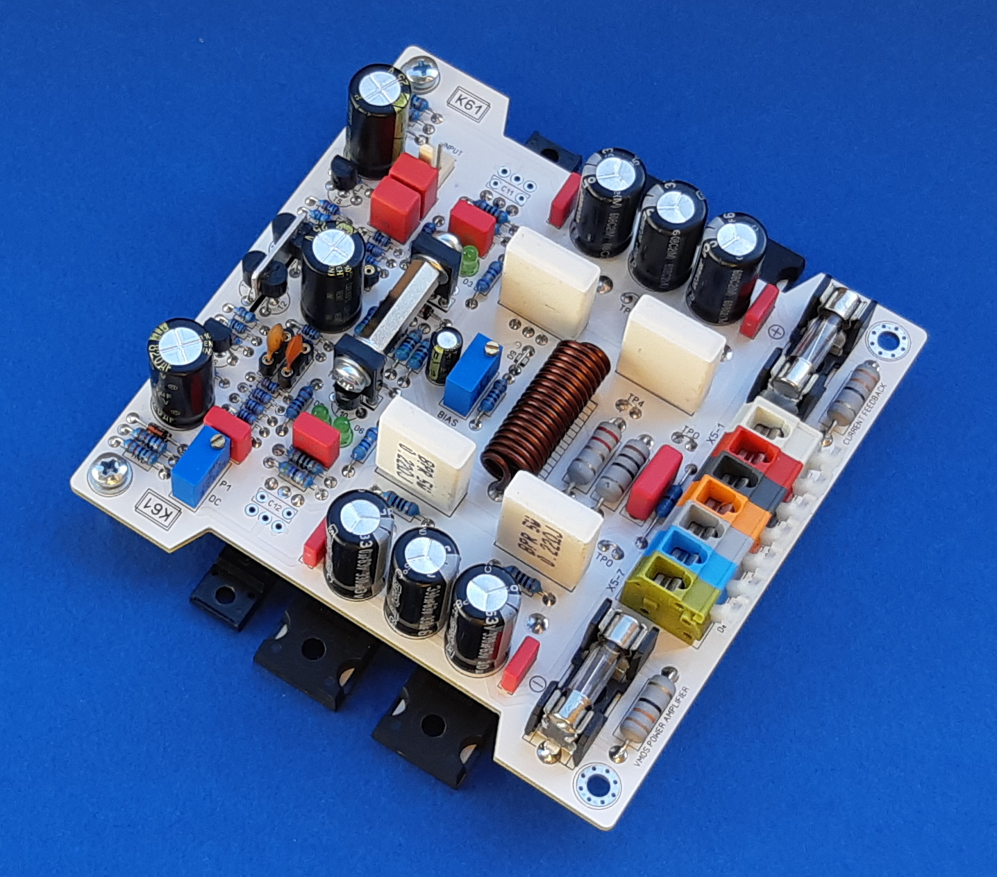

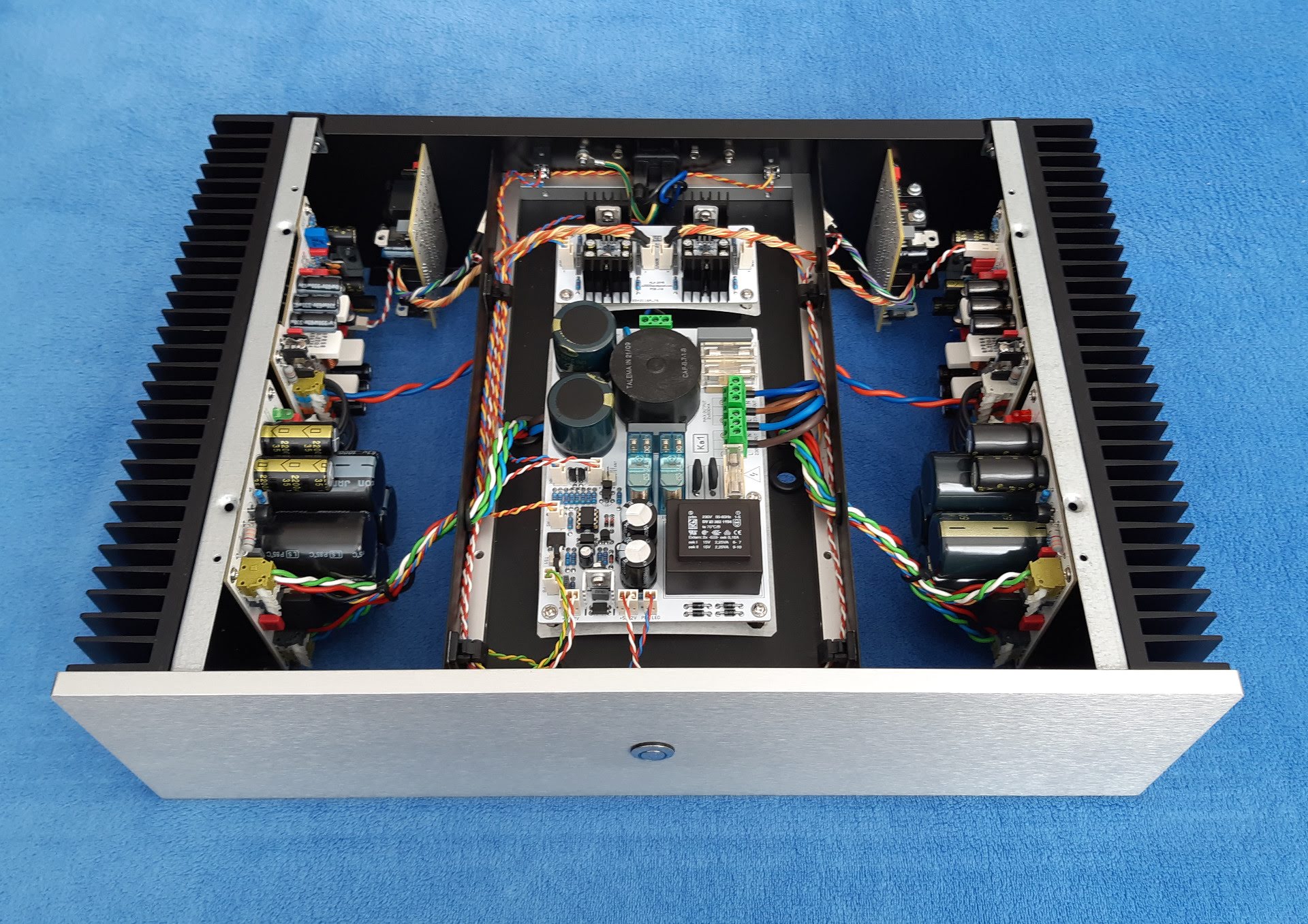

I've recently finished my latest amplifier, the KLA120.
It's extremely clear and transparent, produces amazing sound, I like it very much.
Pic1 - block diagram, components used and interconnects

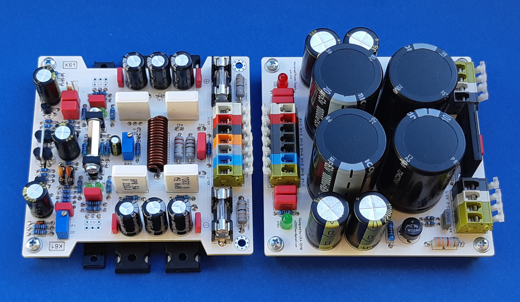

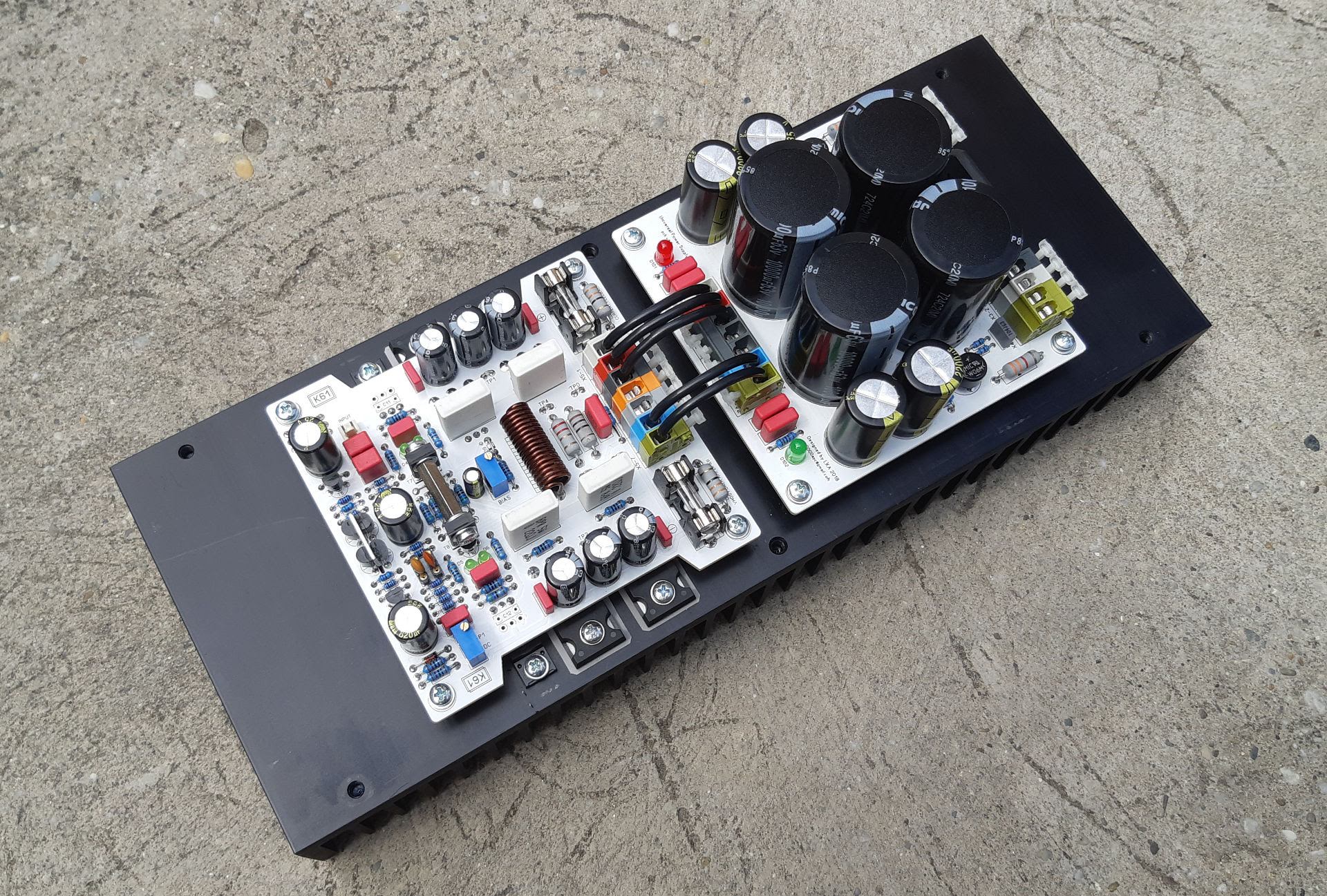

Pic2,3 - finished and uncovered amplifier

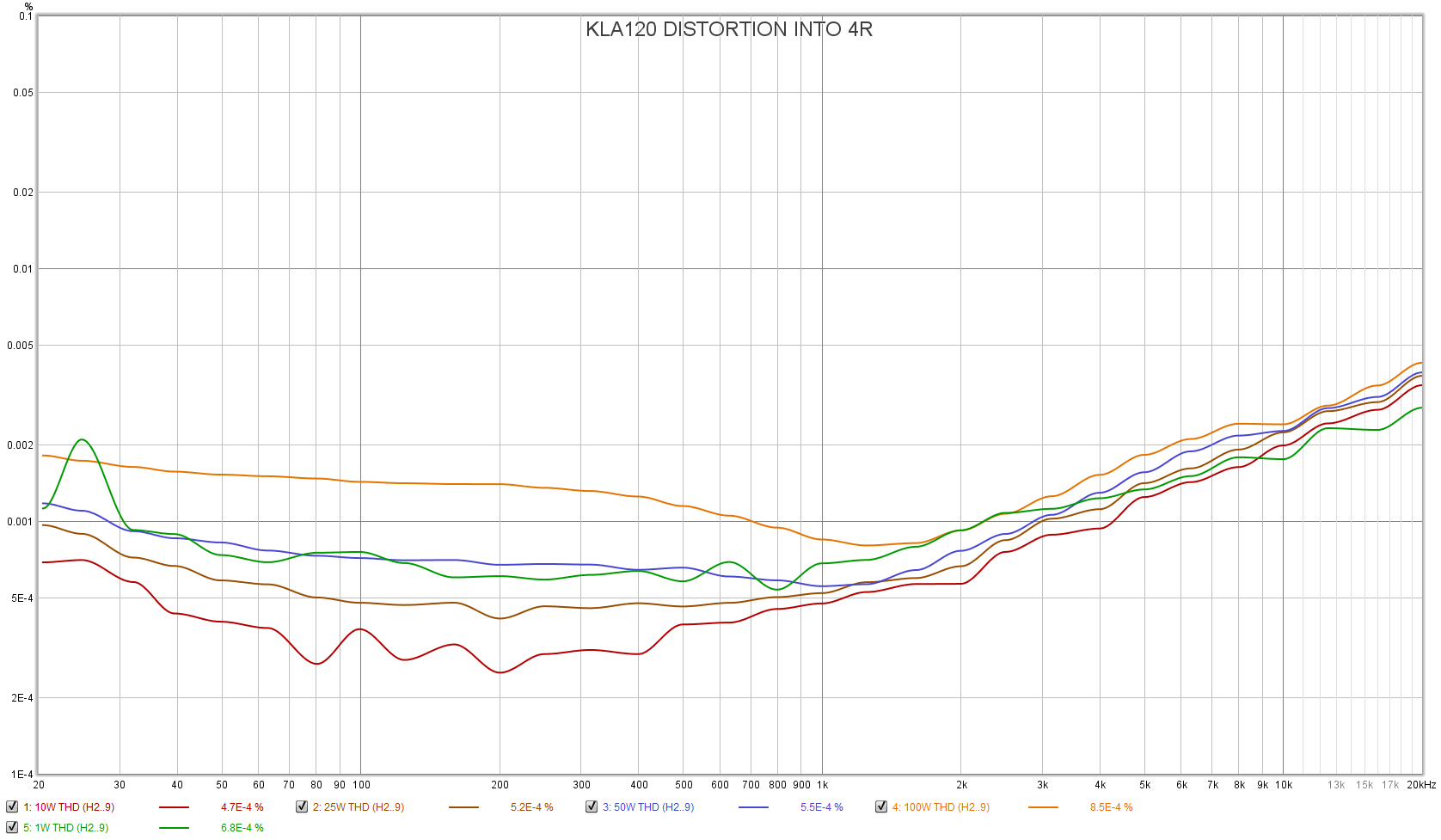

Pic4 - measured distortion vs frequency into load 4R

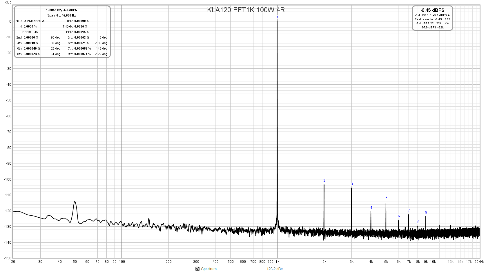

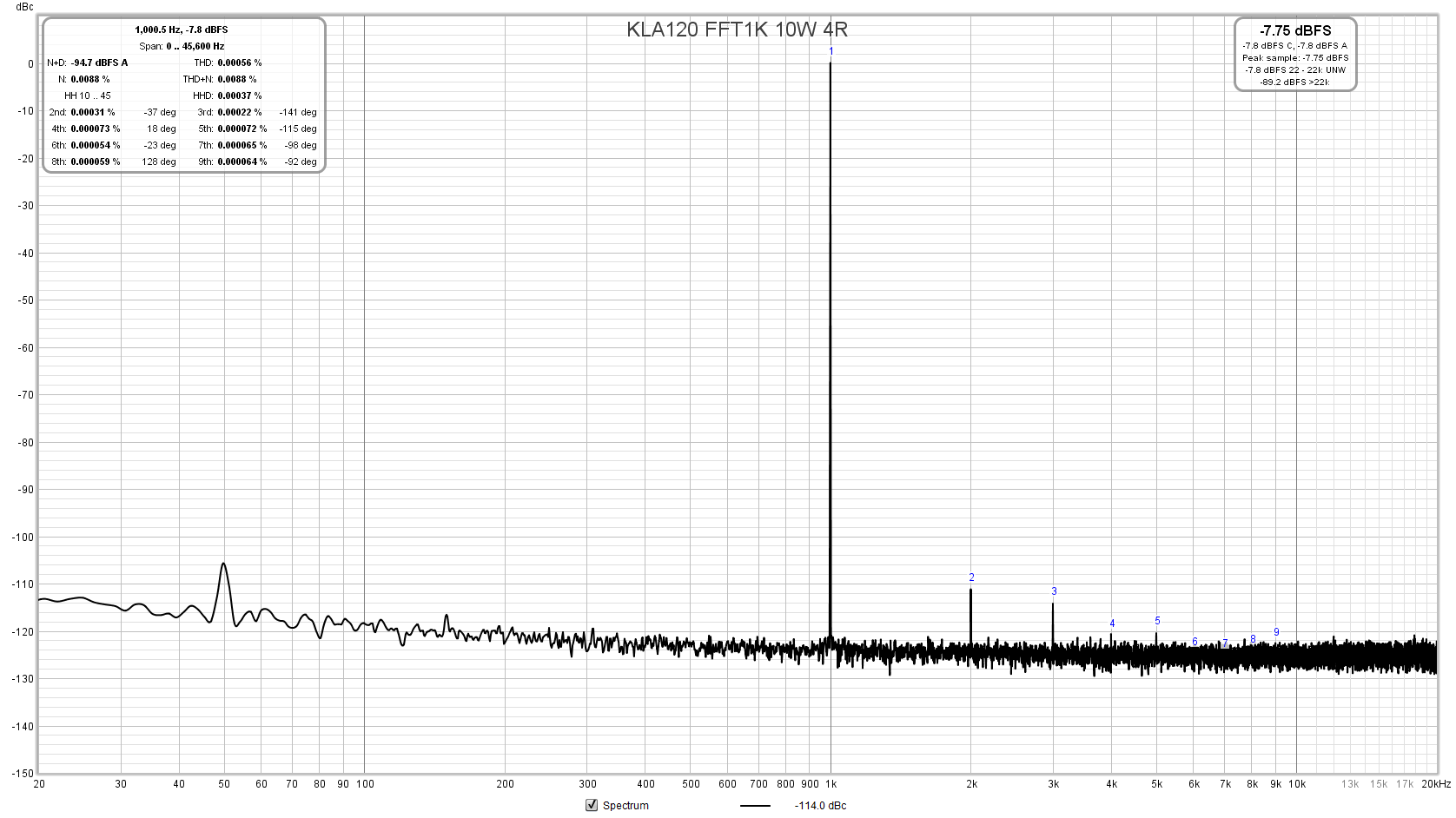

Pic5,6 - RTA at 10W/4R and 100W/4R, notice the exemplarly clear spectrum

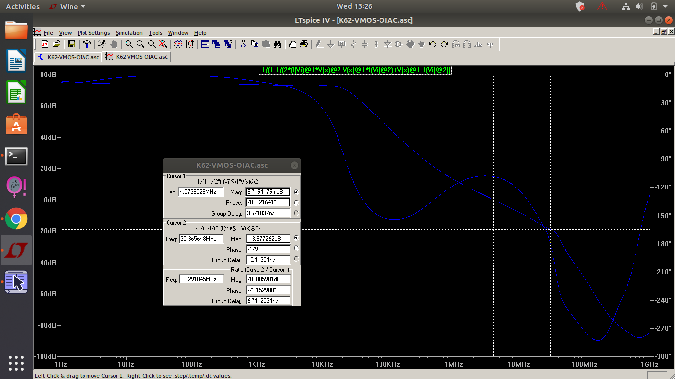

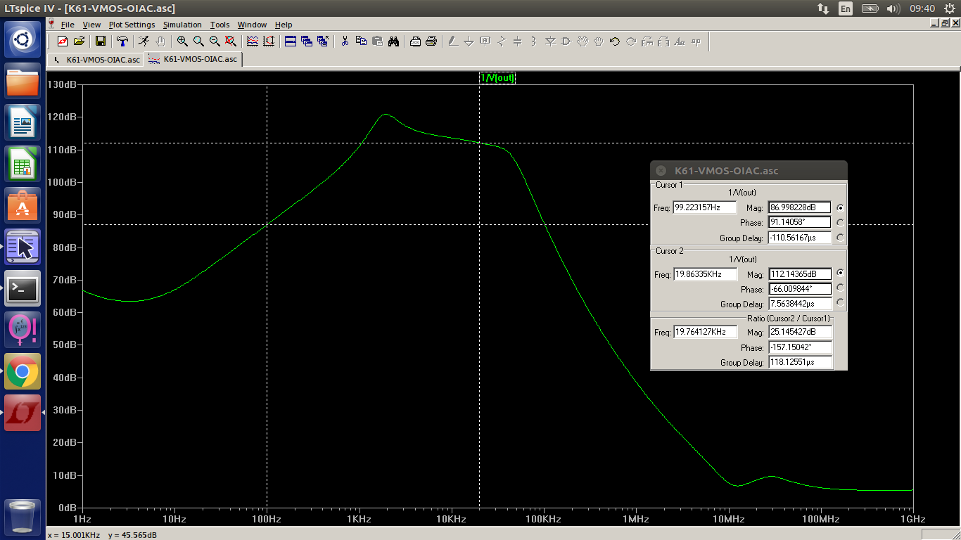

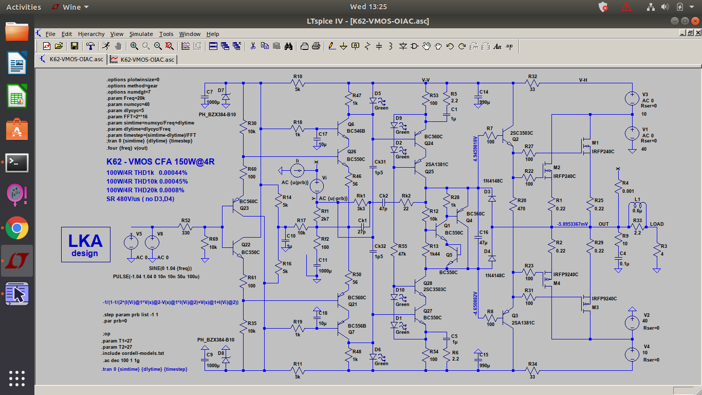

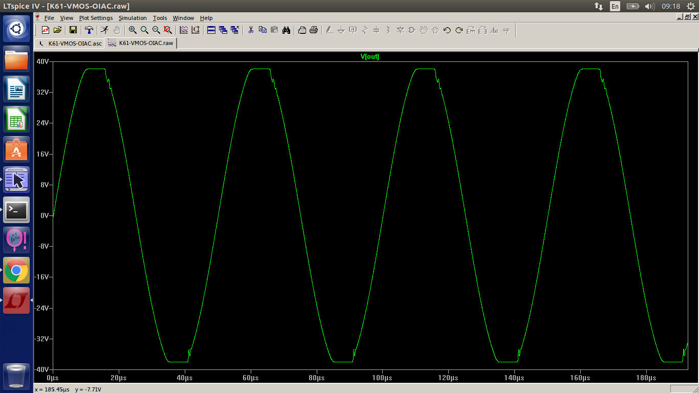

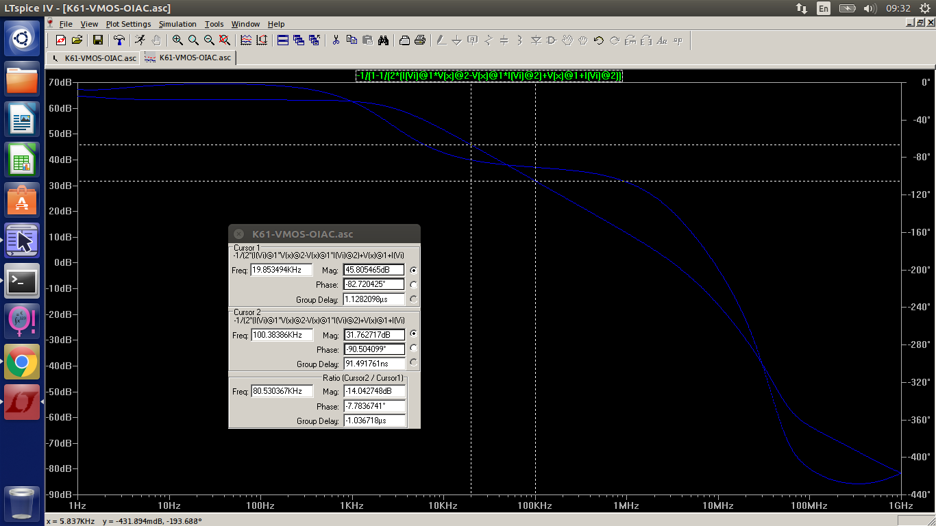

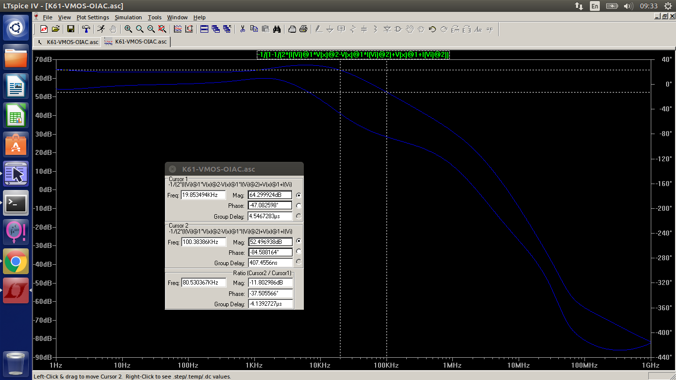

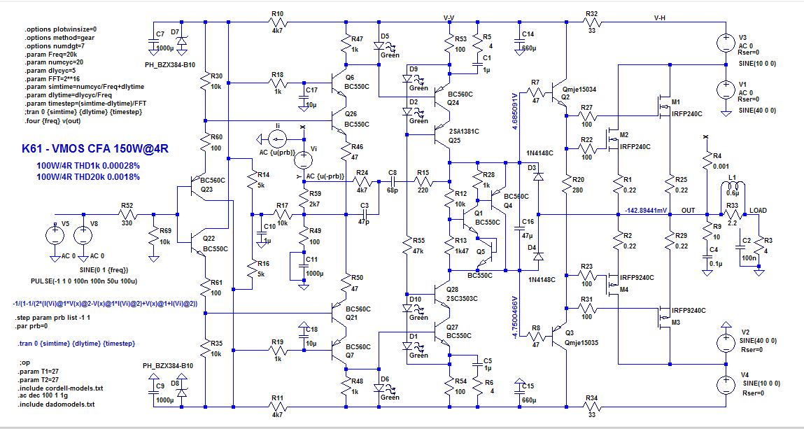

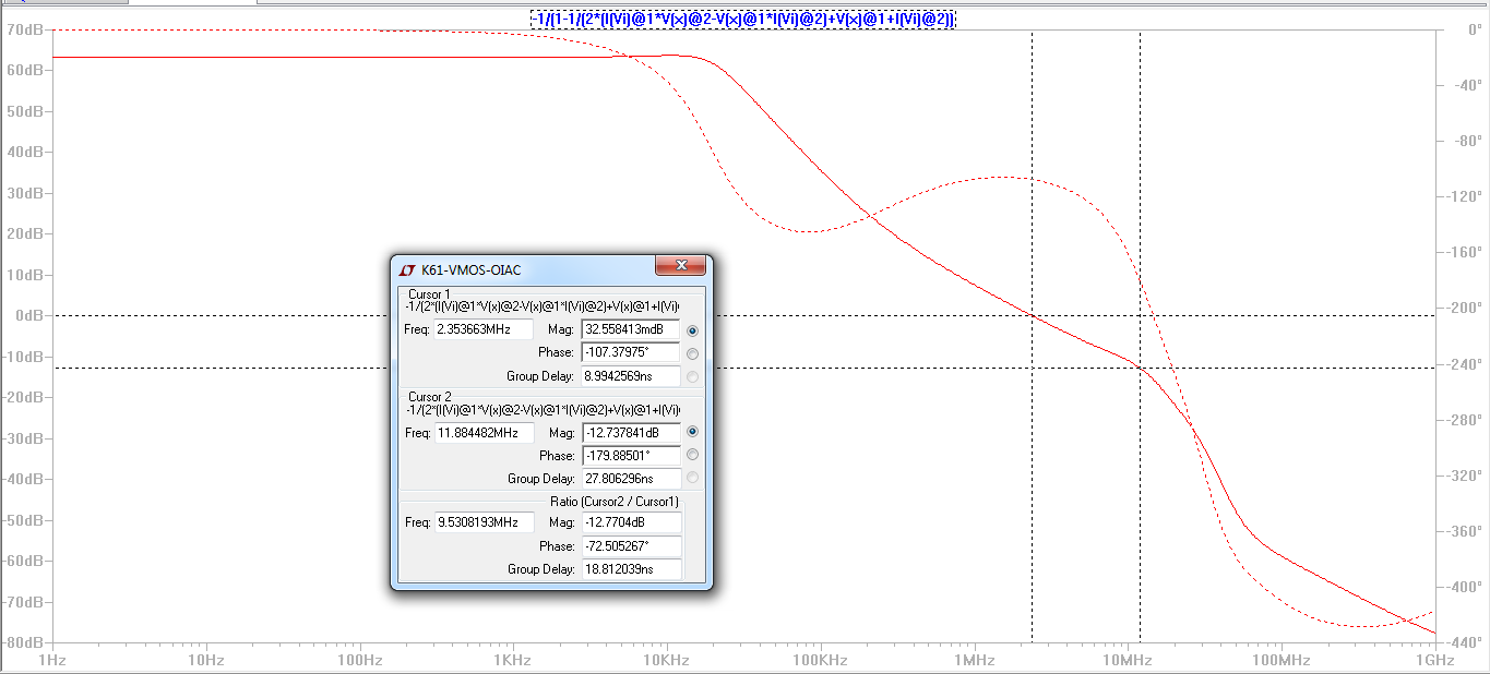

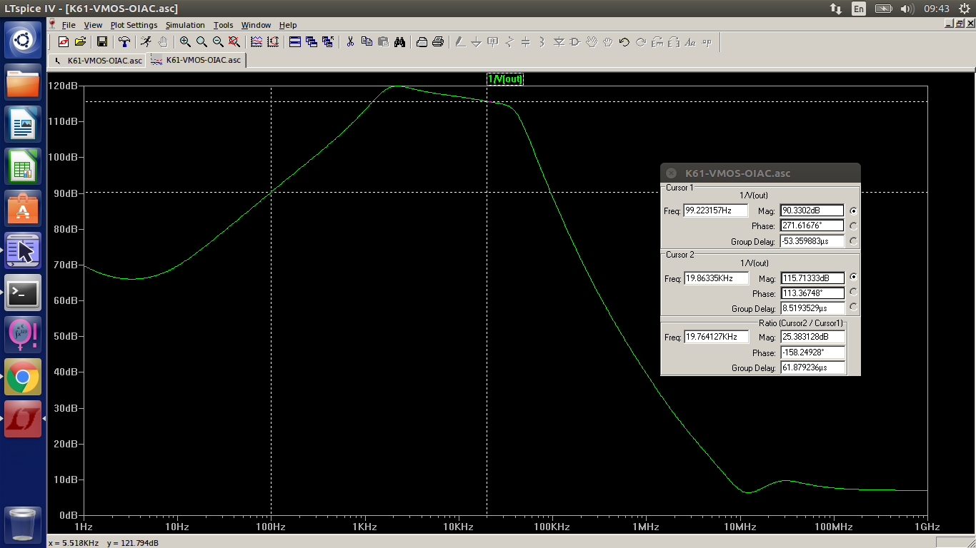

I am a novice. #8 Change the feedback current to double. The current noise is reduced by 22dB
View attachment K61-VMOS-OIAC-dado-1.asc
