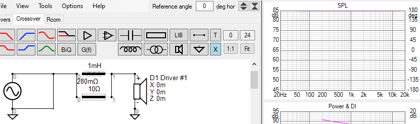

I love this software, and have been playing around trying to design a crossover for some speakers. Good stuff. I do, however, see one bug.
When you add a resistor or inductor from the main input line to ground, it will change the impedance graph but does not change the other four graphs at all. At a high resistor value, it wouldn't change them very much, but at a low value, all of the levels should be decreasing, across the board.

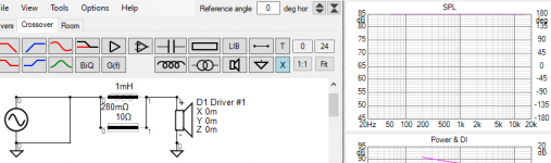

If i put a wire/lead from the input to ground, the graphs all disappear as they should, since the input is shorted out. But if I put a 0.1 Ohm resistor, which is nearly the same thing as a wire, there is zero change to the graphs (except the impedance graph).
^Connecting wire over the generator does not kill voltage source though it does not look realistic. Try to make legal connections and check that node number of generator's upper terminal is not 0.
Source resistance of generator, buffer and other active components is 0.001 Ohms, and resistance of shorted component is 0.00001 Ohms. Those two work more logical than shorting of generator with wire.
This one also works if there's something before driver. Shorted component (Z=0.00001 Ohms) is enough to drop level at driver's terminals. So I wouldn't call this bug.
