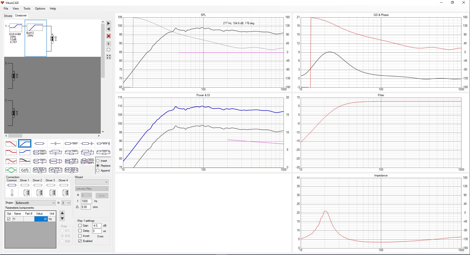

I was wondering, would it be possible to show the -3dB point from the graph?
Obviously this is going to be a relative point, depending on the design and input voltage.
This is especially handy when designing subs.
At this moment we can only see it in statistics, which is also not always completely accurate to the graph (especially not when adding certain types of filters)
Also, when tuning a BR-system, is there a way to keep the tuning frequency consistent when changing the diameter?
Or also in other words, use the tuning frequency as an input variable instead of using the mechanical dimensions?
I often tune the system first before I'm actually bothered about the dimensions of my ports.
Using the dimensions as input variables doesn't seem very intuitive and is a lot of fiddling around sometimes.

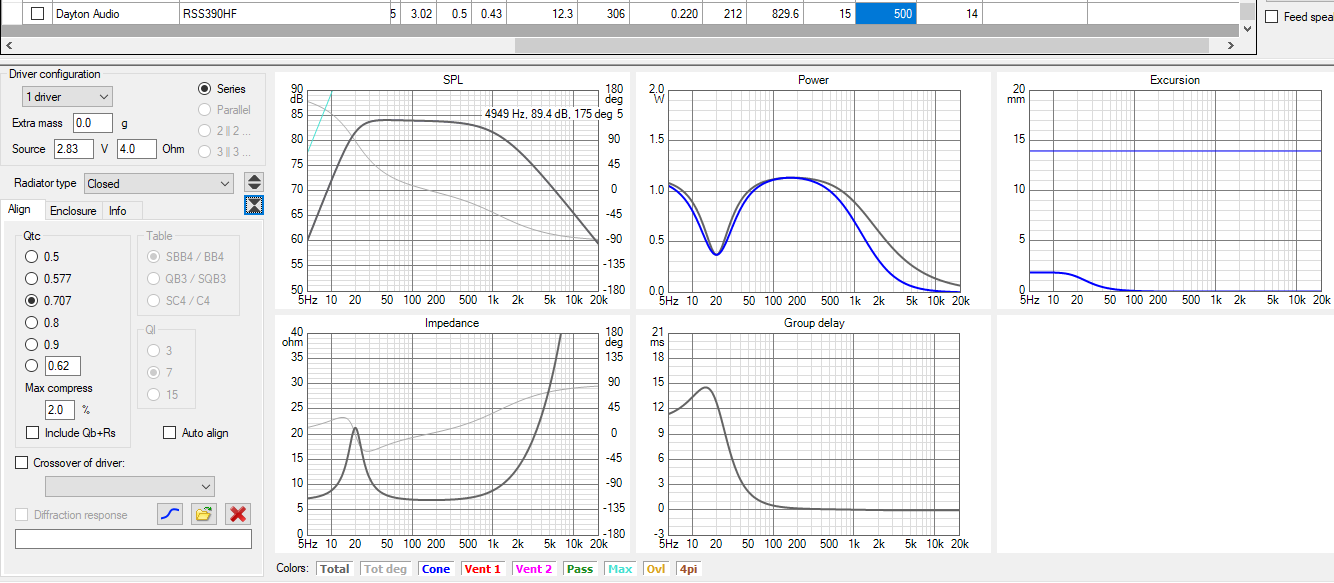

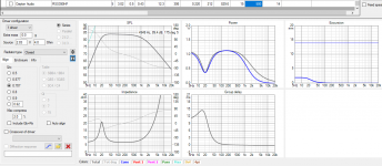

^What is wrong with excursion in your opinion?
It doesn't seem accurate, I modeled it in WinISD and it said I was at 14mm xmax with same size cab with 400w.
I don't see a spot to specify exact watts being used so I'm not sure it'll display excursion properly.
Keep in mind that the WinISD input power should be read as input voltage.
Always look at the same SPL and VA graph.
Ah-I see what you're saying. It didn't click in my brain, I should have known as i adjust voltage in the inuke to change "watts".
Power to Re is quite indirect input signal. It may happen - or not Therefore actual internal input signal is voltage also in WinISD.
New WinISD accepts both Power and Voltage signal so comparison to VituixCAD, LspCAD etc. should be very easy. Result should be equal though I have checked that only with old WinISD version.

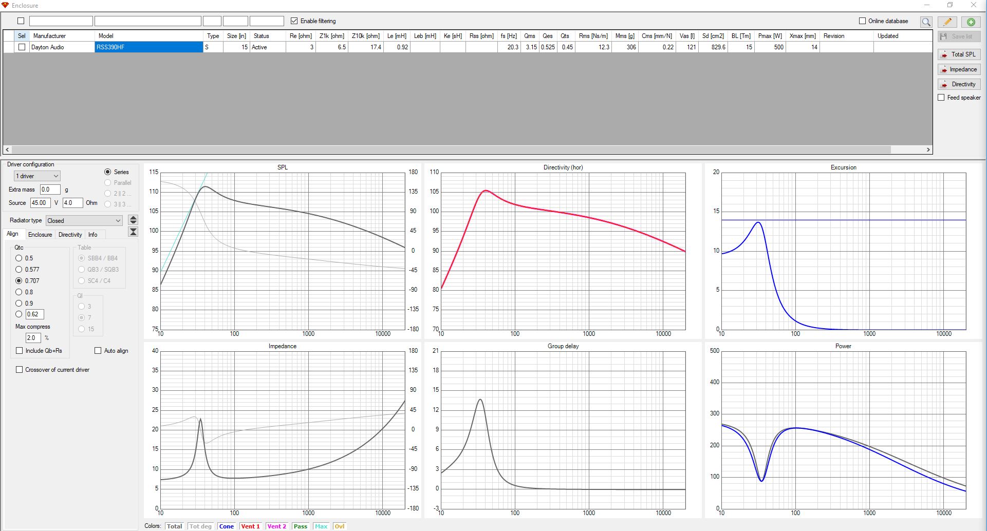

Quick question.
I know I can see the total SPL in the crossover tool, however, as far as I know, one can not add multiple drivers in the enclosure tool, like see individual woofer, midrange and tweeter ????
So I can only work with individual drivers, meaning I need to optimize the woofer and then separately the midrange ?

Okay, thank you for clarifying and thank you for a great software^That's the idea. Enclosure tool is meant for dimensioning one direct radiator at a time (one enclosure, 1...12 drivers). You can take snapshot from woofer and look SPL curve in the same chart while designing mid-range, but that's it.
-3, -6, 10 dB points were okay until link to crossover filter and response effect of lossy inductance were added. Now they are more or less random depending on circumstances. Valid method to define reference frequency is needed, but it's not that simple as automatic.
One trick is to play with input voltage so that reference point is adjusted manually to 100 dB sharp. After that reading of -3...-10 dB points is quite easy, but changing of driver requires new adjustment.
Shouldn't be a problem. This needs some extra control(s) to select which parameters are locked (or changing) while some other parameter is adjusted.

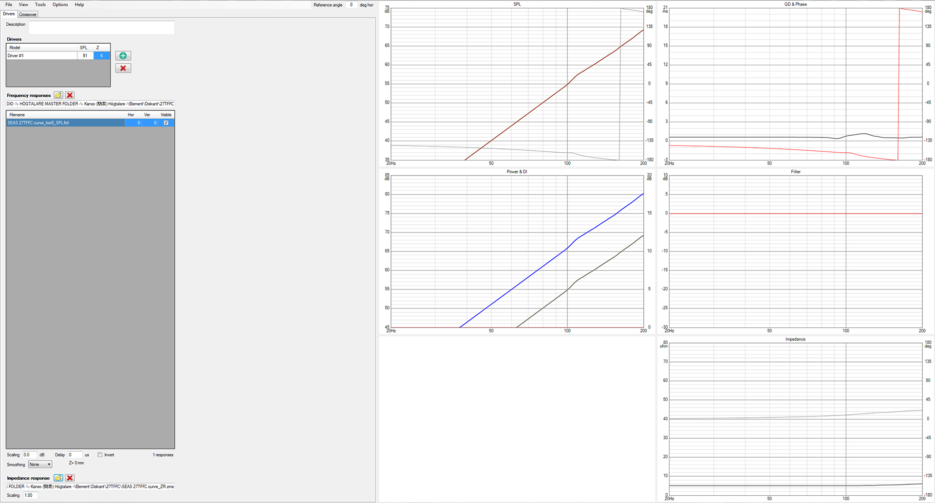

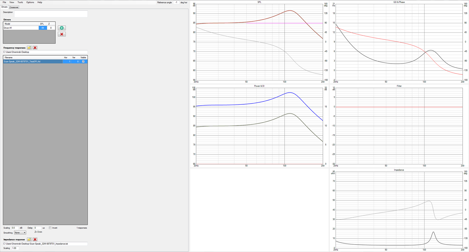

I updated to the latest version today and was just about to start working on a new crossover.... and well, its kinda f***. Not sure what happened between the v 2.0.13.7 and 2.0.13.8 but the crossover tool is not working and I have not changed any other settings on the software. I have included two pictures to show what I see. The scanspeak FRD and ZMF som from the software while the SEAS is my own capture which has always worked in the past.
Can I role back a version ??? please help
- EDIT - seams to work now... odd
