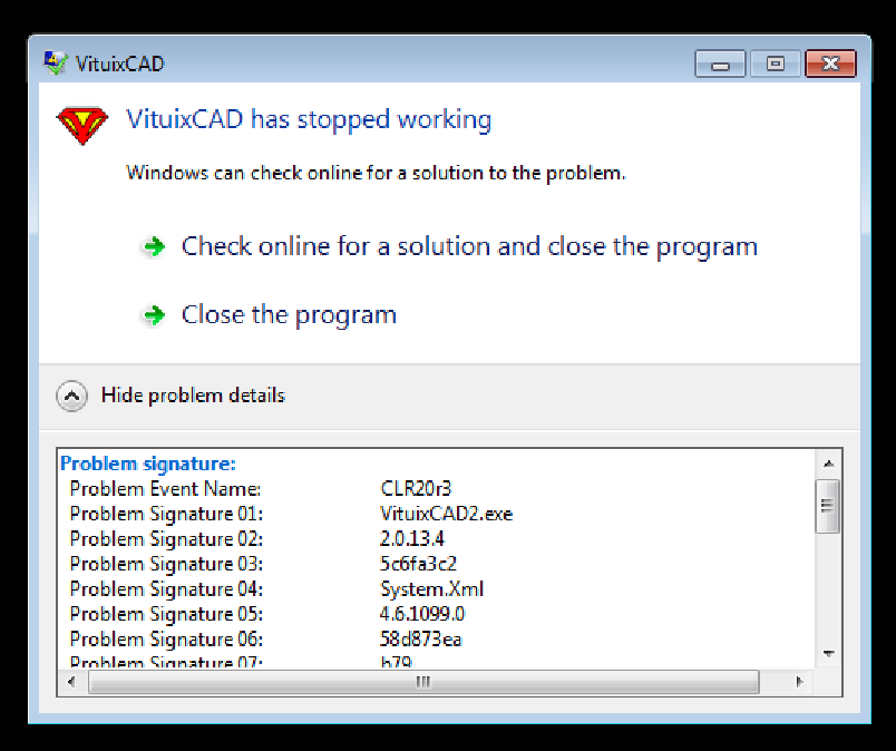

Vitiuix CAD used to work ok on my Windows 7 VirtualBox machine. However, today I got a message saying "VituixCAD has stopped working" (see attached screenshot). I thought this might be some Windoze hickup, but other programs like Firefox work as expected. I have no clue about Windows, so I am pretty lost... What's going on here?
...I have no clue about Windows, so I am pretty lost... What's going on here?
My Win7 run flawless so far and can see in log it got new .NET Framework update 13. of February and again 21. of February and think remember VirtuixCAD is connected there so wonder had your Win7 been updated about those packages.

..Windows 7 VirtualBox machine...
Unfortunately I can't help much with virtual machines on macOS or Linux.
If program is able to start, installed .NET versions are listed in the end of text box in About window. Minimum requirement is .NET 4.0. This is how it looks in native Win 10 machine up to date:
Some bad user setting has probably prevented program starting in some (rare) cases. User settings are saved in subdirectories of C:\Users\username\AppData\Local\Kimmo_Saunisto". AppData is hidden directory. Remove all directories below 'Kimmo_Saunisto' to reset all settings to initial/default values. Shouldn't be necessary to reboot or uninstall and reinstall, but those can be done to ensure clean installation.

The latest built of 2.0.13.4 (uploaded few minutes ago) is able to delete user.config file if loading of previous settings fails.
This clears MRU file list and other user settings to factory defaults, but program should be able to start.

That did the trick! Thanks!

Very good. This is globally 3rd occasion I'm aware of. It would be nice to know what user setting(s) could cause trouble as corrupted, but that would require problem in my development environment. I keep user settings directory quite clean, only for the last 2...3 revisions which probably helps with native Win 10.
New exception handing informs about severe file corruption, but that cannot prevent problems with value of some individual setting.

I did try running the new version first, which crashed in the same way as my previous version. Only after I deleted the settings I got it working again.

Next time when program crashes could you send user.config to me before you delete it? e-mail address in About window.

New built of revision 2.0.13.4 is available, uploaded this morning (10:53 GMT+2). I just tried to guess what values could cause error on virtual machine or with some special localization setting. No guarantee that it's better than previous trial.
