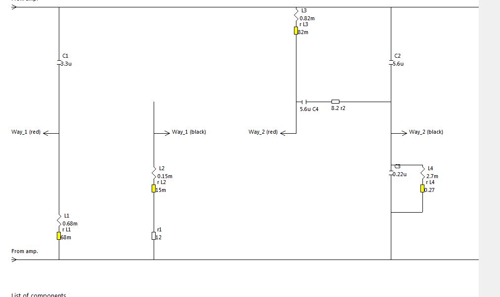

Hello Kimmo,
I still cannot figure out the schematics that come out of Vituix.
Any change of an explanation on how to decode them?
Thank you,
David.
