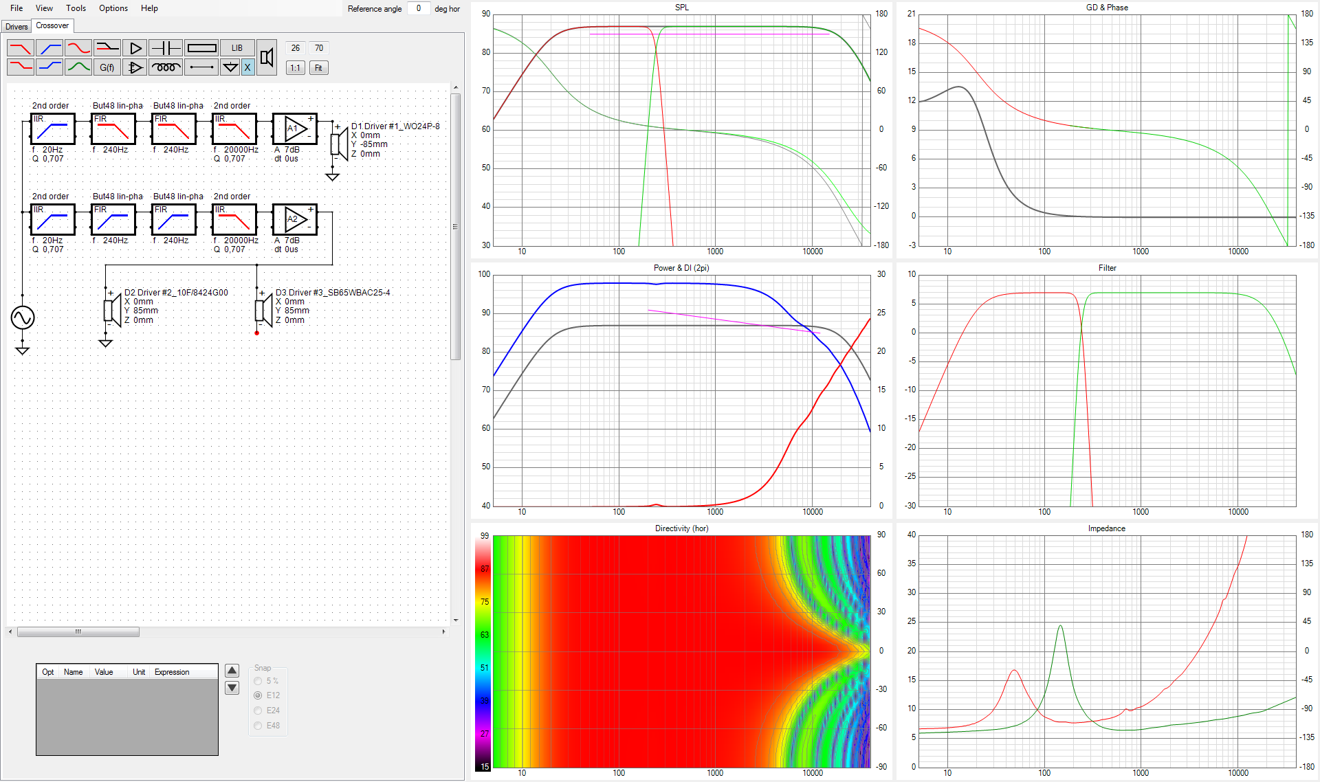

After the new update, I have an accurate coverage of the crossover and phase simulation with measurement. My calibration microphone file does not have phase information.
When measuring to the crossover, it always performs a reference measurement (midwoofer + tweeter), which is later added as Reference angle overlay (a bit of a pity that there is no option to scale this measurement). The measurement is done on the tweeter axis and this microphone position does not change.
Next, I enter the XYZ geometric data for the woofer and simulates the measurement distance of the microphone the same as for the measurement distance.
This simple method always gives me the maximum simulation compatibility with the measurement.

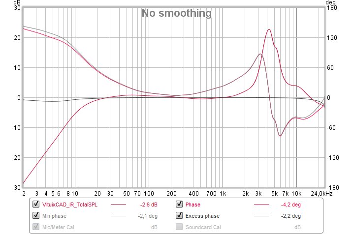

Had VituixCAD2 installed and feeded it some more or less complicated txt file response which belongs a calibration file for a headphone EARS unit from miniDSP and got it to output below 64bit stereo IR analyzed for minimum and excess phase into REW, that is fast and great result and can see many use cases where one in fast way can use it for model predictions and manipulation including how a factory datasheet curve probably will sound like if we load that IR into a convolution engine on a linear dialed in system, looks if txt response file have limited numbers at stopbands one have to manual way manipulate those tails in txt file but this feature is still very usefull and fast way, great thanks for guide.
...looks if txt response file have limited numbers at stopbands one have to manual way manipulate those tails in txt file...
After some learning curve and practice time it works much better now, file is first put through calgulator feature "Minimum phase A" from there whatever weird response curve looks gets a pretty good quality export as IR 🙂

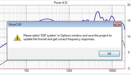

I have just installed the last available version. When I open the files from projects of the previous version I get the message (See the pic)
All of them are analog filters.
I have set the DSP in Options to Analog and saved the projects again to no avail
Is just a warning?
I´m doing something wrong?
BTW The projects open with no problem.

^It's a warning that project should be saved once with correct 'DSP system' selection in Options window to update older project file (vxp) format to the latest. After that nagging is gone and simulated frequency responses are compatible with selected DSP system.
Responses are already correct with analog projects because Analog is default selection in Options. Saving just stops nagging.
