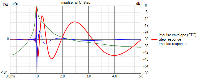

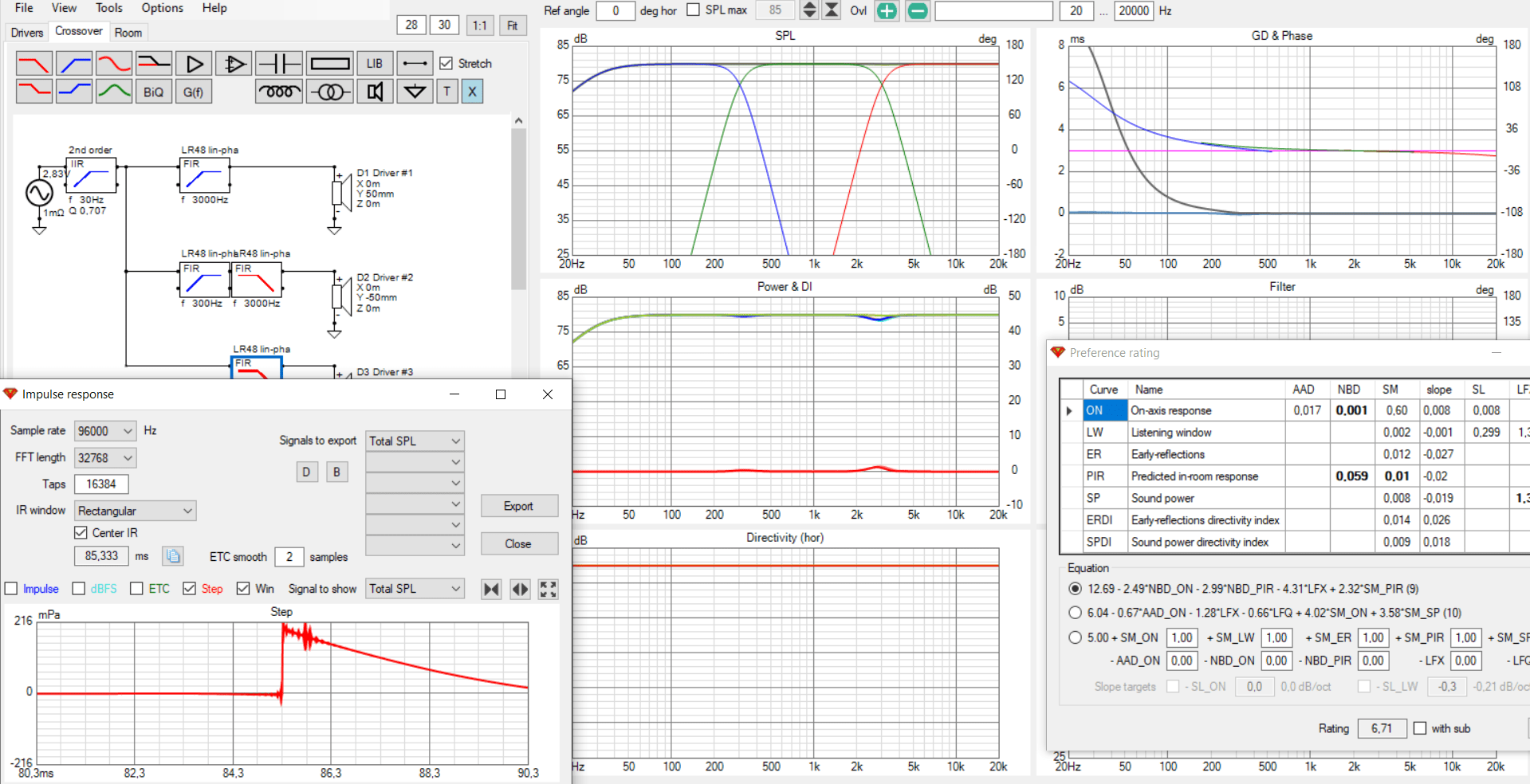

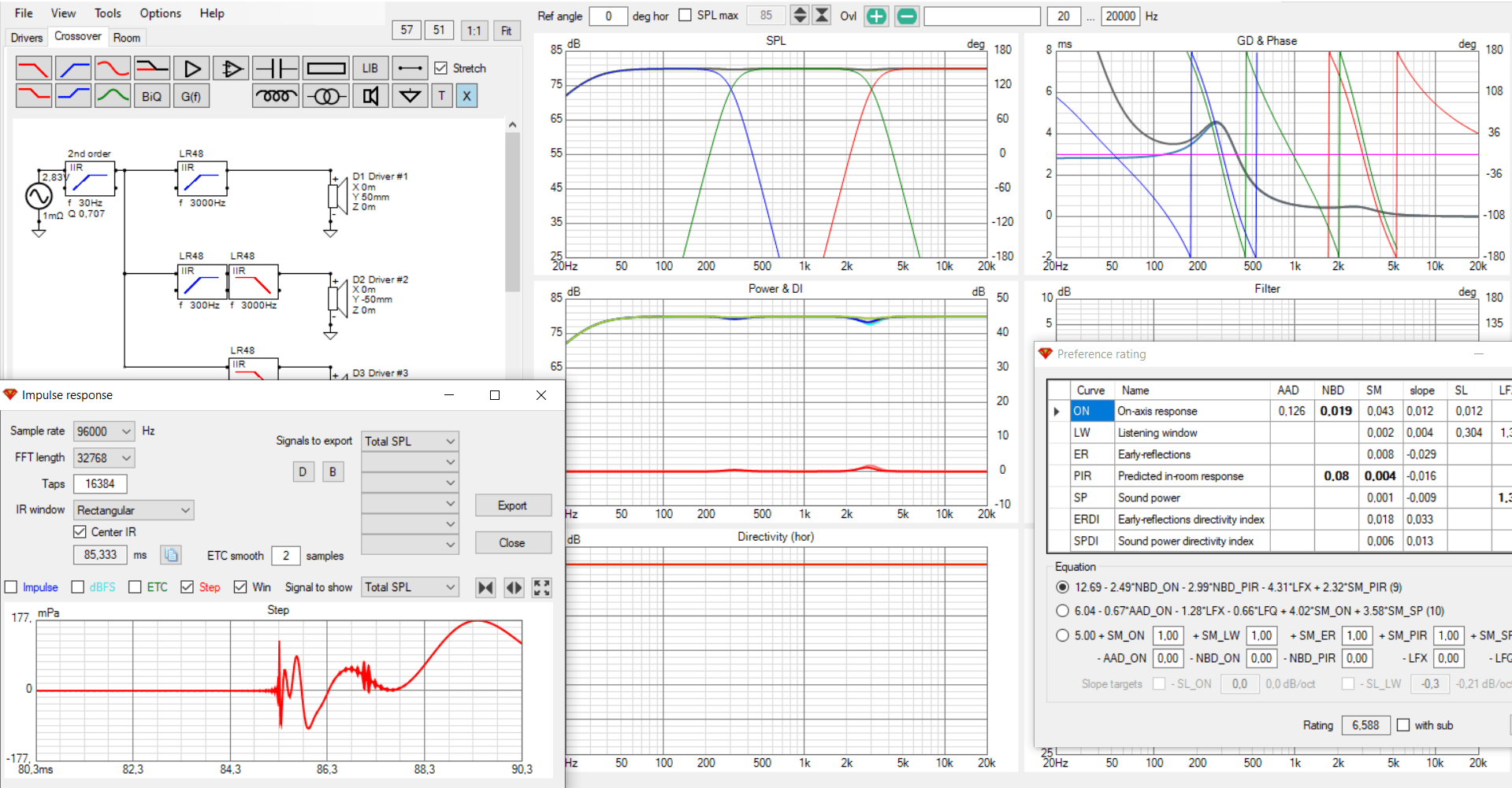

For example simulated 4-way with 4th order slopes (equal to Kef Reference 207/2). Peak pressure 134 mPa.

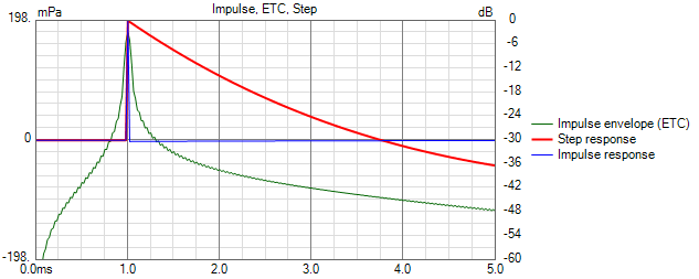

The same without XO i.e. minimum-phase response with HP at sub only. Pressure peak 198 mPa.
I would use excess group delay curve for XO tuning because it's more direct than traces in IR window.

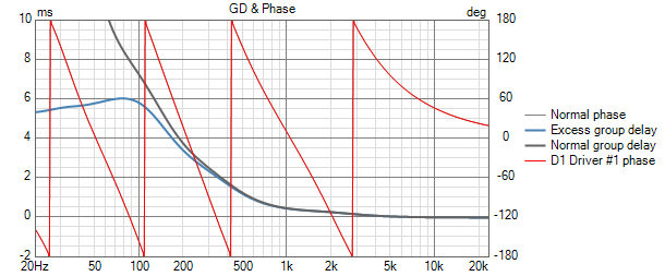

GD & Phase of the first one.
Excess GD peak at 100 Hz of actual speaker (207/2) could be even higher, e.g. 8 ms.
My design target with IIR XO is much closer to 0 ms, but sometimes e.g. 1.8 ms at 100 Hz is inavoidable.

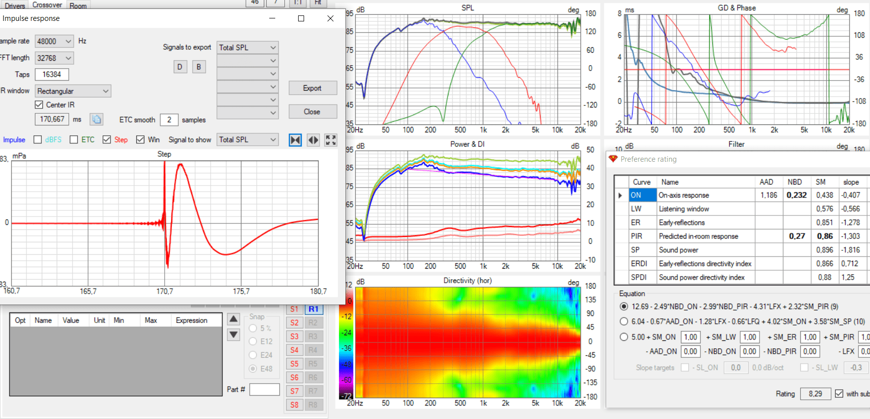

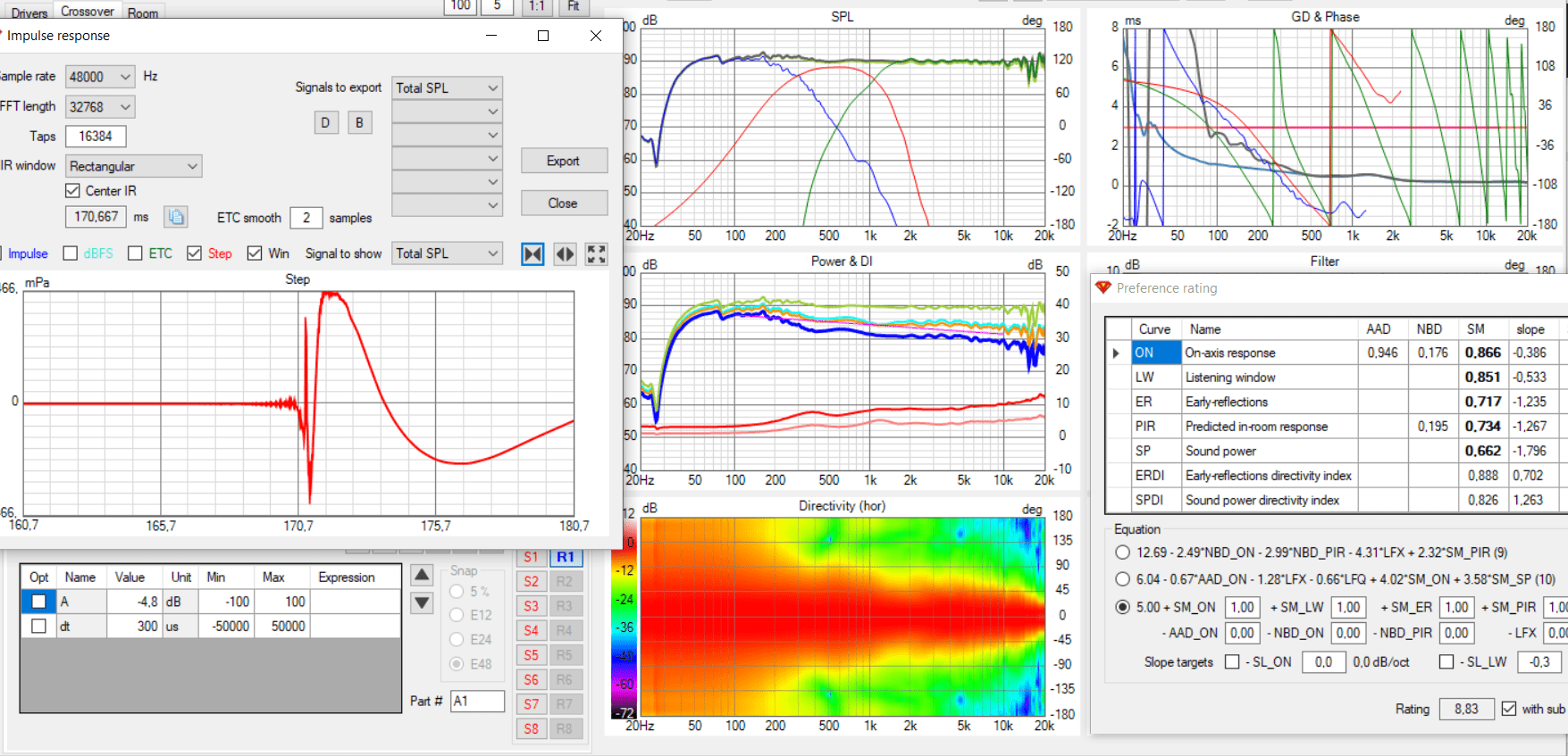

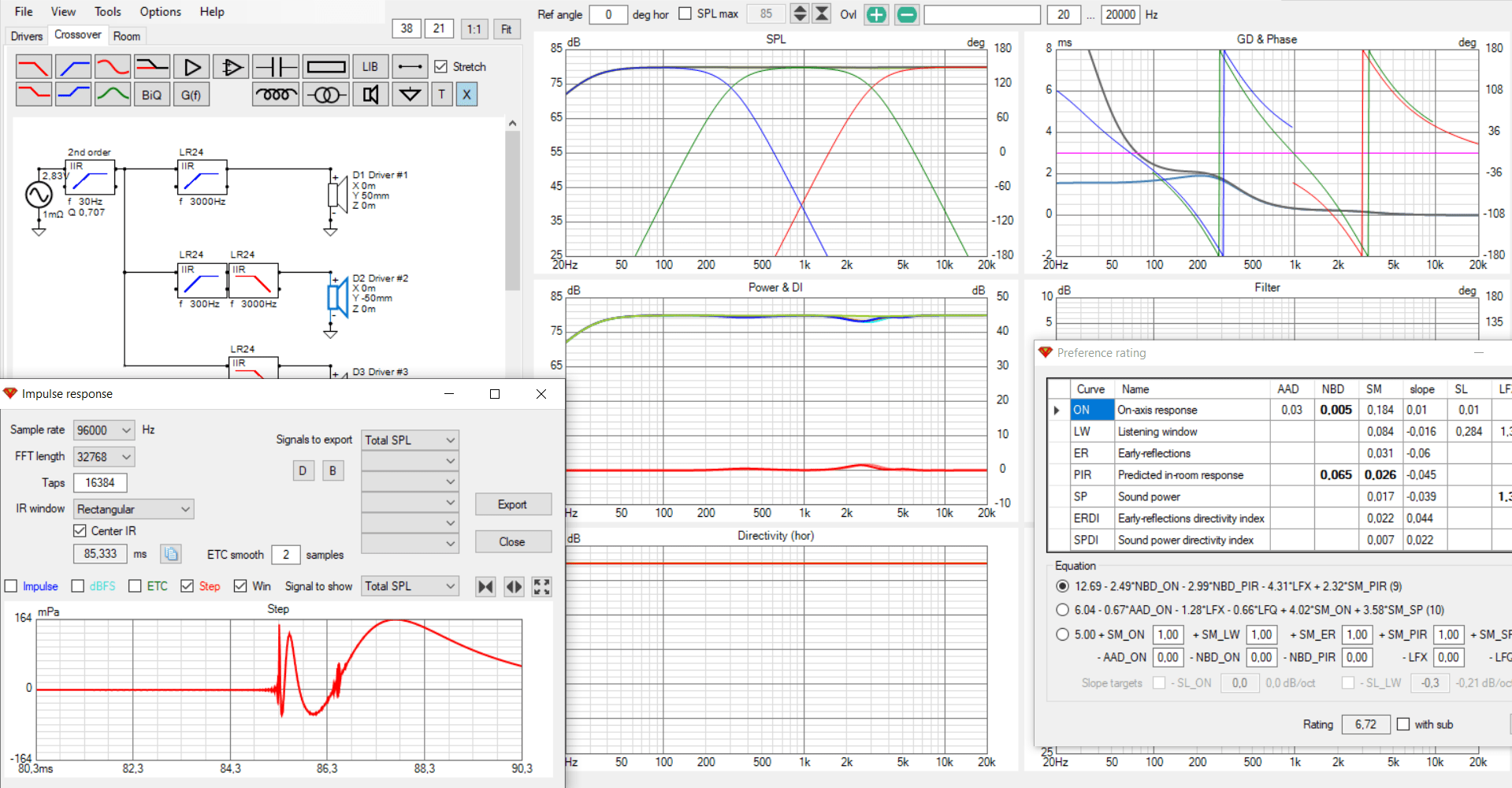

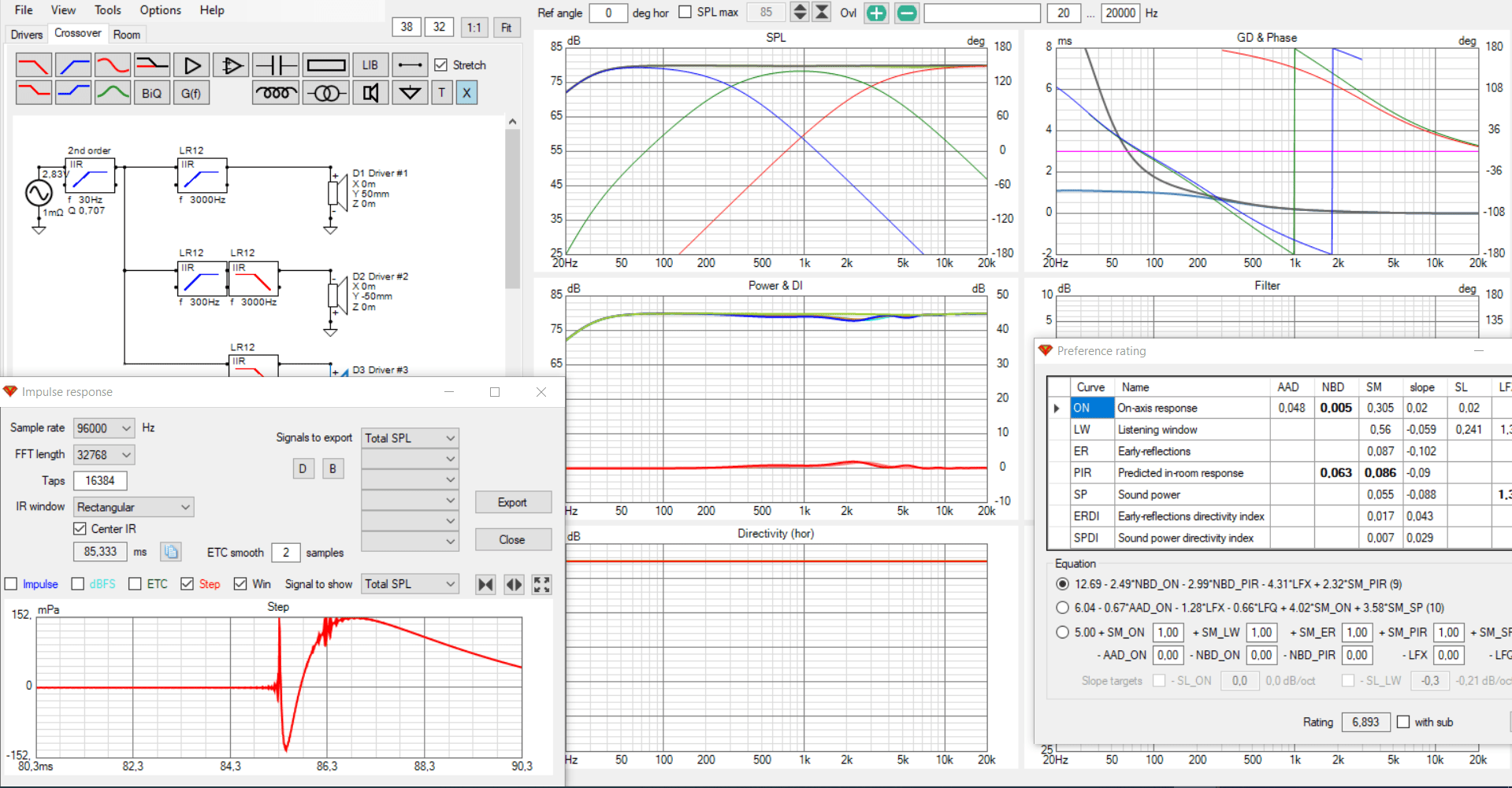

Quick experiment with ideal drivers, the peak pressure in impulse response window is not good indication for "the feel" as explained by kimmosto, too many things affect. Ironically in this ideal point source experiment with arbitrary filters and spacings all LR12 filters wins by reference rating 😀
And here a real system with two different xo versions. These should be the "boring" and "lively" settings unless my memos are wrangled. Preference rating is about the same, power and DI smooth, all in all its the same speaker just different settings in the DSP. Both sound fine and nice but the other one is just alive having "the feel" when the other is boring sounding in comparison. While the difference could be anything as there is differences in the graphs it might be the timing. Excess group delay seems to be roughly the same on bass, while the other rises higher up in frequency. Hopefully sometime on summer holiday I've got time and energy to go back to these and weed out what makes the difference.
Hah, its fun to cycle these screenshots through, there is big difference on the last two in bass for example, which ought to contribute on the preference rating in simulator for example. In DSP i've adjusted the bass and if remember it is about same settings for both. I need to make the DSP settings back to simulator to reflect the actual situation and then see what the difference is.

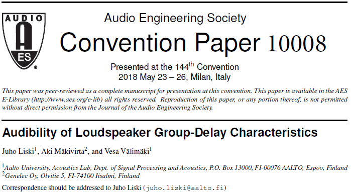

Been playing with question why the timing and related "pressure hit" is not good to be tested with headphones? Recent discussion on it here has been that there is the feel that would be missing, sensing with other parts of body than ears. Then bumped weltersys text on another thread which reads "... and similar to the way are hearing works-we can take handclaps and hammering nails at over 125dB peak without seeming too terribly loud, but a 1kHz sine wave at 100 dB does.", which makes sense having experienced hand claps and hammering.
Isn't it then that ear has some compression or some other protection system on it so that the "pressure hit" is just not coming through ears, headphone listening, and by that the audibility of group delay stuff is dependent on ear processing capability. But, we can sense it other ways making it not audible but sensible it seems. No wonder better performance on this respects would make loudspeaker sound more like a sensation, engaging, involving more senses. If we only could add nice scent and good taste to it as well it would be even greater sensation 😀 So, perhaps there is something to it, looking at the step or impulse response peak pressure in the simulator at some point? we can sense lot of pressure with our bodies, lets make it as high as possible! 🙂
Trying to reason on it so might be wrong conclusions. Anyone has more insight, good papers to read?

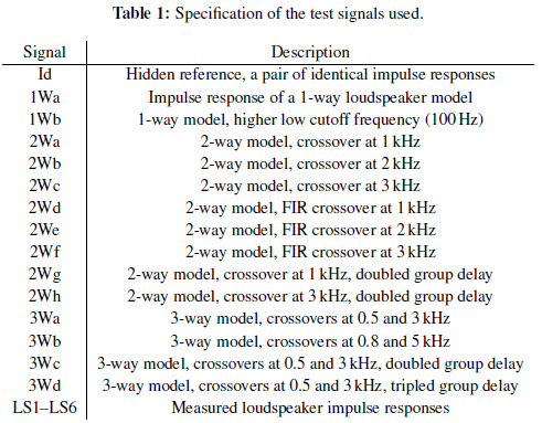

One of the latest studies.
Result with pink impulse:
I'm quite sure this will not end "practical ignorance" and selective blind and deaf faith in Toole et al.
