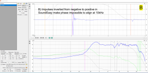

TITLE: Cannot align tweeter phase after IR inversion from negative to positive
While newbies are not likely to have SoundEasy, they may very well measure with an internal sound card that inverts the data and ref IRs. Hopefully, with input with senior users, a way forward can be clarified.
Included below, are screen shots of tweeter FR and phase generated from IRs imported form SEv27. Phase is easily aligned when the impulses are negative and non inverted (A). However, after inversion, I cannot obtain reasonable phase alignment (B). By invoking the 'invert' command in Vituixcad , the IR of 'B" is now easily aligned. What to make of this data? Just leave the IRs non-inverted in SE then import?--Barry
Joined 2003
What exactly are you trying to align here? Measured phase with minimum phase? Min phase is mostly pointless, just hit the "Far 1" button, adjust right window and go. Since your response <500Hz is quite high, you might try the "DC offset" button to see if it provides a better low frequency roll off. The measurement guides will have you try to get a near min phase result, but this is only for ease of chart viewing, really you can just hit FAR 1 and be done with it. Result of response C is perfectly fine, I'm not sure what's going on in response A to have caused a null at 280Hz.
The only real application to reference minimum phase would be for combining multiple near field measurements like driver + port, because the mic will have been moved and the acoustic delay is irrelevant for near field, its good to align the measurements to min phase for best combined result.
FWIW, response A and C are both in positive phase, B is inverted, you will notice the phase is roughly 180 degrees from the min phase result, as well the impulse and reflections shown are both downward facing.
