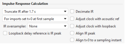

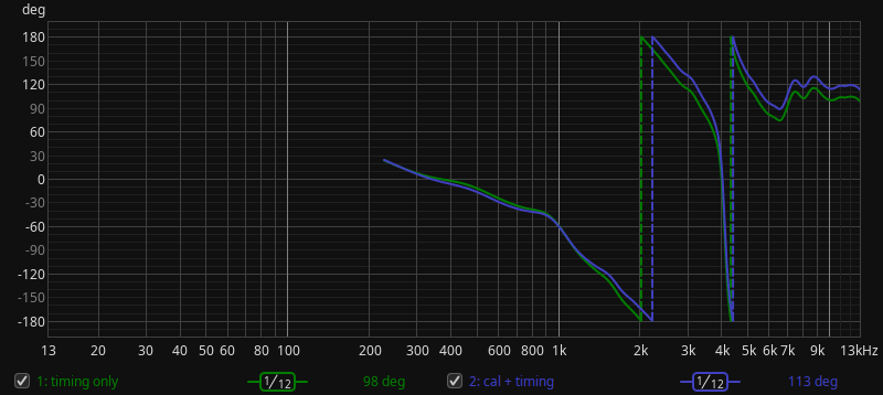

You will probably find the frequency response is slightly different too. I would expect the two phase response to overlap at some point if timing is indeed the same between the two. Simple comparison on my end shows perfect overlap from <1kHz. Only phase difference here is due to change in response at high freq.
First thing I would make sure of is the resampling options in REW are disabled per VCAD instructions:
That's very strange! Timing is the same, and IR Calculation options are exactly like yours (and per VCAD)
But no big deal I guess, I'm only using the “Use loopback as cal and timing reference” from now on anyways 🙂

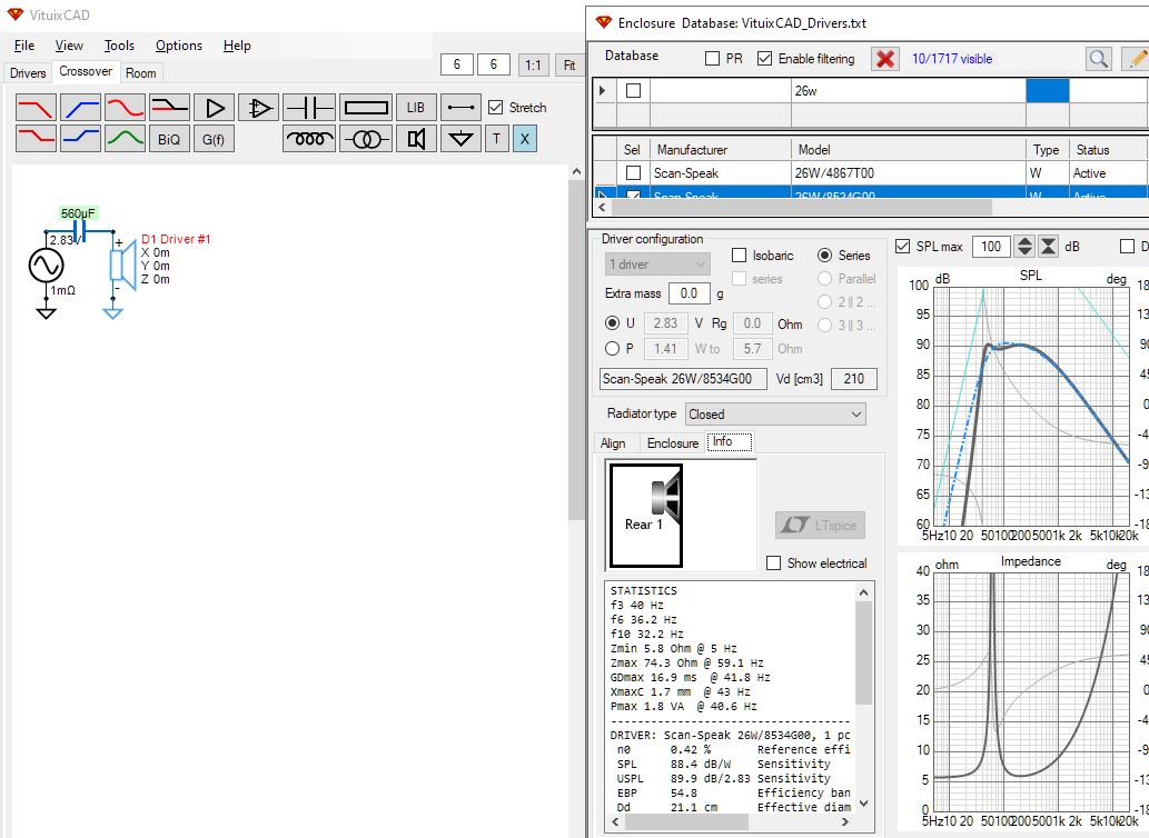

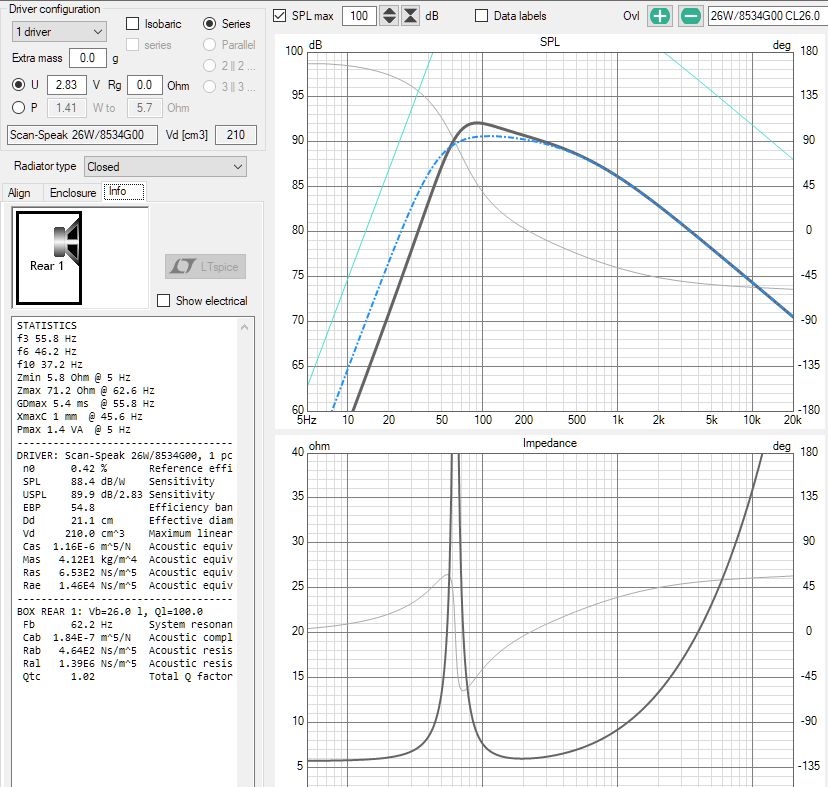

Hope this thread is still active.
I'd like to know if VC can simulate the GHP series-cap bass boost trick in a "too small" closed box,
From what I understand, you calculate VB for a QTC of 1.0, use that volume and add a 600uf or so capacitor in series with the woofer.
I'm trying to do this in VC but the F3 calculated in the info screen never goes below the F3 calculated normally for a QTC of 0.7 or even 1.0

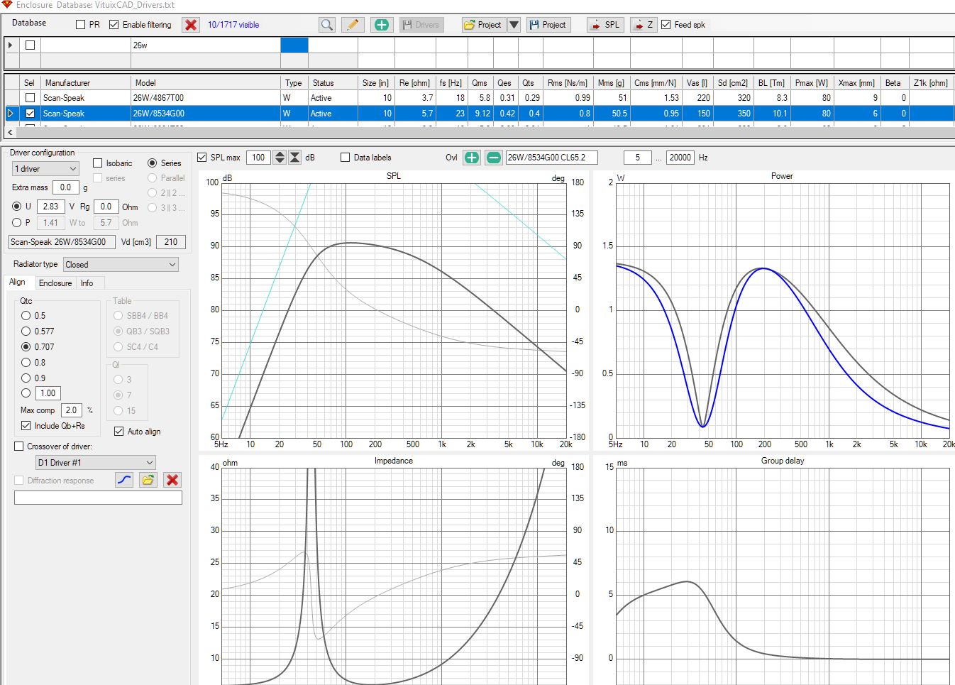

e.g. using 26W/8534 from enclosure tab,
1. I choose closed box QTC 0.7, auto-align > VB = 65.2L & info tab F3 = 44hz
2. Then I change QTC = 1.0, auto-align > VB = 26L & info tab f3 = 55.8hz - it now shows a bump in the bass response

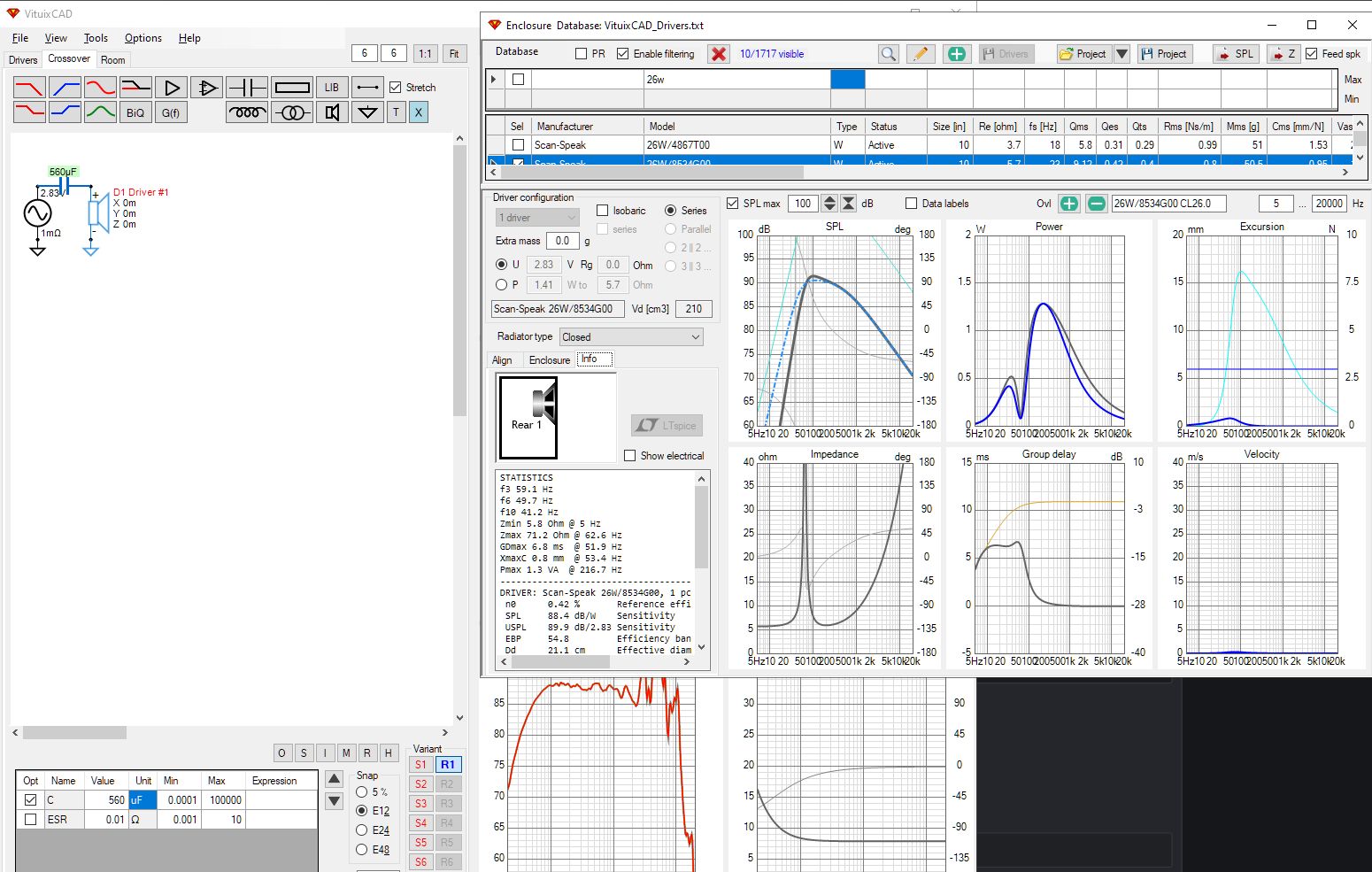

3. Using VB = 26L, I check feed speaker and check use crossover for driver 1 and insert a series cap of 580uf in the crossover.
But changing the value of the cap up and down doesn't lower the f3 , and min F3 I get is 56.6hz with a 1200uf cap.
I tried using the FRD and ZMA files and also leaving them out, but the F3 results don't change.
Am I doing something wrong?

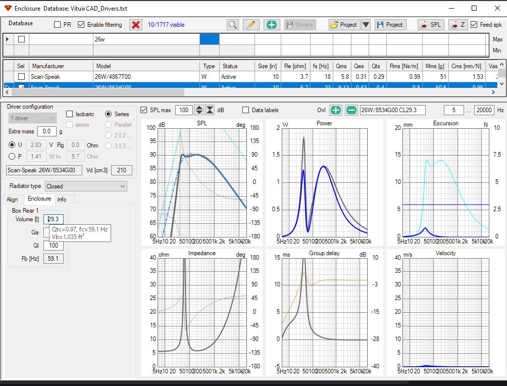

Update - think I got it working! I had to manually tweak the enclosure volume to a QTC of 0.93 (instead of auto-aligning QTC = 1).
Then the calculated F3 went to 40hz for a VB of 29.3L. Amazing.
Reactions: Toaster79
