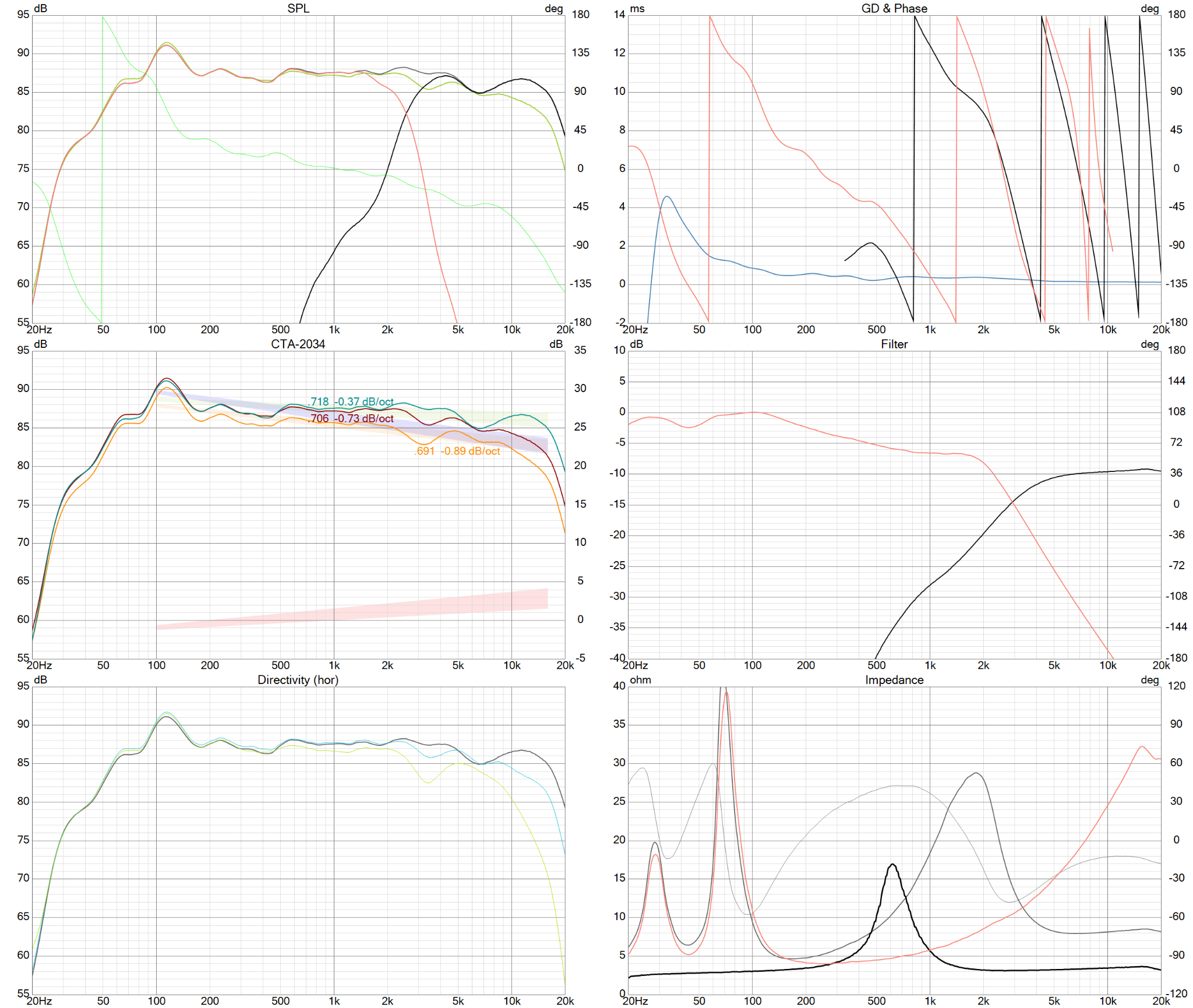

Overall it looks pretty good. You are making good progress.
It looks to me like the port frequency is tuned a little too low. The woofer's Thiele-Small parameters may differ a bit from the specification. It may loosen up a little with breakin, but probably not much. Using a longer port may help a bit, maybe one tuned for 50 Hz or so.
I don't know whether the peak around 115 Hz is a measurement artifact or something else. I don't see a blip in the impedance response there, so I don't think it is a resonance. Nonetheless, a lot of people like a little extra boost at that frequency.
Looking at the phase and frequency response charts, the drivers are in phase at the crossover frequency. Good job. But, the tweeter's phase starts to diverge quickly just below that. In addition, the SPL is elevated a little around the crossover region. Perhaps you can make adjustments to address those issues?
Also, if you have not done so, make sure that you input the x, y, z cooridinates for your drivers in VituixCAD.

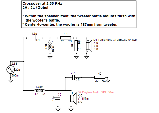

@TerryForsythe Thank you for checking my work!
Port tuning: I have read lab measurements for the T/S parameters that vary from the factory a little. I’ll make sure I try the lab measurements. What are you looking for to tell the performance of the port? I expect to extend bass a little if all is well but you saw something that worried you. The port length is 5.375” (41Hz). I tried 3.3” (49Hz) and it didn’t seem to be adding much to the boxes low end.
Crossover changes don’t affect the blip at 115Hz (it shows up in REW). I haven’t tried complicated crossovers, though. I do have to go and fix the ESR and DCR values for caps and inductors. I doubt things will change much. Perhaps it’s a baffle issue affecting frequencies just above the blip, accentuating it.
The rate of the tweeter phase changing below the crossover point is noted. I’m not sure I can soften that without breaking something else. I may try moving the crossover point from 2.3KHz nearer to 3KHz. Maybe that’s enough?
The tweeter is free standing with its own 4” baffle. That baffle is in the same plane as the woofer’s so they share the same Z. I have adjusted the Y of the woofer. The twtr and wfr share the same X. I have played with moving Z of the tweeter farther from the listener, but things didn’t improve.

Have a look at the impedance level at the valley between the peaks. It should usually (unless highly dampened tuning, e.g. aperiodic) be similar to the impedance above the upper peak.What are you looking for to tell the performance of the port?
In your case (around 5 ohm) it could be slightly lower, but I guess it's perfectly ok as it is. Eventually check for small air leaks: play a sine wave at tuning frequency, raise the level and listen for high pitched noise.

Looks quite good, I would attenuate a couple of dB the area from 500Hz to 5kHz.@TerryForsythe, @stv, @phreepie
You are correct. I did the measurements at 2M and the 100Hz dip went away.

After tuning the port to 41Hz, and getting new impedance values, I took the new SPL measurements elevated to 2M, on-axis, +/-15 degrees, and +/-30 degrees. I had a technical difficulty doing +/-45 degrees, the speaker sitting on a small perch, when turned to 45 degrees, could fall. I loaded these measures from REW to Vituixcad2 and came up with the attached results. What do you think?

I wouldn't do that if you have a typical room without a lot of room treatment. It will make the directivity index a little worse. That will degrade the tonal balance if you have typical room reflections. If you have sound treatment on the side walls and a carpeted floor, it may not matter too much, though.I may try moving the crossover point from 2.3KHz nearer to 3KHz.
I'm not sure what is causing the phase deviation of the tweeter below 2.1kHz. You could try removing the resistors on the output side of the tweeter's filter, and adding a series resistor to the input side. Of course, that would require a change to the capacitor and inductor values for the tweeter.
If that does not improve the phase, you could experiment with filling in the gap between the tweeter enclosure and the sides of the cabinet and see if that has any effect on the phase. Maybe cut a couple of small pieces of wood and put them there and see how that impacts the phase. You also could see if adding sound absorber there has any impact.
If none of the above result in an improvement, I would stick with what you have. As it is, the phase alignment is quite a bit better than many commercially available speakers I have seen.
I would position the tweeter in the manner that has the least amount of diffraction, which probably means keeping the tweeter baffle aligned with the woofer baffle. Try to address the phase as discussed above.I have played with moving Z of the tweeter farther from the listener, but things didn’t improve.

I took your advice about lowering the sound level in the 500Hz to 5KHz range. That's for the reference to the merger examples. I don't understand them yet and will have to learn some more.

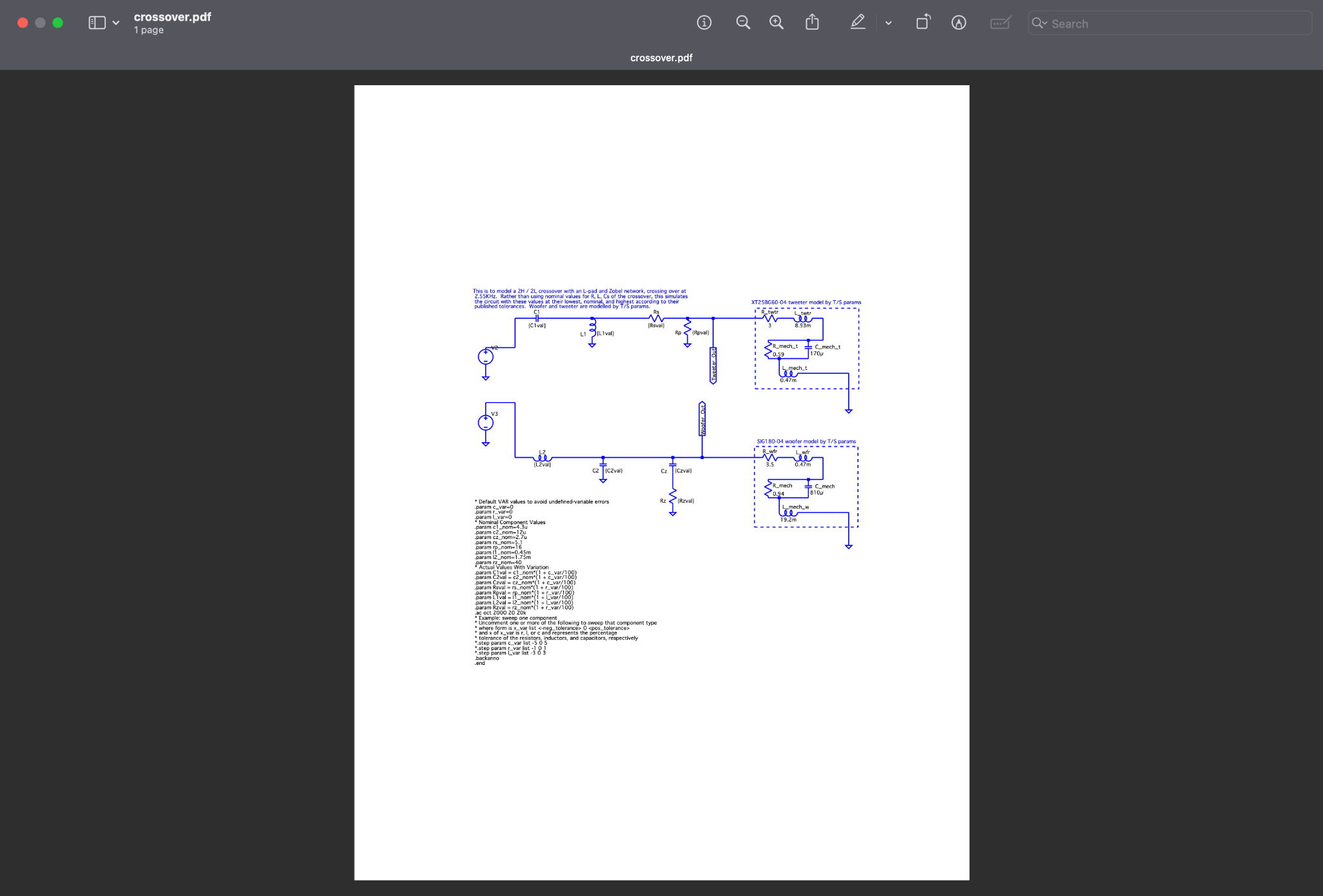

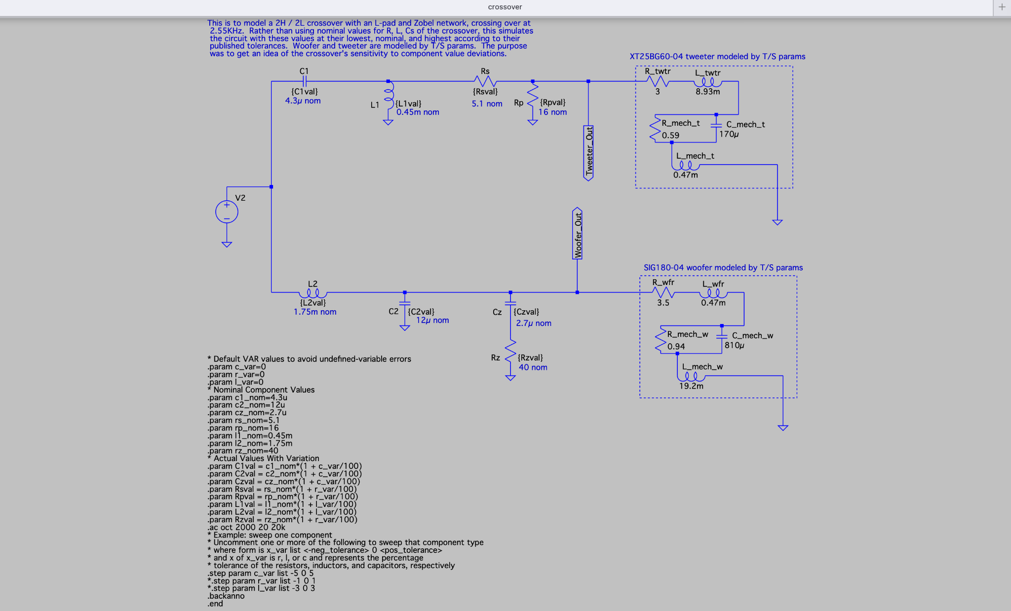

I have the crossovers and speakers assembled. They're not completely buttoned down but playable with both drivers in action. My wife, who has been amused with my slowness, was given a listen. She lit up and said she wants them for her room - so they pass her test. My own view is developing, but I definitely like them. There may be a little balancing issue, but I'm not sure. I had a minor health issue so I can't lift them to do some sweeps of them outside, but will do that next week.

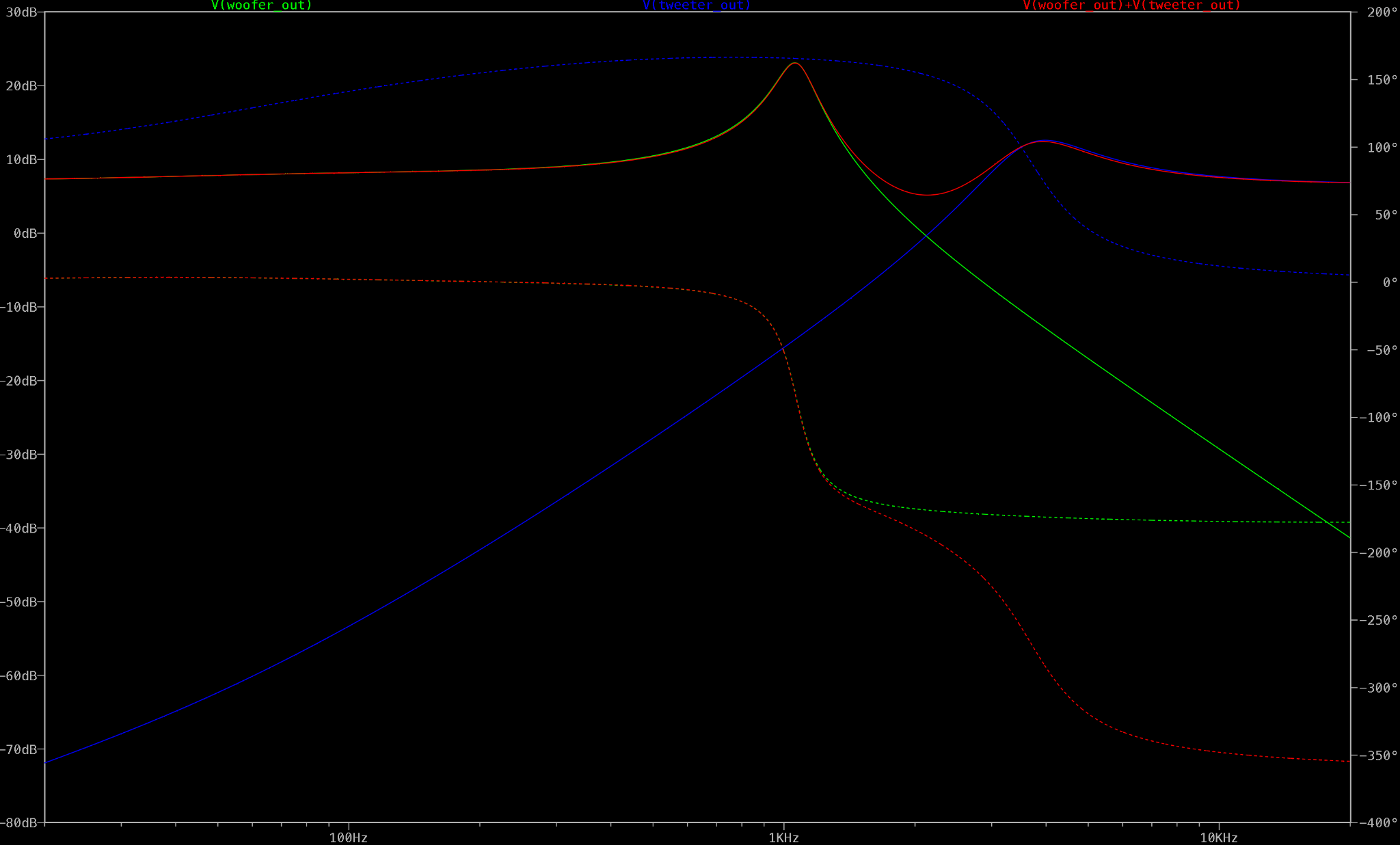

Prior to buying the crossover parts, I did some testing in LTspice using tweeter and woofer models based upon T/S params. If anyone has pointers about this I would love the incite. Both the tweeter and woofer showed rises near the crossover area that do not show up in empirical measurements. Since my goal was to estimate the sensitivity of the circuit to variations in component values (within their tolerances), I didn't let the rise problems hold up my purchase of parts. LTspice did seem to show the variations in components to have a pretty small effect.
Regarding the Vituixcad2 graphs. The rise just about 110Hz was due to a reflection from the house behind the speaker while testing outside. I'll try to do better in my testing next week.

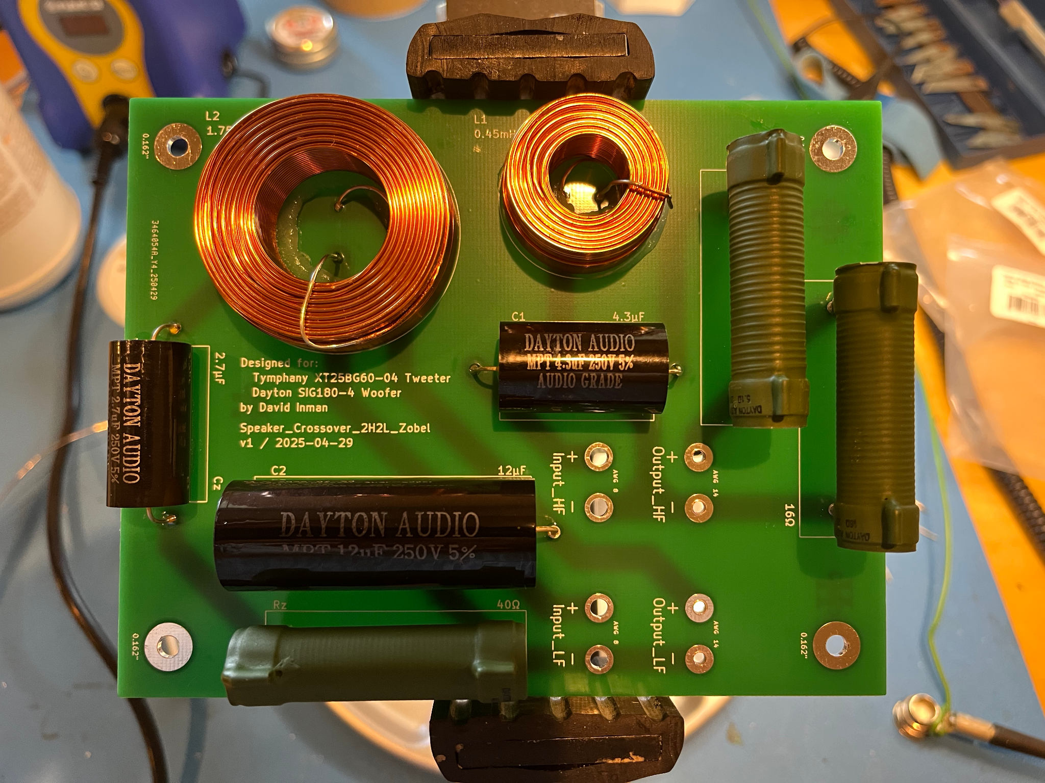

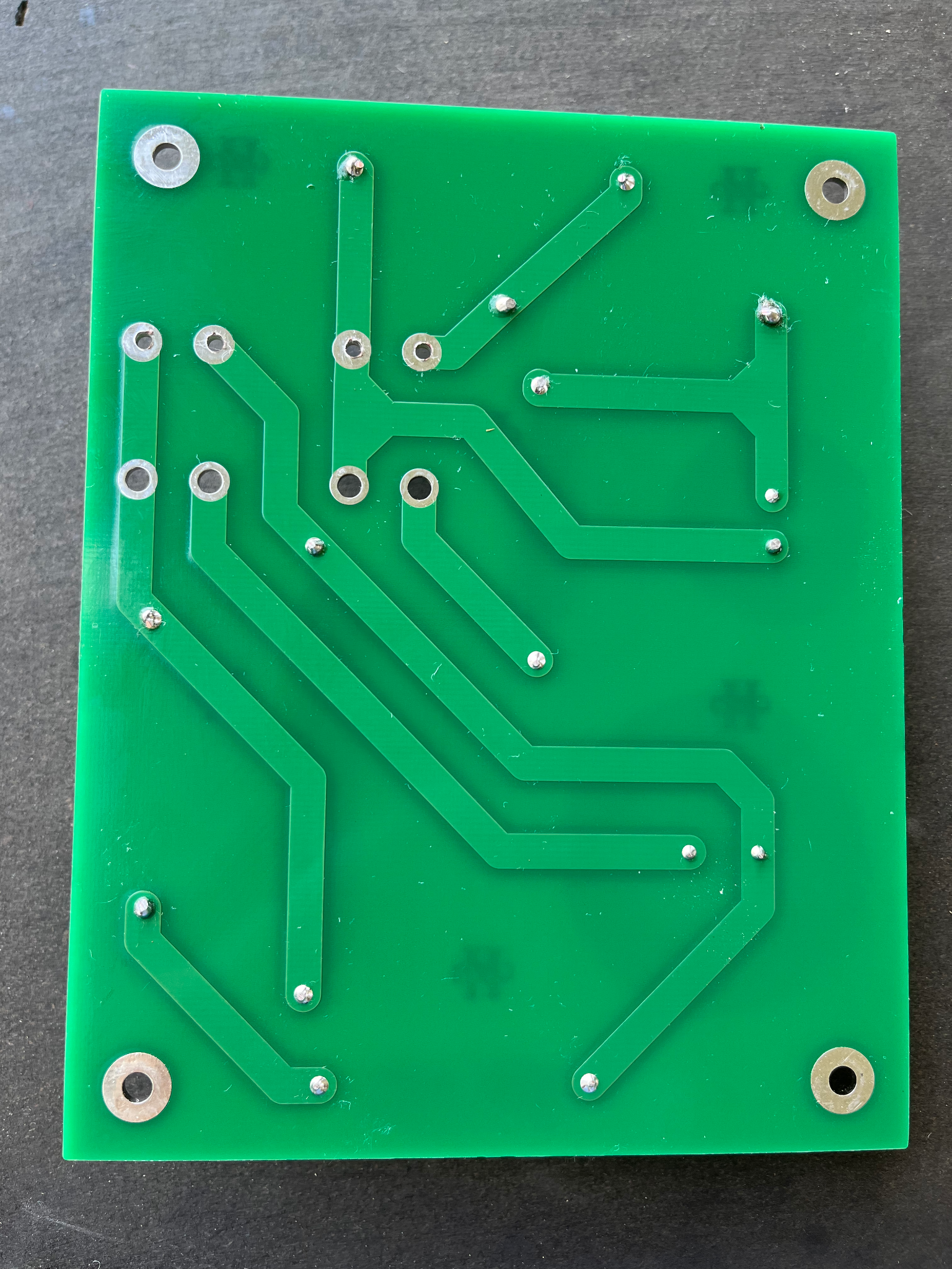

Okay, good to know. I was worried about that and coupling with the capacitors. I kept a minimum of 12mm between them. I chose the orientation asking ChatGPT (often wrong) and it suggested that orientation near capacitors. I didn’t pay enough attention to inductors coupling.You probably should mount the small inductor on it's side so that the inductors are perpendicular to one another, especially since they are close to each other. That will reduce coupling.

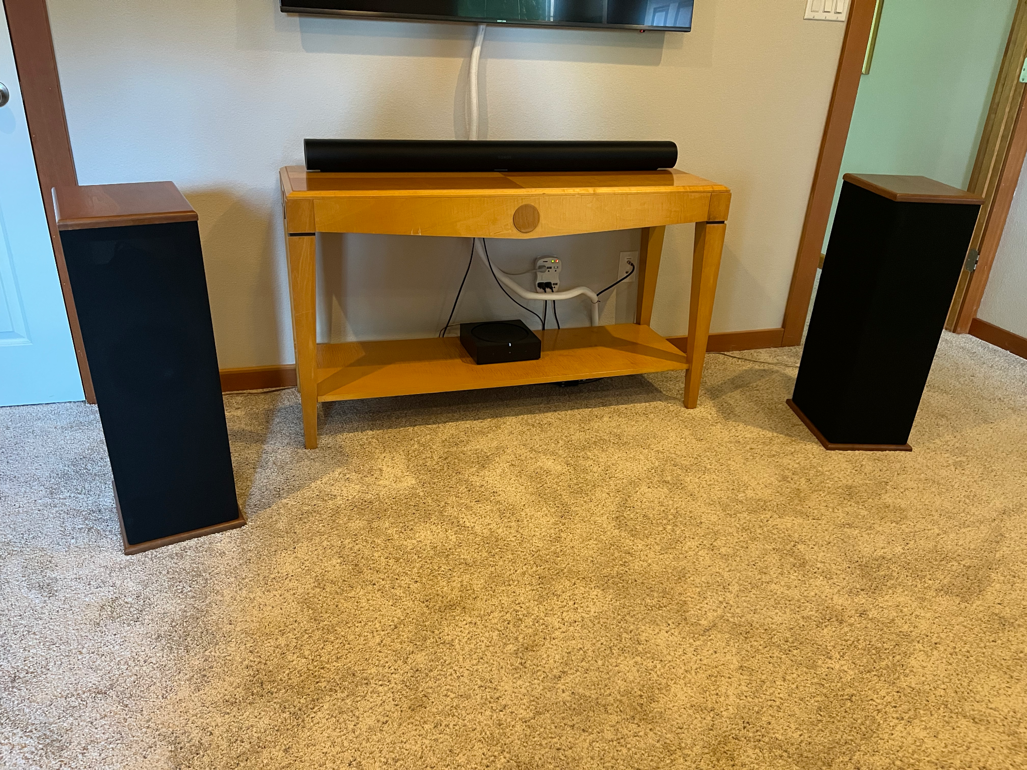

The speakers are finished! As I mentioned before, my wife loves them and has taken command of them. Thank you all for your help, especially:

This project was slow because I had so much to learn (Okay, maybe I'm slow). The speakers sound terrific. They seem balanced and produce a nice sound stage. The bass output is quite good for a 6.5" woofer. They measure out as they were designed which is very reassuring. I don't have any basis for comparison but the biggest problems for me, aside from learning, was handling the baffle step and tweeter attenuation in the crossover. Getting a fairly flat SPL with a little slope while achieving phase alignment at the crossover band was challenging. While I can't fault the sound created by this driver combination, I might choose a pair where the woofer was a bit more efficient or tweeter a bit less efficient to help with this.

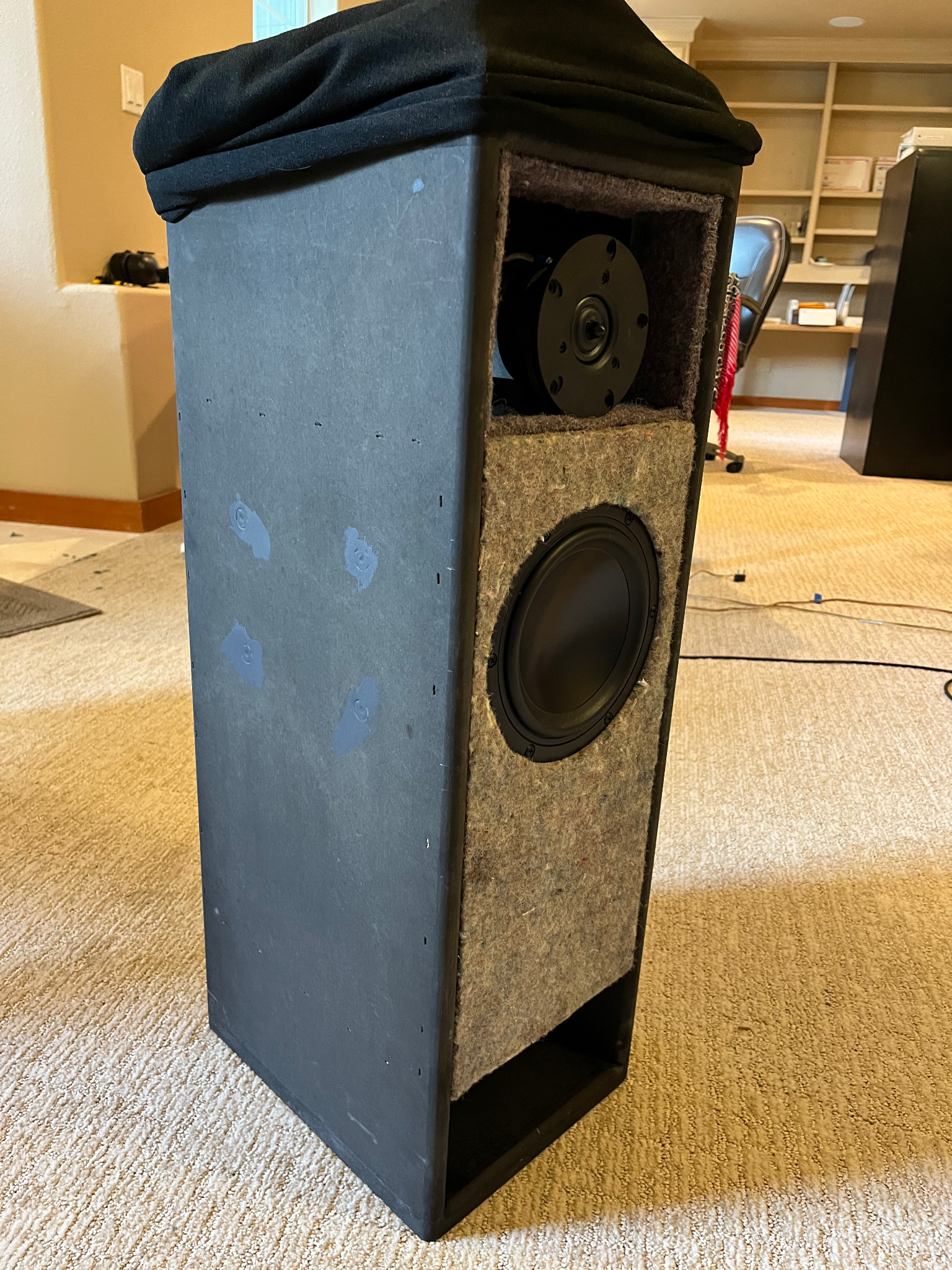

Below are images:

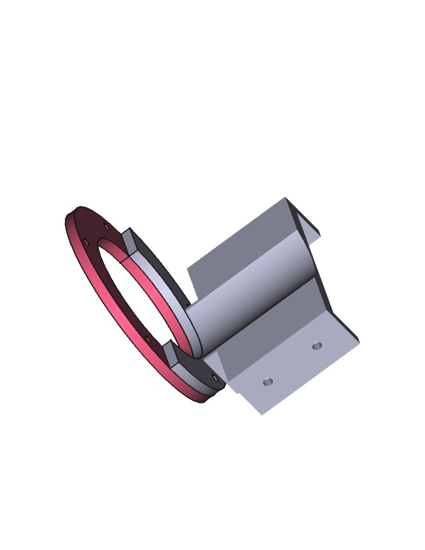

1. A 3d-printed bracket made to hold and adjust the tweeter in position.
2. A speaker with the drivers mounted such that one can see them
3. Finished speakers in place
Most recent images in messages prior reflect the design created.
To recap, the drivers used, both nominally 4 ohms, were:
Tweeter - Tymphany XT25BG60-04 from Digikey
Woofer - Dayton Audio SIG180-4 from Parts Express
The cabinet changes:
Additional insulation - 1/8" bitumen / Aluminum sheet and 2" fiberglass insulation on one of each opposing walls of the cabinet
Ported design. Tuned box to 41Hz, and added an internal flare.
Custom tweeter mount designed under FreeCad and printed by Detroit 3D Manufacturing
The 2.55KHz crossover:
2nd order Bessel High pass with L-pad
2nd order Bessel Low pass with Zobel network
Custom built PCB for the crossover, purchased from JLCPCB
Parts were Dayton Audio and Jantzen purchased at Parts Express

LTSpice - Used to verify the affect of parts at their worst but within tolerance

@TerryForsythe, @raymondj, @shadowplay62, @stv
Below are images:
