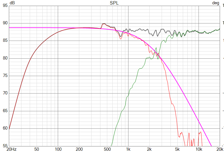

@Inman thanks for a bit more information on the positions.
What data I attached was done quickly to pretty much back up your first points, I did caveat the data provided and suggest that you treat them with some caution.
Once you get into the real data you can play with the balance and actual Xover point and corner frequency to your hearts content. maybe making the tweeter a third order and taking it down to below 2 KHz whilst keeping a watchful eye on distortion.
When you have the drivers with you, and you can take real time measurement's the interactions and the iterations can be far quicker as you can measure what a component does to the response in a few minutes.

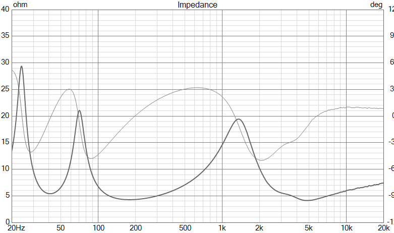

For @svp regarding your question about using the enclosure modelled impedance. Yes I could have used that data but I made the easy decision to skip that as the rapid changes of impedance around the reflex frequency would have a very small affect on the impedance around the crossover.
Back to the speakers, from your latest posts Inman it does seem like you will able to easily knock this into shape. I am intrigued to see how the Dayton driver performs and what effect all the felt will have on final measurements and values.

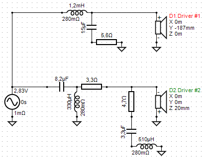

The baffle is stepped (I assumed the tw is 20mm beyond the wf)I tried to get diffraction plots for the left and right speakers. The right is further from the wall than the left. Because of the way the tool works I modeled both as a distance from the left wall with the right speaker being farther. Here they are:
Woofer
T (Sd for tw should be circa 6cm2)

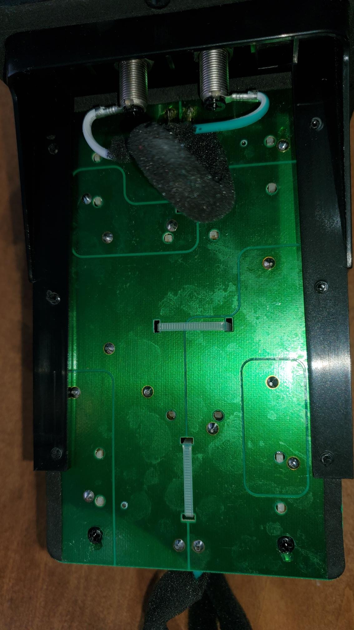

Depends on your budget for the project. But, designing a PCB and having it manufactured to your specifications is satisfying. Be sure to use a heavy copper layer. Rather than using relatively small traces, use large pads and just etch out the borders to minimize resistance, like in this picture:The cost of the PCB is remarkably small $55 for my smaller designs,

@TerryForsythe I did consider going active and knew of some of the advantages while you mentioned some I did not know. I decided against it because it ultimately pushes my costs up too much. Loved the idea - my wife, not so much.
I have planned the board for 5mm minimum traces on 2oz board. Node spacing minimums are 5mm. Spacing minimum to air coils is 10mm for unrelated nodes. For 2nd order designs I tried, I was able to use just 1 layer. For 3rd and on I have very limited use of the 2nd layer. I'm not sure it matters but the point was to limit plate and fringing parasitics between nodes. I believe the boards should handle 7 Amps safely. I think that should be plenty with the drivers chosen. I set up the boards such that the high pass and low pass are independent. Should I bi-amp someday I'll remove jumpers merging the inputs.

Here is one of mine "2-way crossover" simulations attached. Yep, you see it right - that is all it needs for one channel
The inputs for the Half space FR are the traced curves or the FRD you can download from the websites of the manufacturers (when available).So where did you get the inputs for the half space response? I'm familiar with the tracing tool and have used it quite a bit. Once done, you then used Export to fold into your simulation of the drivers? On the tweeter, I noticed you have the Full Space button selected but not on the woofer. Why?

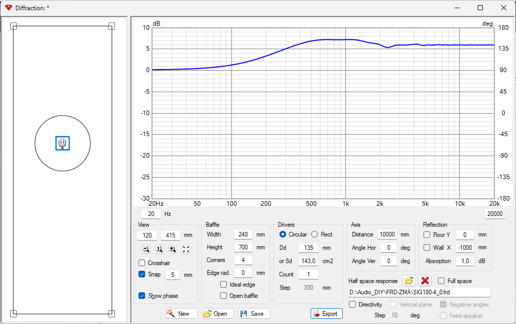

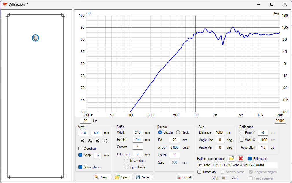

So basically, you have to
Design your box in Enclosure tool and save the 2Pi FR and ZR
Design your baffle in diffration tool and export the curve at 10m and 1m (no full space/directivity check). Then load the half space response and check the boxes Full space/Directivity (distance should be 1m) and export the FR. For the Tw, load the half space response and check the boxes Full space/Directivity (distance should be 1m) and export the FR.

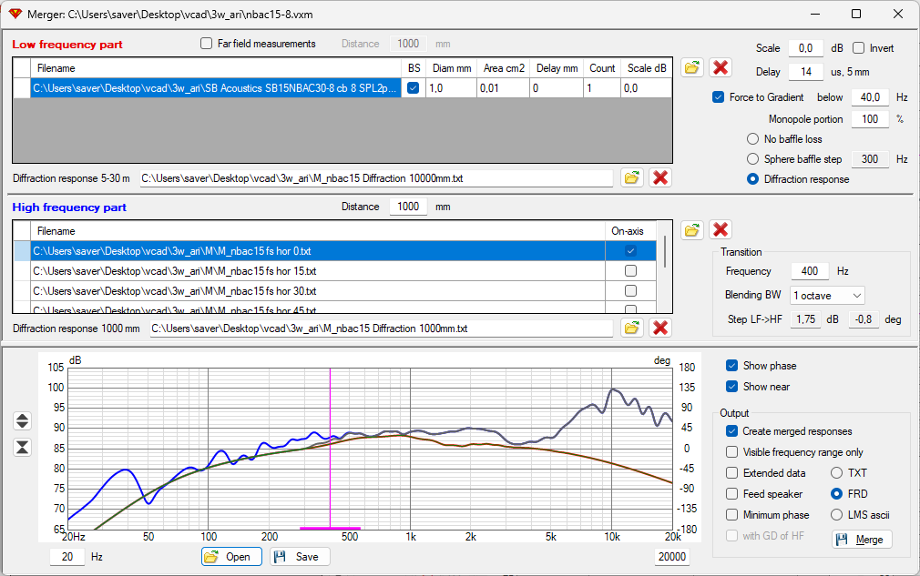

For wf and mid, that equire a box, open the Merger tool, load the FR previously exported and merge the FR to input in the main program.

I used the woofer data that was included in the Dayton driver for that driver. In the FRD data these are typically 4 files zero degrees , 30, 45 and 60. I used the the zero degree data. Dayton are to be commended for this, but at the same time their resolution maybe be less than we would personally measure.
The Peerless tweeter was done by using the SPL trace tool. I used the 0 degree axis for SPL/FRD data and the impedance trace export for the ZMA.
Shadow play you mention "Design your baffle in diffraction tool and export the curve at 10m and 1m (no full space/directivity check)"

@shadowplay62 Thanks for the explanation. I have not even tried the Merger tool. It's on my list now. I put your crossover parameters in and made a few minor tweaks to see what moves what. Thank you. That bit of bad behavior between 420 and 780 Hz is annoying - nothing I did moved the plot. Looks like it will be audible but perhaps not. I know that I have tried several SPL and impedance files and not all display this bump.

In the screenshot is just the part of the wav files for each driver exported from VituixCAD impulse response and used in EQ APO. It mimics real crossover which you can listen before building physical one. There will be some differences of course, but simulations saves a lot of time and money for guesswork and prototypes.

@svp thanks for the clarification. I'm checking out the TPA325x - not very expensive. The fairly small pipe going into my brain is a bottleneck for some of this stuff. For now my plan is "REW -> VituixCAD->..." and to measure actual values when the drivers arrive later this week.

As promised, here is a library for making crossovers in LibrePCB. Unzip the file into LibrePCB's directory containing your libraries. On my MacOS the path is "~/LibrePCB-Workspace/data/libraries/local". Once you've done this it should be visible to LibrePCB's Workspace Library Manager. The usual disclaimer: it probably has mistakes, may not work, etc. The specifications of objects in the library were taken from online sources. I know for certain that some of the information was wrong and have tried to correct those known problems. That said, entering this information is time consuming, so I hope it benefits others.
Seet attached.
Seet attached.
