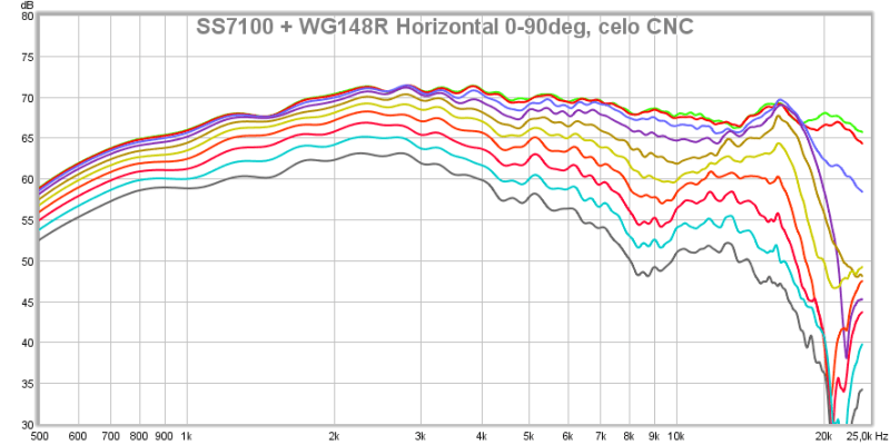

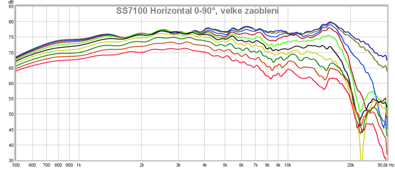

Visaton WG148R Waveguide: Highest SPL tweeter with flat faceplate?
Scan Speak 7100 might be even better option than 7000. It measures reasonable well in WG148R. I attach its measurement as raw and in WG148R.
