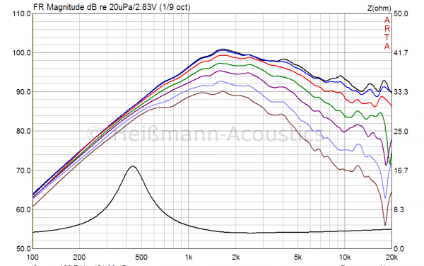

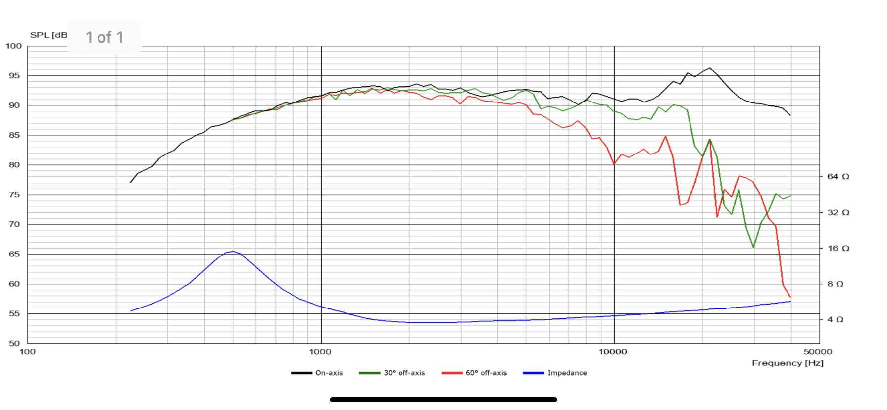

I tested/pushed theScanSpeak D2604/833000 in standard form. This is a 4 ohm nominal tweeter, with a rated sensitivity of 93dB/2.83V. But it only achieves this around 1.5-2 Khz; at 10Khz it's drooped off to 91dB, but the breakup causes it to go to 95-96dB @ 20Khz.

https://www.scan-speak.dk/datasheet/pdf/d2604-833000.pdf
I tested it up to 110dB, which is both the theoretical excursion and thermal power handling (93dB + 17 dB gain and 0.3mm x-max)

Alexander tested it on a waveguide which shapes the response like this-
Reference:
https://heissmann-acoustics.de/en/test-scan-speak-discovery-d2604-833000-p-audio-pct-300/
With an extra 17dB gain with the rated 100W power handling, you may reach/exceed 115 dB at 2KHz, but at 10Khz/20Khz you will be at 111/110dB
