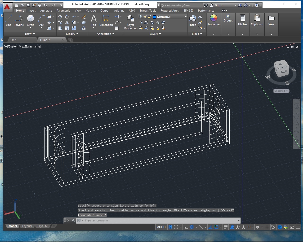

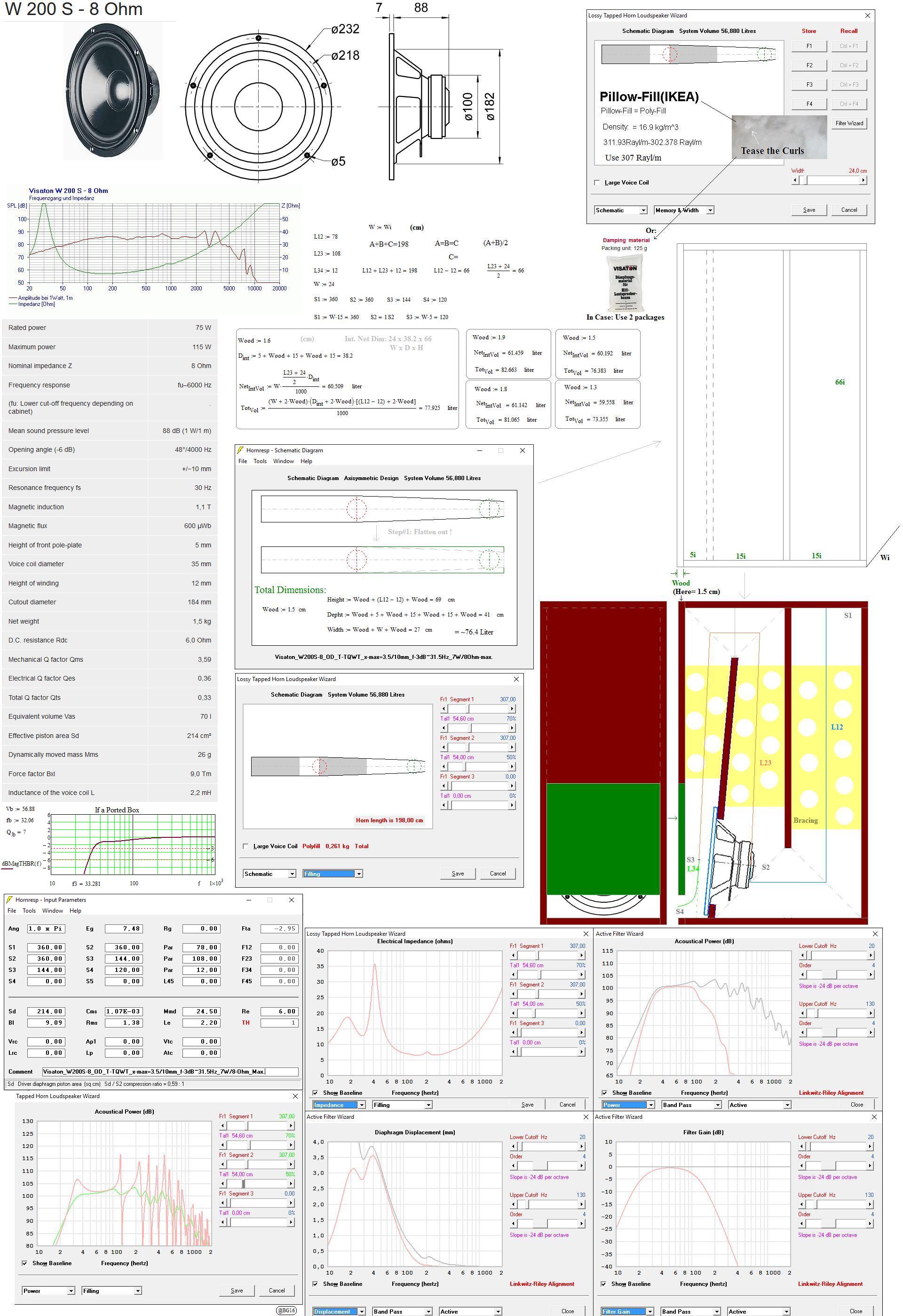

This is what I made:
Fs; 45hz
Port length: ~1.9m
Port Area: ~207cm^2
Woofer: Visaton W200 8"
25.6x24.2x99.2
