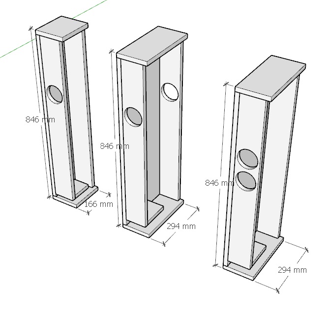

For every doubling of drivers you double the box volume [Vb] and number of vents or in the TABAQ's case, double the cab's internal width. That, or make a same area duct based on whatever cab width you want, i.e. 2 or 4x taller duct if wanting to keep it the same width, ditto make the depth 2 or 4x deeper.
If done this way, it raises the tuning some, though don't know how much and can only make a guess with Hornresp.
If just going wider, the higher aspect ratio vent tunes it ~2 Hz lower, so in theory need to shorten the vent to 7 cm, so all things considered, might be better using a single round tube os similar or larger area and start too long [> ~15 cm] and shorten it till satisfied, i.e. tune to 'taste' in room, which is a good plan for every build IME.

Please Import/open to view my more correct sim showing its correct 'S2/S3' length and 'L' shaped vent due to small gap between the slot vent [duct] and rear plate [attached].
Note that HR's 'raw' response plots have no acoustic losses accounted for, so unless you know from experience how it will likely be in reality, best to use the Wizard tool to fine tune, add damping.

Don't see why not other than it's probably more expensive than it needs to be. The main thing is not to initially over-damp them by stuffing too much in them since the HR simmed recommendation tends to do it according to folks that have reported back to me, so start with ~1/4 and go from there. All you're really trying to do is get rid of any 'hollow' sound.

I tried to simulate x2 FRS8M in a TABAQ enclosure so I would like to know if I did it right (see attachments #1). I did some sketchup work to check how they gonna look like (see attachments #2). The question I have right now is there any difference how the speakers are mounted? In this case together in the front or opposite when one in front another in the back? And what else should I be concerned about while making TABAQ?
