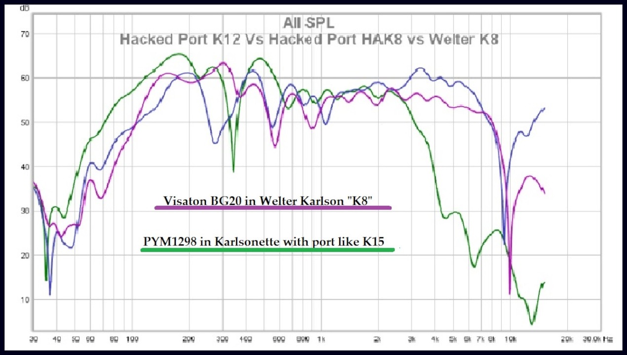

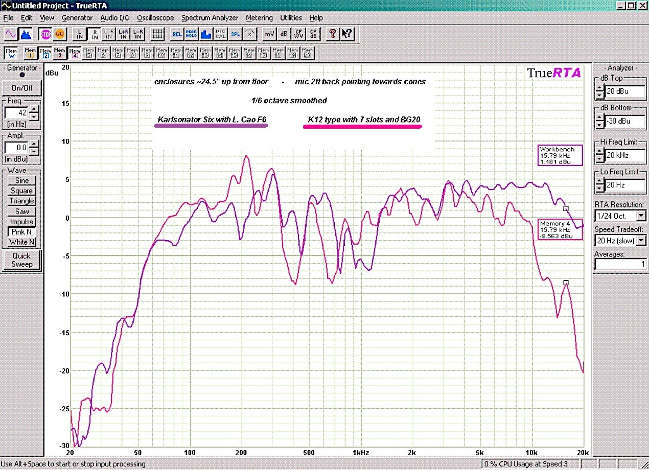

BG20 should load well in a Karlson K12 . BetsyK loaded very well in the first K12 (Karlsonette 1954) and could play loud with very little cone movement. BetsyK could benefit from a helper tweeter in Karlson applications.
FE206en needs no helper tweeter in K12/K8
A helper tweeter is needed for full brilliance with BG20 -it is too soft in balance -use something cheap but good like a TW51 type with 0.4-1o -1uF to roll in around 8KHz - perhaps varnish on the inside of the whizzer cone might extend BG20's treble a bit (?)
Thanks. I wish to remove the whizzer. It suppose to be better sound. I dont have any box yet. Bg20 need a big box to get down in the bass.BG20 should load well in a Karlson K12 . BetsyK loaded very well in the first K12 (Karlsonette 1954) and could play loud with very little cone movement. BetsyK could benefit from a helper tweeter in Karlson applications.
