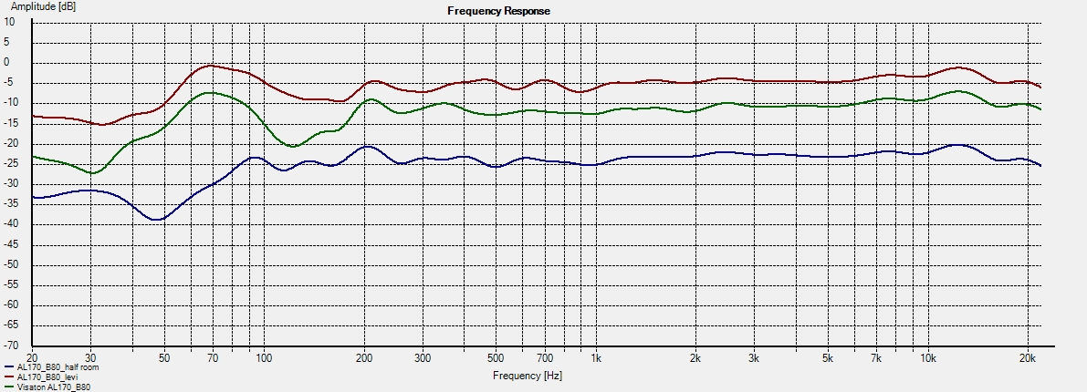

What is problem with 500Hz XO?
It will not make you deaf .. but will make a great driver play below average.. also, instead of flat 87 you'll get not so flat 83dB..Ideally I'd place the xo at 150Hz or lower. I know this is not optimal for the B80 but then... I'm sure the THD won't make me deaf 😉
You got all the measurements posted earlier in this topic..Any links to the CSD/THD measurements?
It's an XO (XOs are evil) and it is getting up into the critical band where they are easier to hear. I don't like XOs above 300-400 Hz.

The fact that someone does not like XO above 300-400Hz is no argument .. for a moment I thought I would heard something bright..It's an XO (XOs are evil) and it is getting up into the critical band where they are easier to hear. I don't like XOs above 300-400 Hz.

I've presented several reasons why the cut was made at 500Hz..

MKT capacitor are used for AL170, and MKP for B80..
All coils are on air.. with a thick wire can be achieved low resistance..

You missed the bit about above this being in the critical telephone band -- you get the distortions from the XO in that critical band ... and ideally at any XO point the centre-centre driver distance should be less than a quarter wavelength. Lower XO means that is more likely to be realizable

Distorsions from XO are negligible in comparison with distorsion from B80 below 500Hz..you get the distortions from the XO in that critical band..
..This means that a suitable midrange driver must be capable of reproducing from 150Hz to 6kHz with good efficiency and without significant colouration..vulejov: Here's the bright thing that you wanted to hear: BiAmp (Bi-Amplification - Not Quite Magic, But Close) - Part 2
..Many otherwise fine midrange drivers do not provide a wide enough safety margin below their recommended minimum crossover frequency, which causes resonances and other effects to colour the sound..
..'ideal compromise' will be different for every loudspeaker combination available..
If you use Visaton B80 with bass helper ideal compromise will be 500Hz..
Then it is absolutely impossible to make a two way speaker with 2-3kHz cut....and ideally at any XO point the centre-centre driver distance should be less than a quarter wavelength..
Without significant compromises yes (all speakers are compromises thou)
