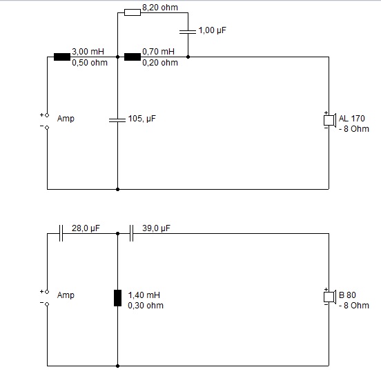

How did you deceide on distance beetwen drivers?

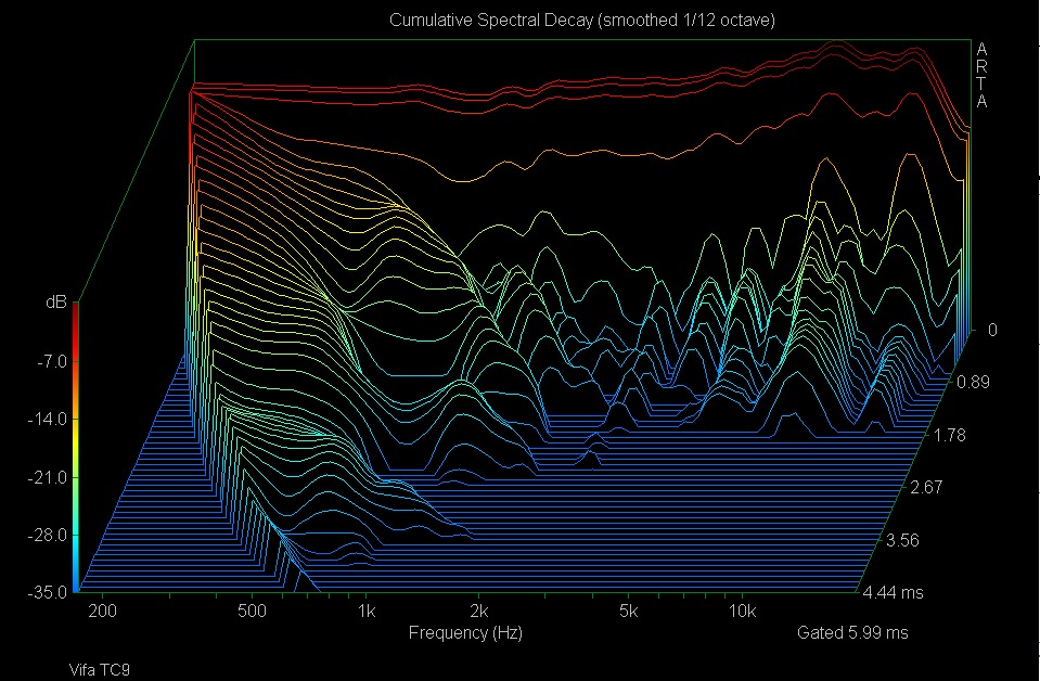

Sensitivity of TC9FD is 85dB at 2.83v about same as Visaton B80. HD is typically -45dB to -50dB from 300Hz to 10kHz at 85dB and 1m. Data presented for XO and IR earlier was just for the XO visualization. Spectrogram shows pretty fast decay and smooth response. Where do you see that the B80 is superior?
Visaton is faster, lower THD, but I agree that Vifa is not bad at all..
50-60€..

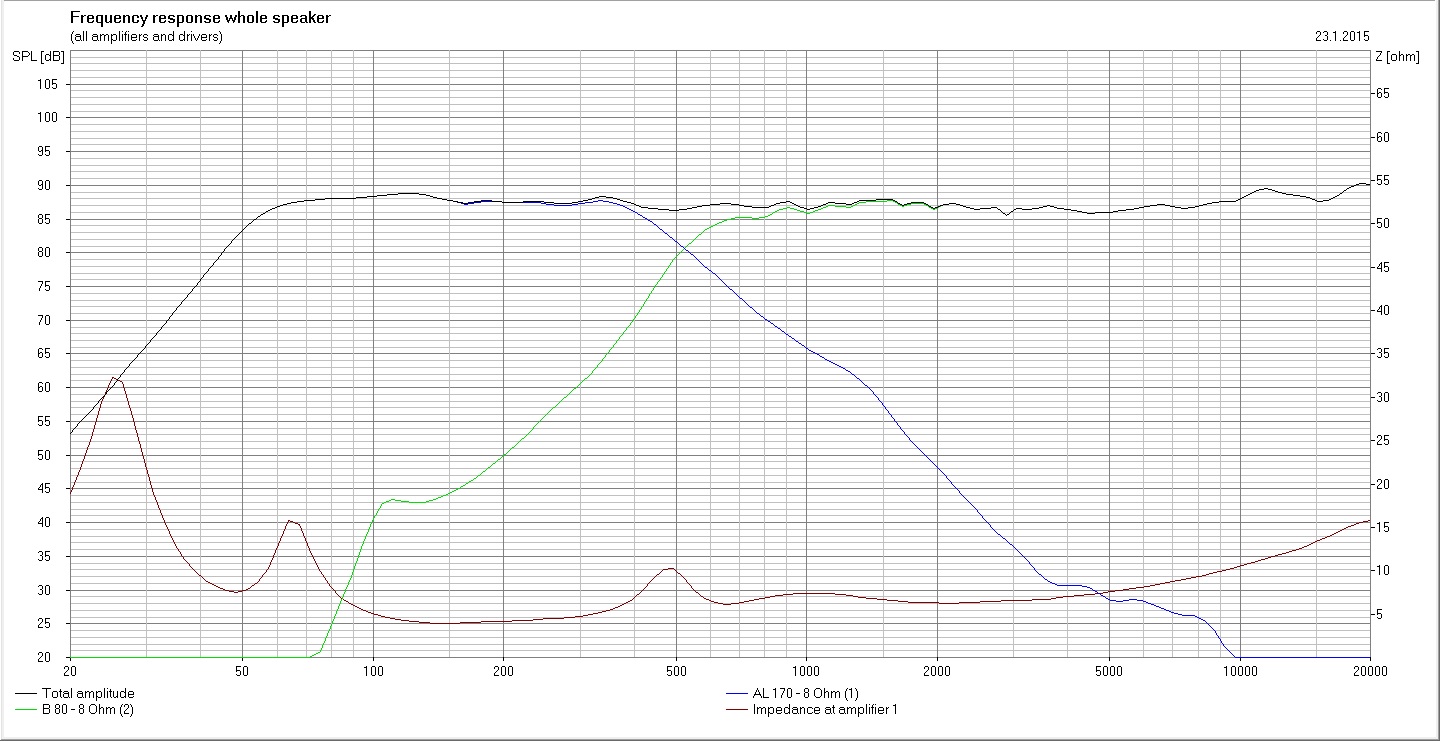

Boxsim gives very useful information about the placement of the driver to the front panel.. turned out that B80 has a flattest response if the plate is width 24cm or more, on a distance of 16 cm from the upper edge..

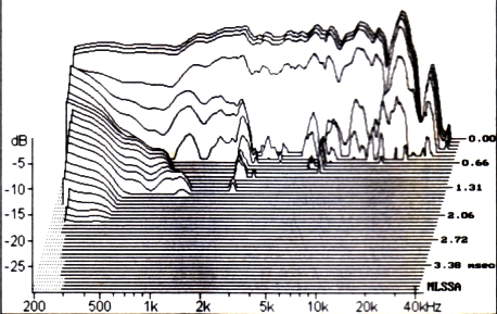

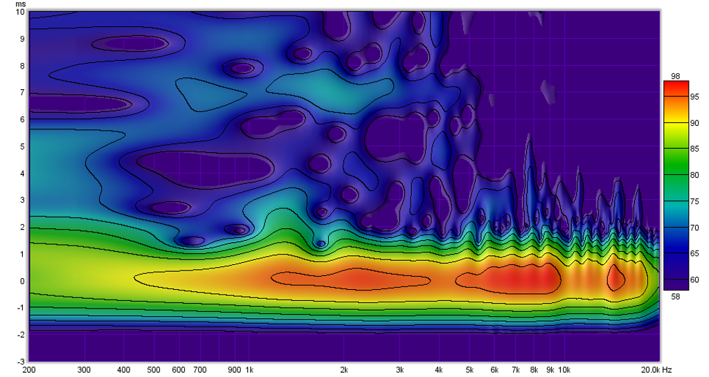

vulejov, thanks sharing your build looks really great and well tweaked. FR plots are very nice, for B80 or hole system do you have IR and minimum phase measurements you like to share.
That B80 does indeed have impressive CSD. And excellent system results as well.

Do you have waterfall diagram and THD measurements for TC9FD..
I chose the B80 because brilliant characteristics..
This forum yesterday nice member shared waterfall and THD for TC9FD this thread http://www.diyaudio.com/forums/full-range/268626-vifa-tc9fd18-08-best-bang-buck-2.html#post4200437.
