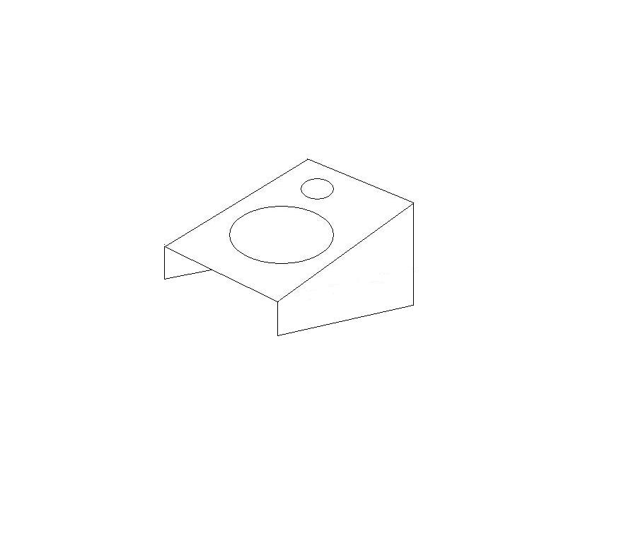

speaking of off axis
at the moment I enjoy listening to a very simple floor based omni
I plan to try it with Betsy

well, I did consider very carefully how to avoid compromises, and still kept simplest possible, and small
but it seems like the close coupling to the floor has some advantage
well, at least its cheap and easy to try it 🙂
very low ""show" factor
but maybe high WAF factor
might even be "multi place able"
Now I think about it again, maybe it could be mounted on a wall also
might be used in low power surround, etc
whatever, mine will be 2way, with 2" alu cone tweeter
but thats a different story
