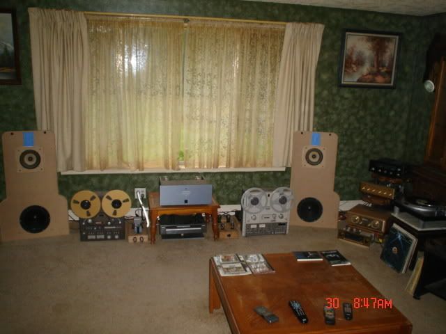

Hello Vix,
Can you eliminate the U frame, sounds silly, but all this OB stuff is highly effected by such a frame. I would try your speaker combo's on flat baffle only.I am not a big fan of U frame of wings. Magic goes out the window fast & I think you will have better luck integrating. Bass integration again has never been aproblem for me as long as it is OB bass I am dealing with & bi-amping. Wings have allways caused problems for me though. Try it all on flat baffle with that bass driver slammed to floor & the B200 at ear highth..18" on the B200 seems very good & go wider at the bottome of baffle & bi-amp w/ active 4th . NO XO on B200. I Only time I had bass interetion problems was trying ported subs for help, but never with OB bass on flat panels. Wings & U- channel make drastic changes in OB behavior. Good luck..Don't give up. All worth it in end. You will never go back....
JandG said:Hello Vix,
Hard, but not impossible. I may do that. Since it doesn't sound good as it is, I am not afraid to risk.
Thanks,
Vix
Try a simpler setup
Hi Vix,
I think JandG made a good point regarding removing the U-frame. My own experience agrees with his observation that a U-frame can have quite detrimental effects on the sound of the speakers. If the side wings extend all the way up to the top, the openness of the OB sound is lost, the soundstage collapses, and even the tonal balance changes. The differences can be quite drastic. Many people doing OB might not appreciate how big a difference a small change to the baffle can have on the sound.
To get a sense of the potential of the Visaton B200 driver, I'd suggest that you put them on a simple flat board of a decent size, like 32"x48", run them fullrange and add a box subwoofer for the bass. This should give you a flavor of how the FR driver on OB should sound like. If the sound is promising, then you can add OB woofers to the same baffles. I'd use an EQ (a cheap analog prosound unit will do just fine) on the bass signal to generally dial in the needed boost (not to compensate for all the peaks and valleys, mind you). Once you get the satisfactory sound, this will become the "reference" sound of what the FR+woofer combination can do. From there, you can try to change the baffle configuration, such as using a U-frame, or make other changes, but I suspect that most changes you do to that simple system will only make it sound not as good.

It will be very interesting to read what Vix comes up with. Rudolf knows his OB stuff, so that's the first thing I would try. Find out is it's a room resonance.
I do find that small side wings help, but those that Vix has are both tall and deep - and they look like they are identical left and right. Is that true?
My experience has been that small side wings really help the lower mids - I like them. But it seems best to taper one, but not the other, or at least make them of different widths. Asymmetrical is the key.
Kurt, I liked the look of your acrylic OB's. Really nice. Thanks for the tips.
Panomaniac, there are two things that come to my mind:
1. Remove one wing on each OB (not very pretty- and the whole thing becomes unstable)
2. Drill some asymmetrical (zig-zag) holes of various diameter 50-180mm starting from top to bottom of the side wings. May not look that nice, but it will acoustically "remove" the side wings, while preserving mechanical stability of the baffle, and it will also break the symmetry....
Vix

Vix,
Thanks for the kind words about the acrylic OB's.
Before you start to cut holes on your U-frames, you can try using deflection panels to change the shape of the back "cavity" of the U-frame. Just cut some cardboard pieces and tape them at an angle to the wings to cover up the corners. I've used such deflection panels to good effect when I tried a U-frame at one time. The deflection panels restored some of the openness and the soundstage, but ultimately I decided to do away with the wings.
Best regards,
Kurt

Vix said:Hi,
After a lot of contemplation and buggin' people with various questions, a lot of blah blah...
Finally I did it. 🙂

I've changed some things here and the end result seems to be a bit better....
1. Replaced the NAD 3020, which used to serve as a bass amp for the Betas. I got a second-hand Sony TA-N511 power amp. Now the Betas can move! They sound much tighter.
2. Fiddled with the active crossover again. It is now active first order, bass at 150 Hz, and Visatons at 330 Hz.
The result is:
I found a way to make these listenable, albeit at two "modes:
1. "Normal" mode: This is for everyday listening at a moderate volume. Visaton B200 works in full range (closed switch over a high-pass capacitor at the input of the amp). Bass amp (Sony) is turned off, so Eminence Betas do nothing. This setup sounds nice and pure, and although there's not much bass, the rest is fine.
2. "Loud" mode: This is when I want it to "rock". and drive the neighbors crazy. Visaton is high-passed at 330 Hz,(open switch at input capacitor). Sony amp drives Betas full steam. Although I don't like the sound qualitywise, it is capable of decent SPL and very concert-like sound...
