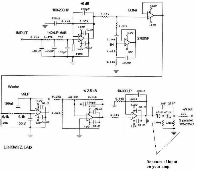

Thanks a lot for the support and advices. Yesterday I was too tired of trying all those combinations. In the end I just wanted to relax and cool my head
. So today I tried again, and here is the combinations that seems to work best:
1. Visatons high-pass 1st order at 80 Hz (just a small cap in front of the Zen V9 amp. By the way I also use Geoff's PLL filter to smooth Visaton's peaks.
2. Eminence Beta: low pass at 60 Hz 2nd order. I used low pass from Rod's circuit:
http://sound.westhost.com/project81.htm
Amplified by NAD 3020
Then I used a 3.3 mH choke in series with Betas. Inverted polarity at the Betas. ( If I am not mistaken Zen V9 also inverts phase, so I've reverse-connected Visatons as well)
So far this combination sounds best (although bass is still a bit flabby)

Hi Vix - sorry to hear that these are giving you so much trouble.
I've been there, done that. About to do it again. It's not easy.
Like your open baffle, you're going to have to think "outside the box" for your crossover. Forget what works in a box, this isn't a box.
To get that Beta 15 to sound right on open baffle you are going to have to trade away massive amounts of efficiency. Maybe as much a 10dB. Just as Martin stated earlier.
For this combo I would start with about 15mH on the 15 inch and about 22uF on the Visiton. Yes, you read that right. You'll also need a big series resistor in front of the Visaton to get it to level match the Beta 15.
That will get you close, then you can play with a cap and maybe a Zobel on the 15" and fine tune the cap on the Visa.
If you can biamp, then it should be a lot cheaper to use a PLLXO in front of the bass amp. Big inductors are expensive. Once you find the input impedance of your amp, design your PLLXO for a -3dB point of about 90Hz. What this will do (same for the big inductor) is to push up the bottom end of the 15s response. You really need that because you have no box. The 15 will continue to contribute a lot way up, so you are crossing the Visaton much higher than you think you should. But don't worry, it will continue to contribute plenty down below the x-over point.
I know this sounds all wrong, but give it a try. It will get you a lot closer than you are now, and maybe give you the encouragement to go further into fine tuning when you hear that the 2 drivers will actually work together.
