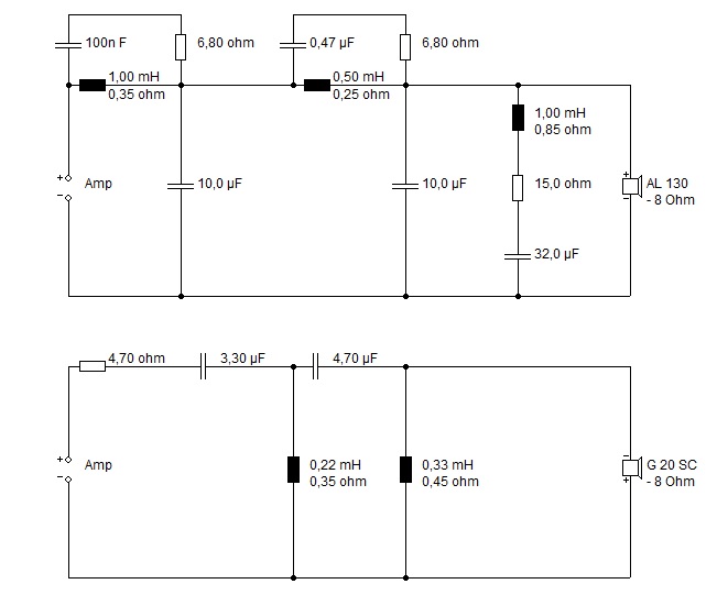

From experience, I don't mind complex crossovers at all. 4th order tweeter filters sound excellent if you accept the 24dB/octave LR4 sound. vulejov has done a meticulous job here. Sure they are harder to fit in a small space and cost more money usually, but think of a fourth order as a DISTRIBUTED filter and it makes sense. Instead of a single 2.2mh coil and capacitor, the bass uses two smaller coils and two smaller capacitors and gets steeper. Why should that sound worse? In fact it sounds better IMO.
The only real reason to use simple filters is COST IMO. Not quality. And a metal driver is an awkward thing at the best of times. It needs steep to tame the ringing. Try 12dB/octave LR2 with drivers with less issues. 😎
vulejov did a wonderful job here. I agree with what System7 said here.
It is possible to use simpler crossover if the woofer is paper cone and the tweeter can go much lower. vulejov optimized the network for the drivers he has chosen.
Thank you..It is possible to use simpler crossover if the woofer is paper cone and the tweeter can go much lower. Vulejov optimized the network for the drivers he has chosen.

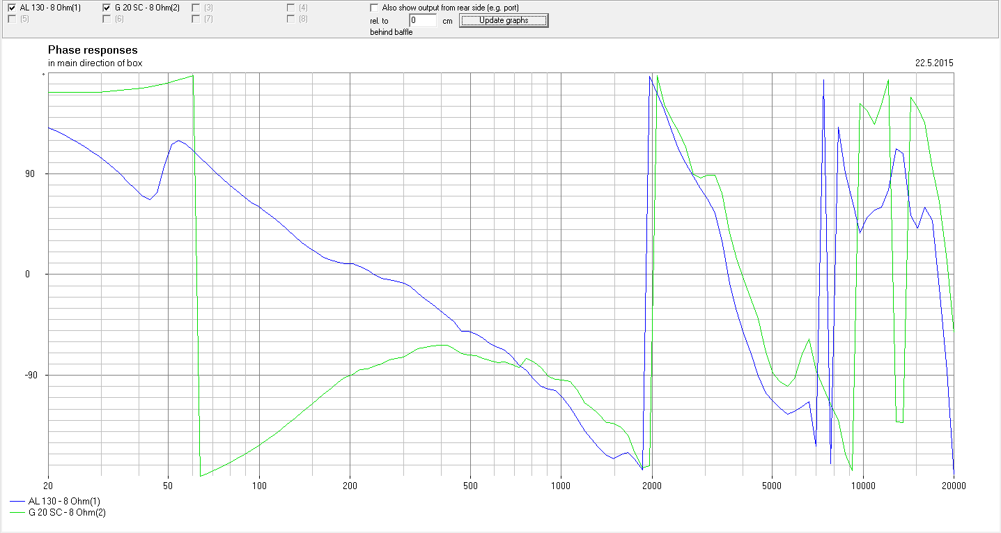

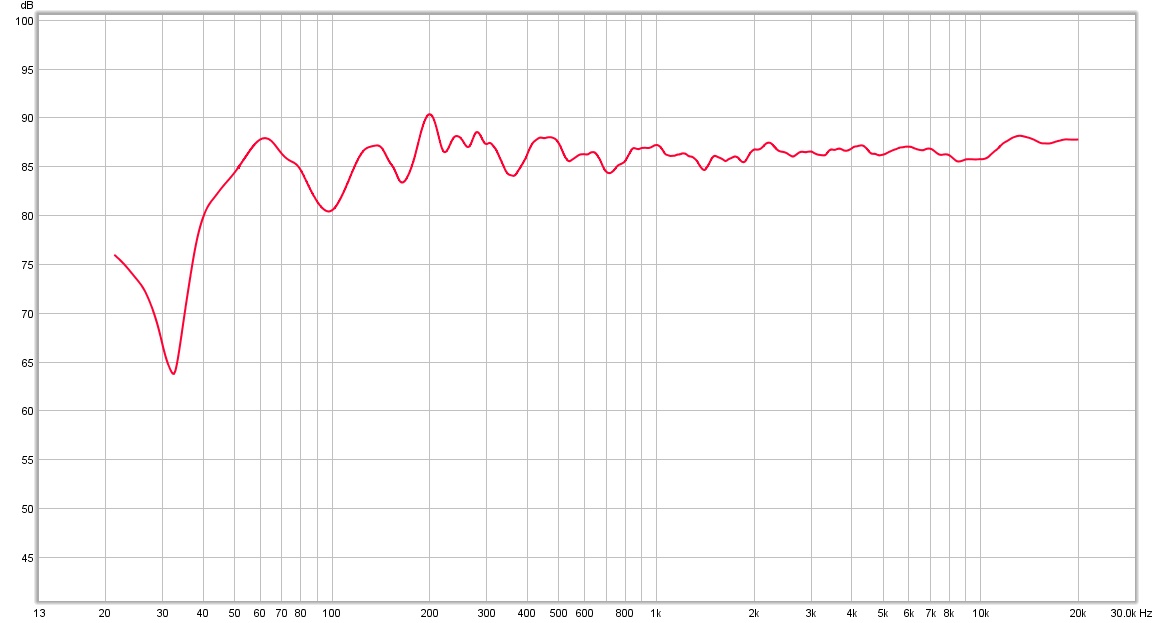

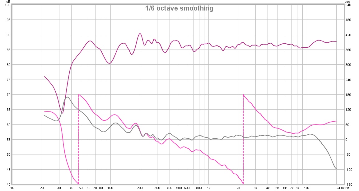

Looking at the 94mm Visaton G20SC:
G 20 SC - 8 Ohm
I'd think almost any tweeter with a 1.8kHz Fs is going to look similar.
H0737-08 19TFF 1
Maybe 2dB quieter. FR just the same. So you'd just take out 2R of attenuating resistor. Not hard.
G 20 SC - 8 Ohm
H0737-08 19TFF 1
