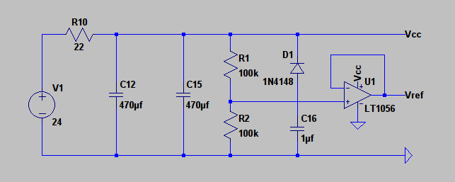

Thank you for providing the VG1-circuit.
It might be an option for my analog active crossover in a mobile system.
My next project contains 5 dual opamps (maybe it turns out to be 6).
I have quite a list of (noob-) questions:
1.
In the situation where i use single supply class d amps i create virtual ground with the method you can see in the attached pic.
It is quite a simple rail splitter.
What are the main advantages of the VG1 circuit over what i use?
2.
For another system which works with higher voltages i use two 9volt batteries with a center tap.
What are the main advantages of the VG1 circuit over that kind power supply?
3.
What kind of decoupling for the opamps is advised when VG1 is used?
4.
When using two 12V sla batteries the actual voltages that occur during normal use are between 26V and 24V.
My guess is that 5.6K works for R1 and R2 in the VG1 circuit, right?
What type of resistor would be best (metal/carbon, wattage)?
5.
With one or two class d amps on the same supply rail...
Should a LC-filter (maybe 2nd order) at the input be taken into account?
6.
Regarding the capacitor values of C1, C4, C5...
The high quality caps i have in my stock are all chemicon
KZN 2700uF 35V
KZN 4700uF 35V
KZE 470uF 25V
PSG 390uF 25V
PSG 330uF 25V
Which would you advise me to use in which place?
Are the 25V caps a no-go in my case?
7.
Are the 1N4001 in my stock a substitution for D1, D2?

In case of catastrophic failure (or wildly asymmetric power-on / power-off), D3 prevents the voltage between +V and Ground from going negative. D4 prevents the voltage between -V and Ground from going positive. The idea is to protect downstream circuitry against reverse bias that might destroy components. For example, Tantalum capacitors.
If your system can deal with the much higher leakage currents of Schottky diodes (see the datasheets, it can be milliamps), using Schottkys for D3 and D4 yields greater protection.
