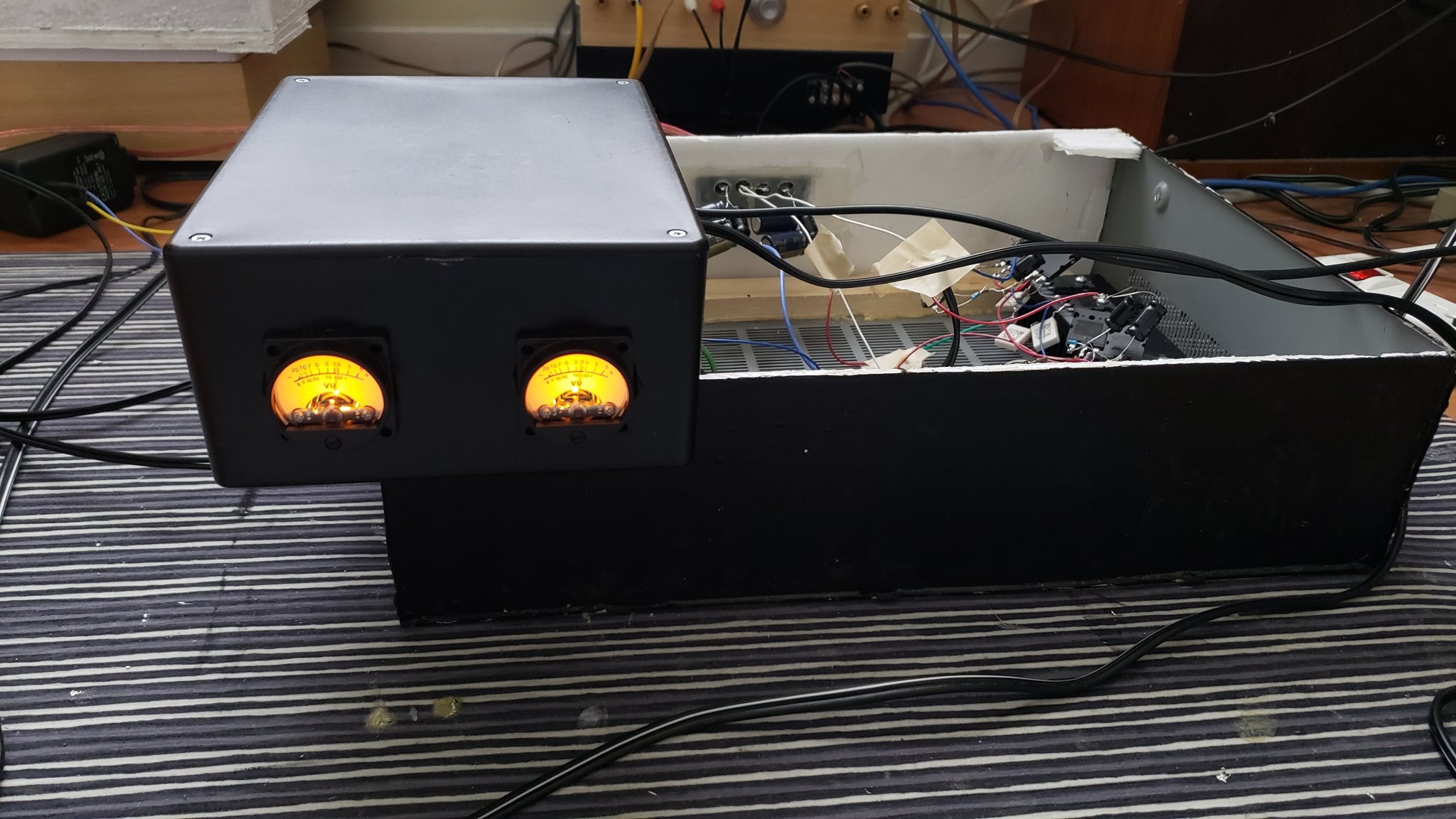

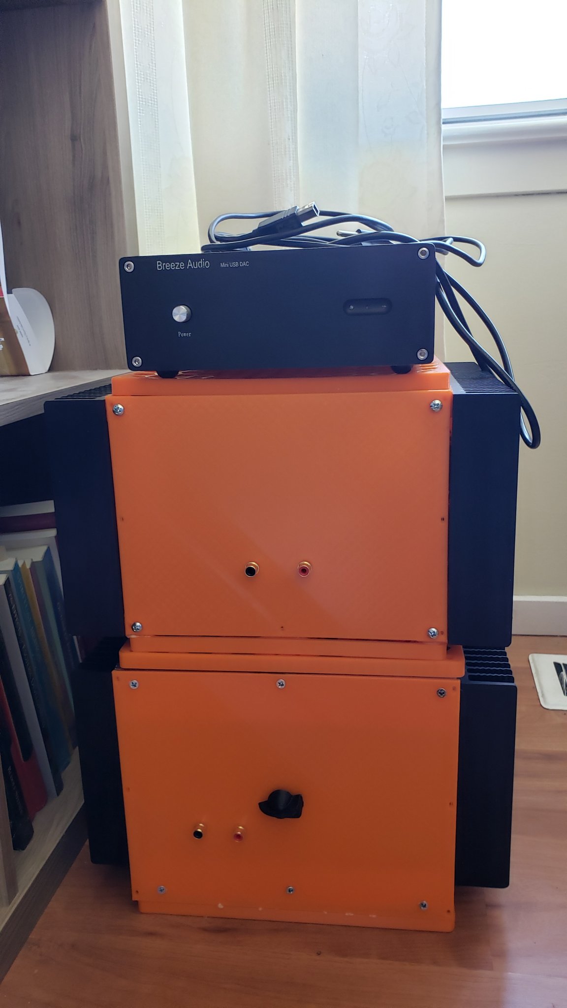

I put those cute VU meters in the case, love the vintage look, reminds me old revox stuff.

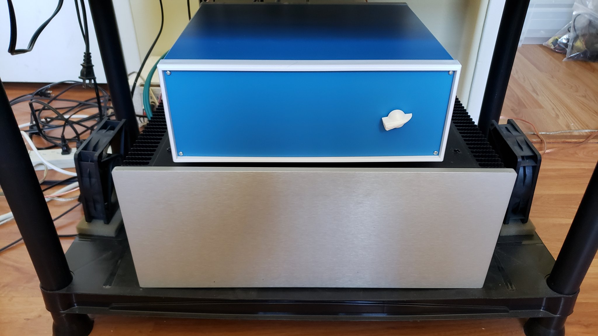

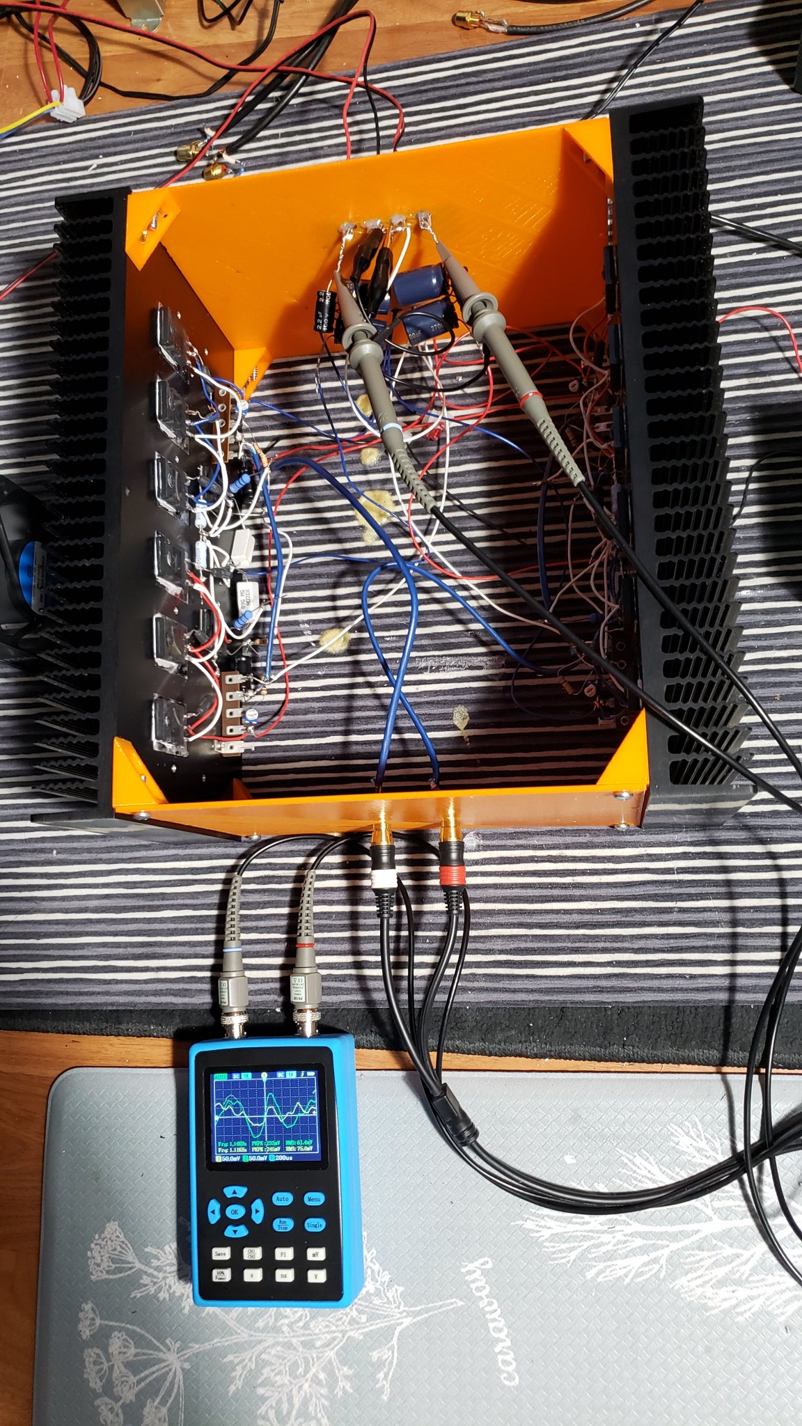

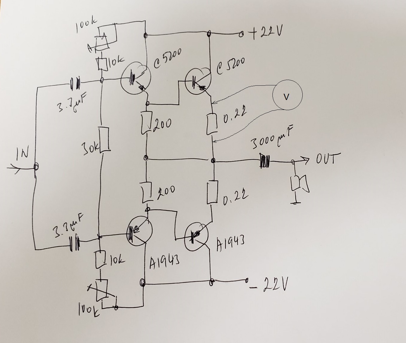

That ugly box below the vu meters is my c5200/a1943 buffer. Decided to put it in the box, since it sounds wonderful. Its only one pair of outputs only biased moderately based on small heatsink, but i decided to finish it for now. I am building next generation with three pairs of c5200/a1943, each pair biased at 0.5A, driven by another pair of c5200/a1943. Waiting for heatsink.
Good to know. Exploring buffers and low gain amps at the moment and thought about the cool/hot follower from Andrea Ciuffoli.
Decided for Nelson´s simple follower as a start though which I still haven´t fired up (active setup, amp is for compression driver).
Made a couple layouts for these amps but will eventually just stick with P2P wiring as it is simple enough to do.

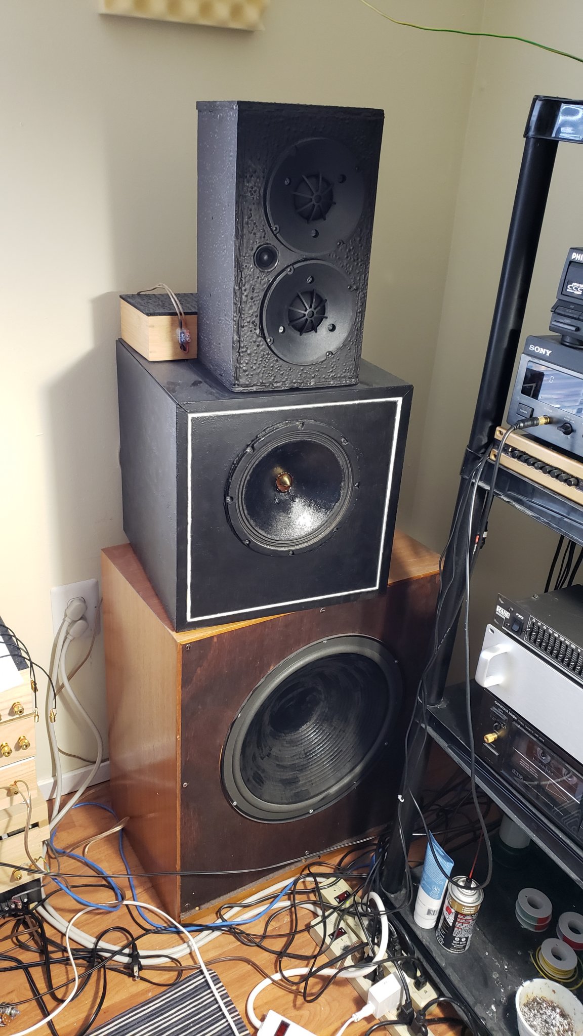

I saw you using those old philips mid-range speakers in a early thread. I used them years ago they blew up. I replaced with morel mtm55 and they solved my problems. They get crossovered at 700Hz, with a 15” in a sealed box and a morel tweeter at 3k
