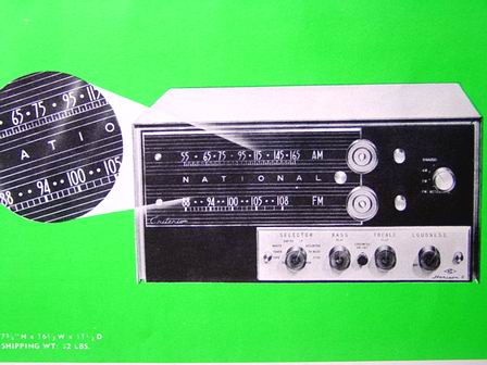

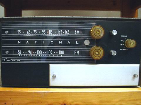

If you're looking for a very good vintage (mono) tube FM tuner and can't afford a $1,500.00 REL Precedent there is a "sleeper" you can buy dirt cheap on ebay: The NATIONAL CRITERION. Ugly and bulky (National made big communication receivers) but an outstanding performer. (One of the most sensitive tube FM tuners ever made). Will far outperform any QUAD or LEAK tube tuners. Strange "futuristic" (then) look you'll love or hate. Usually sells for less than 70 $ on the well-know auction site,which is a real bargain.

Howdy Tubeologic, Sounds interesting, any photos?

Here it is... The blank plate at lower right was for the (optional) Horizon 5 preamp module. Sensitivity was quoted by NATIONAL as 0.5 µV for 20 dB quieting and capture ratio 0.8 which was (and still is) exceptional for a tube tuner. Don't know if these specs were really met but this tuner performs very well even with a short wire indoor antenna. Complete review can be found in the September 1955 issue of RADIO-ELECTRONICS.
