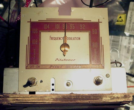

jackinnj said:FM Tuners don't get much more vintage than this Pilot model:
Very splendid. However, it's not a proper radio unless it claims to be able to pick up "Hilversum".
