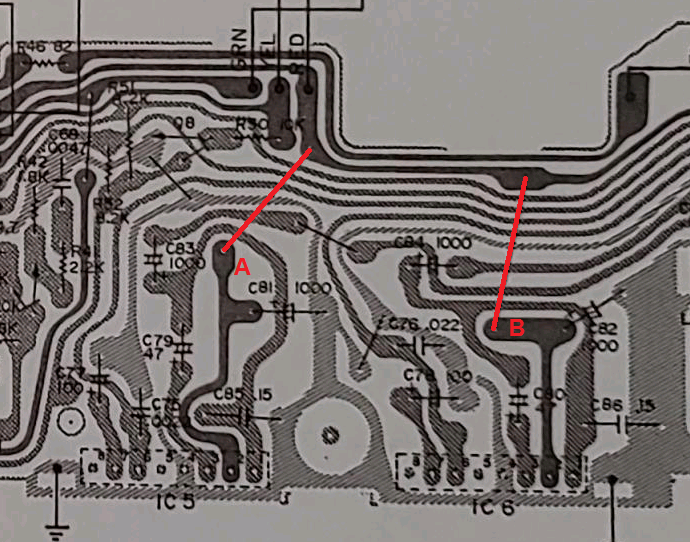

You don't need to remove the chip amps, just isolate the jumper wires I have highlighted in red at A and B and check the operation of the radio section by connecting headphones across the volume control.I know I've asked this, but I am wanting clarity on specifically what you want me to do. Do you want me to:
1. remove the IC and test for heat, or
2. remove IC, bend pin 2 out of the way, solder it back in, then check for heat?
If all is good then proceed to diagnose which amplifiers are dead by connecting speakers and briefly reconnecting jumper at A OR B BUT with tail light parking bulb in series with the 12V supply.
Faulty amp will draw excessive supply current and cause the lamp to glow brightly even with volume control at mute, this is safe way to diagnose.

So shame on me for not following proper diagnosing advice and procedure. I have a couple spare MB3713's I ordered and replaced the one getting hot out of curiosity. Now, it doesn't get hot, plays audio at low levels, but as soon as you increase the volume from low to medium, the popping comes back. At low levels, I tried balance control and the tone control, and neither one did anything. I still need to pull the caps and check them in the output section. I shall dig around for a bulb and hook it up as a DBT to ensure it isnt drawing excessive current.

To be frank I am tired of you not following simple directions and lack of civil manners.
Connect a headphone driver or small PC amplifier/speakers across the volume control outer contacts, connect a suitable car antenna and you should have FM hiss or AM noise.
No balance control suggests loss of earth connection to bal pot, no tone control suggests loss of earth connection to tone pot which would be unusual, broken wires ?.
So, do you have line level audio between system ground and each of the two balance control outer pins (or vol control input pins, see schematic) ?.

We already know the FM signal is getting to both IC's as confirmed with a scope. The first issue was that the dead channel's IC was getting hot and was producing loud popping noises. Yes, I should have used a DBT to ensure no damage was done to the radio, and to see if there was a short somewhere. Shame on me. I replaced the chip IC and it no longer got hot, indicating that the bad IC had an internal failure. However, the popping is still present.
