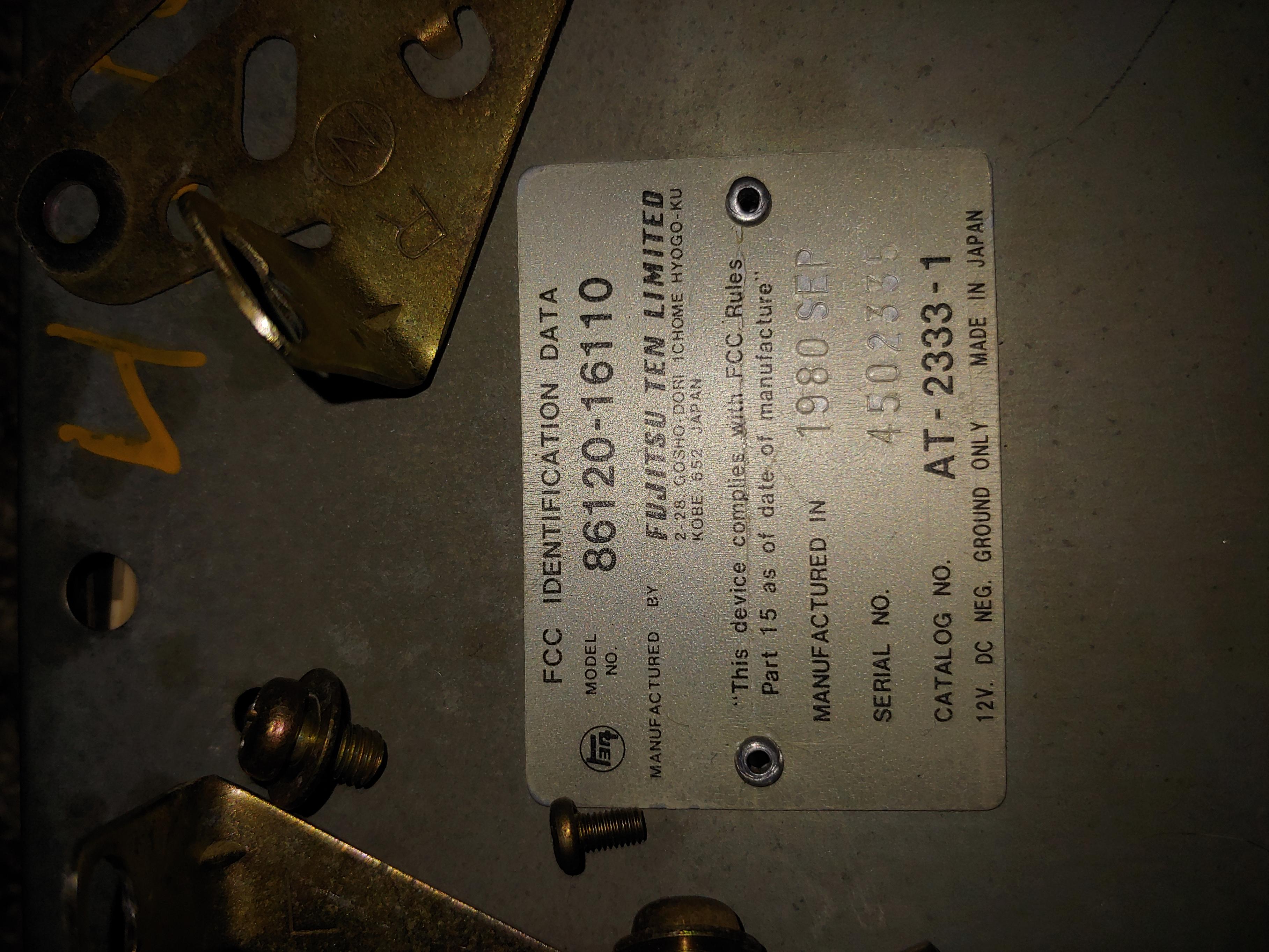

Alrighty, update time!

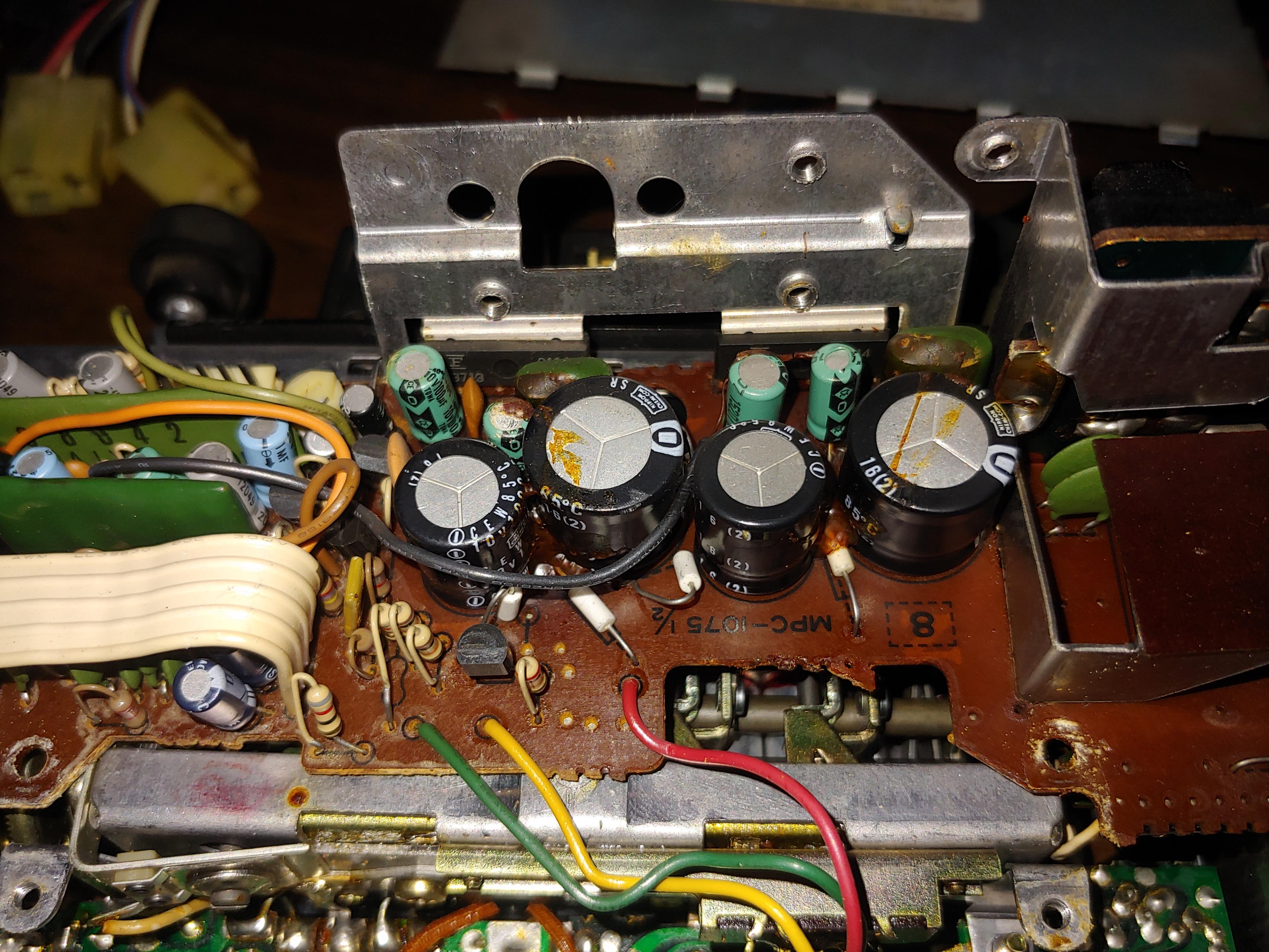

Got my capacitors in today. I opted for nichicon gold caps, and replaced the 4 electrolytics in each of the output sections of radio 1. Screwed it back together, both channels work, and the tone and balance controls both vaguely do what they are supposed to do. I'm not really too worried about that as I'm mainly trying to get them to output audio, not restore them.
Time for radio 2. I desoldered the same electrolytics, replaced them, along with the output amps. Since I don't have an auto bulb handy, and all the stores are being finicky about when they are open, I used the 400mA setting on my meter. Using radio 1 as an example, the power draw is ~360mA. Radio 2 is ~340mA. Seeing as there is no short, I connected power to it and a speaker. No output, no FM stereo indicator.
I checked the voltages on both output amps against what the manual calls, and they were all in the ballpark voltage. Some where a bit higher since I think the manual is using a +12v power source, and I am using a +13.8v source.
Going from there, I checked the voltages on IC1, IC3, and IC4 since they all appear to deal with the FM circuit. Most of the voltages are close, but some are off. Im not sure if that has to do with my power supply, aging parts, or failed parts.

The balance control should cause full mute of one channel at each end of travel, tone should be smooth changes.Screwed it back together, both channels work, and the tone and balance controls both vaguely do what they are supposed to do. I'm not really too worried about that as I'm mainly trying to get them to output audio, not restore them.
You should have Power lamp PLUS AM lamp Or FM lamp that's before any Stereo lamp, look at wiring on switch S2 (AM/FM switch).Time for radio 2. I desoldered the same electrolytics, replaced them, along with the output amps. Since I don't have an auto bulb handy, and all the stores are being finicky about when they are open, I used the 400mA setting on my meter. Using radio 1 as an example, the power draw is ~360mA. Radio 2 is ~340mA. Seeing as there is no short, I connected power to it and a speaker. No output, no FM stereo indicator.
Sounds correct..I checked the voltages on both output amps against what the manual calls, and they were all in the ballpark voltage. Some where a bit higher since I think the manual is using a +12v power source, and I am using a +13.8v source.
You should get a turn on thump in the speakers upon power up, if so you can then probe input pins with a disconneted meter probe and inject hum/buzz to check the amplifiers (vol control at max).Going from there, I checked the voltages on IC1, IC3, and IC4 since they all appear to deal with the FM circuit. Most of the voltages are close, but some are off. Im not sure if that has to do with my power supply, aging parts, or failed parts.
Any thoughts?

Well....if I were to diagnose this, where should I start checking on the controls? The pot that has the tone control is attached to a pcb, and the balance I believe is just screwed to the face since it has the tuner control attached to it.The balance control should cause full mute of one channel at each end of travel, tone should be smooth changes.
My apologies for not being clear and concise, the FM and AM lamp do light up when switching between the modes.

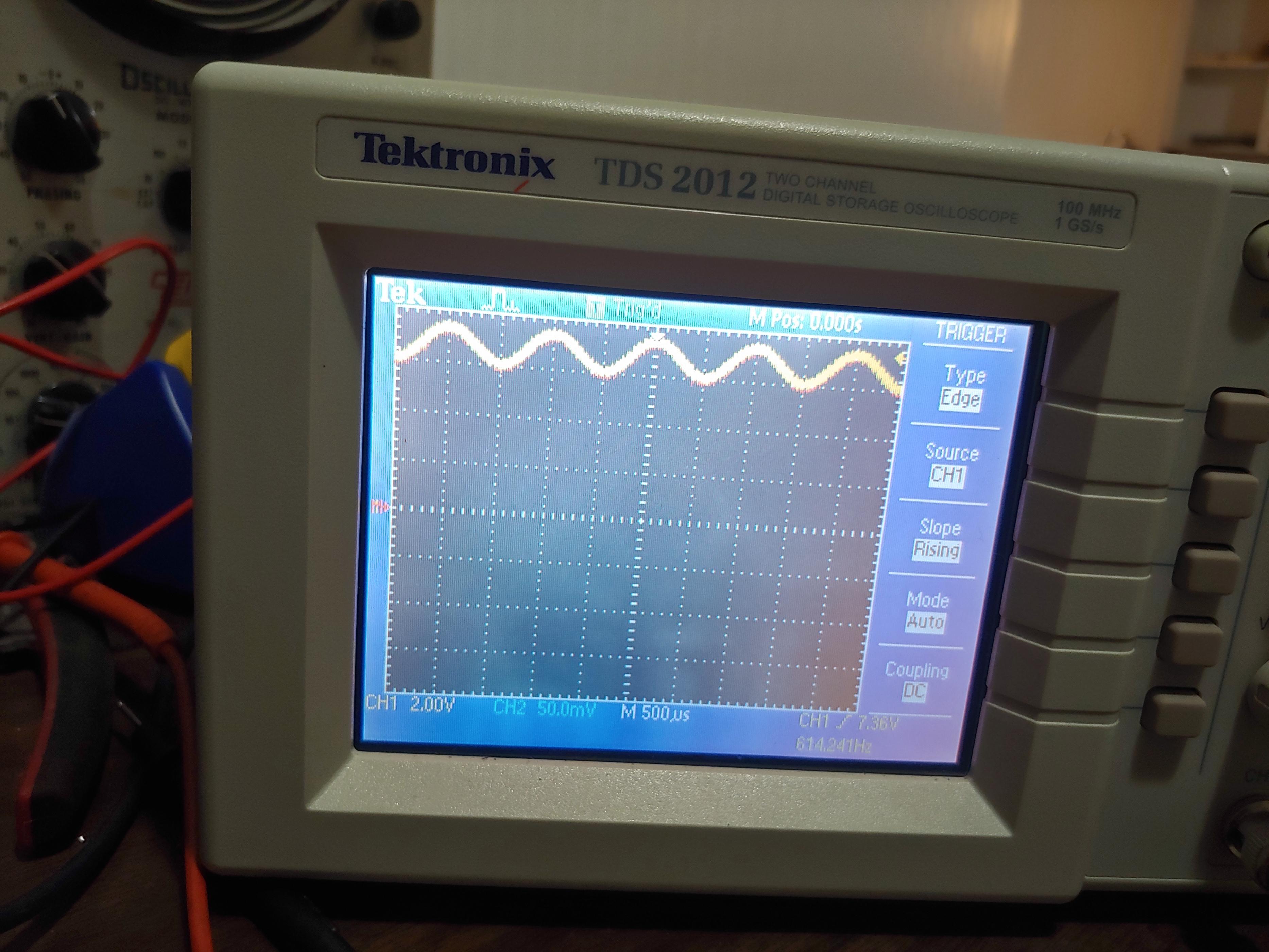

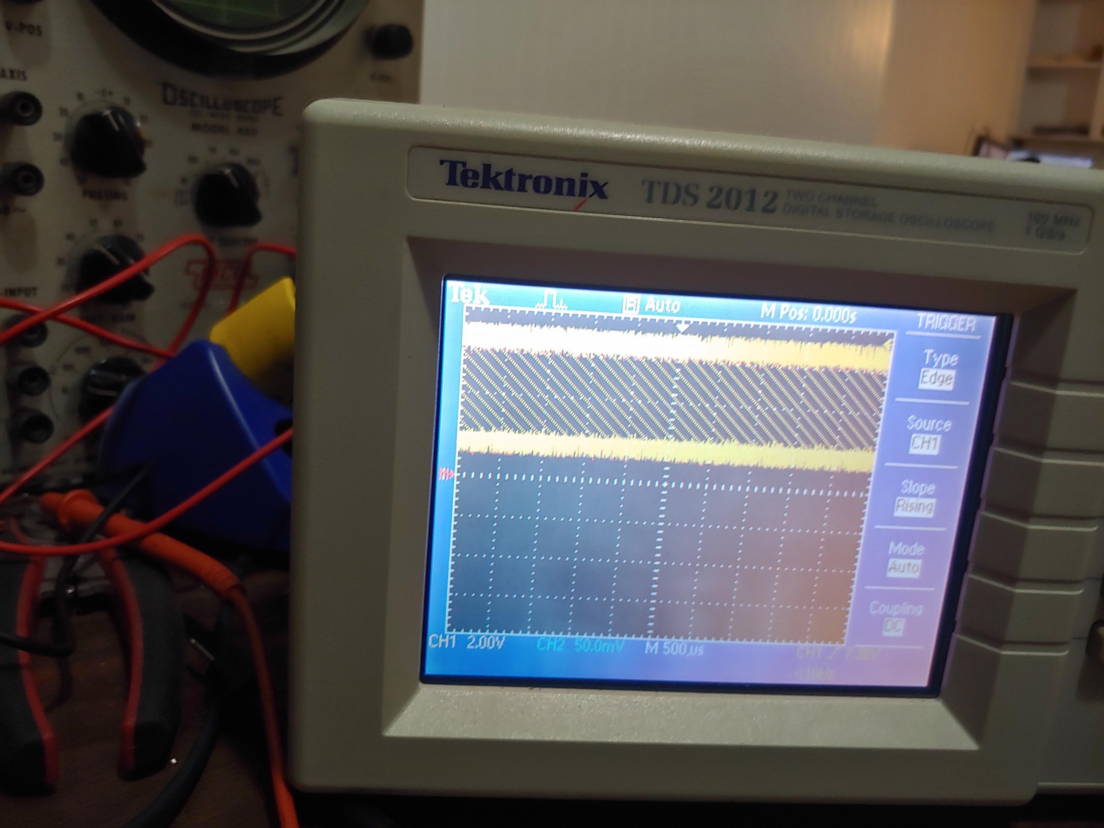

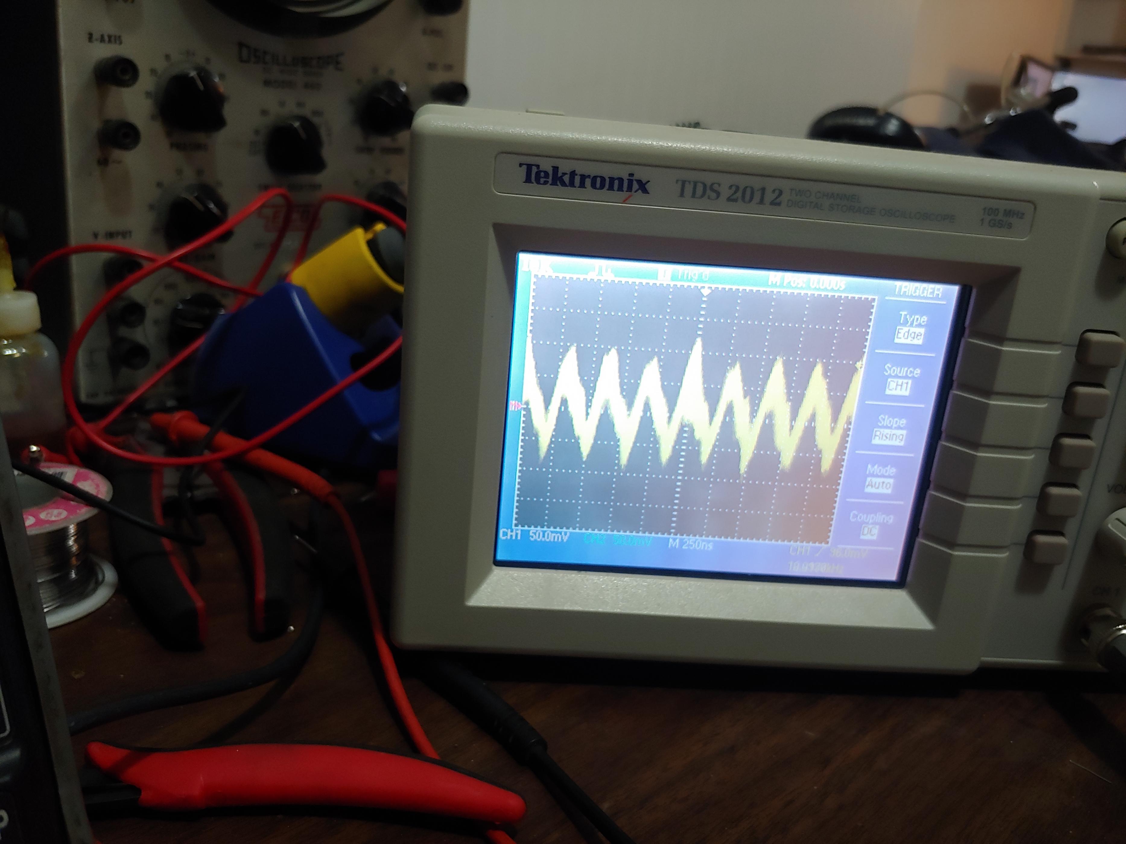

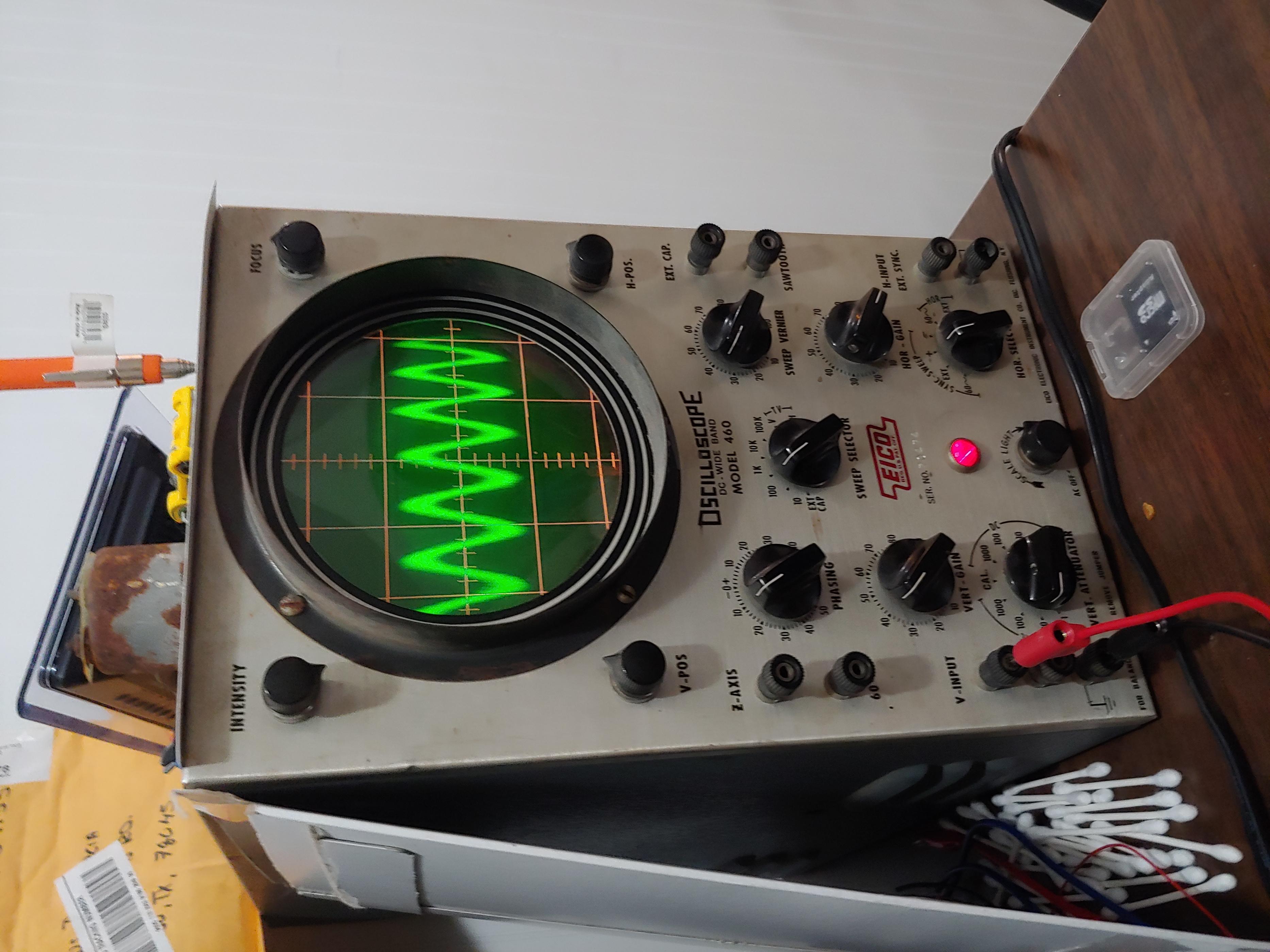

Just a small update--
I went to start testing for signal last night using the silhouette of the circuit board in the service manual as a guide, and turns out, aside from the amplifier portion of the circuit, nothing else lines up. The volume / tone control board is different, fm radio section different, etc. I tried measuring the resistance across the pots to see if those were even the same, and they were no where near the 20k ohms that the manuals calls out (they were around 5k? Ill have to measure from the top of the pcb to ensure I am checking the correct points).
Are the pots marked for value?
The pots are connected to other components which will skew the readings in the circuit.
Again connect a headphone between ground and one end of the balance pot with the bal pot centered, you should have signal of some sort, ditto with the volume pot.....it is not difficult.Just a small update--
