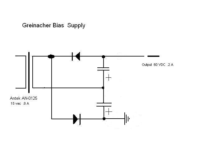

I attached an edited diagram. Is the orientation of the diodes correct?

No adapters or PCBs, please. The circuitry is simple enough to make point to point wiring easy enough.
If you are lucky, your JJ EL34s are old enough to precede the Octal woes that have set in. If they give you trouble, buy EH "fat bottles" from McShane. Of late, JJ = Jamona Junk. 😡
The bias supply schematic is correct. However, the rail voltage will be approx. 78 V.
Eli,
I would rather do Point to point anyway. Big clumsy fingers. So for Greinacher AC x 5.2 = DC? In that case a 10 volt transformer would be plenty? 10 x 5.2 = 52. Since the spec is only -34 volts.

For any cap. I/P filter, the rail is (VRMS) (21/2), LESS LOSSES. For the Greinacher circuit, (VRMS) (2.6) is a reasonable approximation.
The bias tap on the Dyna power trafo is at 55 V. The bias rail will be about 70 V. I want to have at least that much available. Greinacher doubling 24 V. will not get there. Use an AnTek AN-0115 in each monoblock.

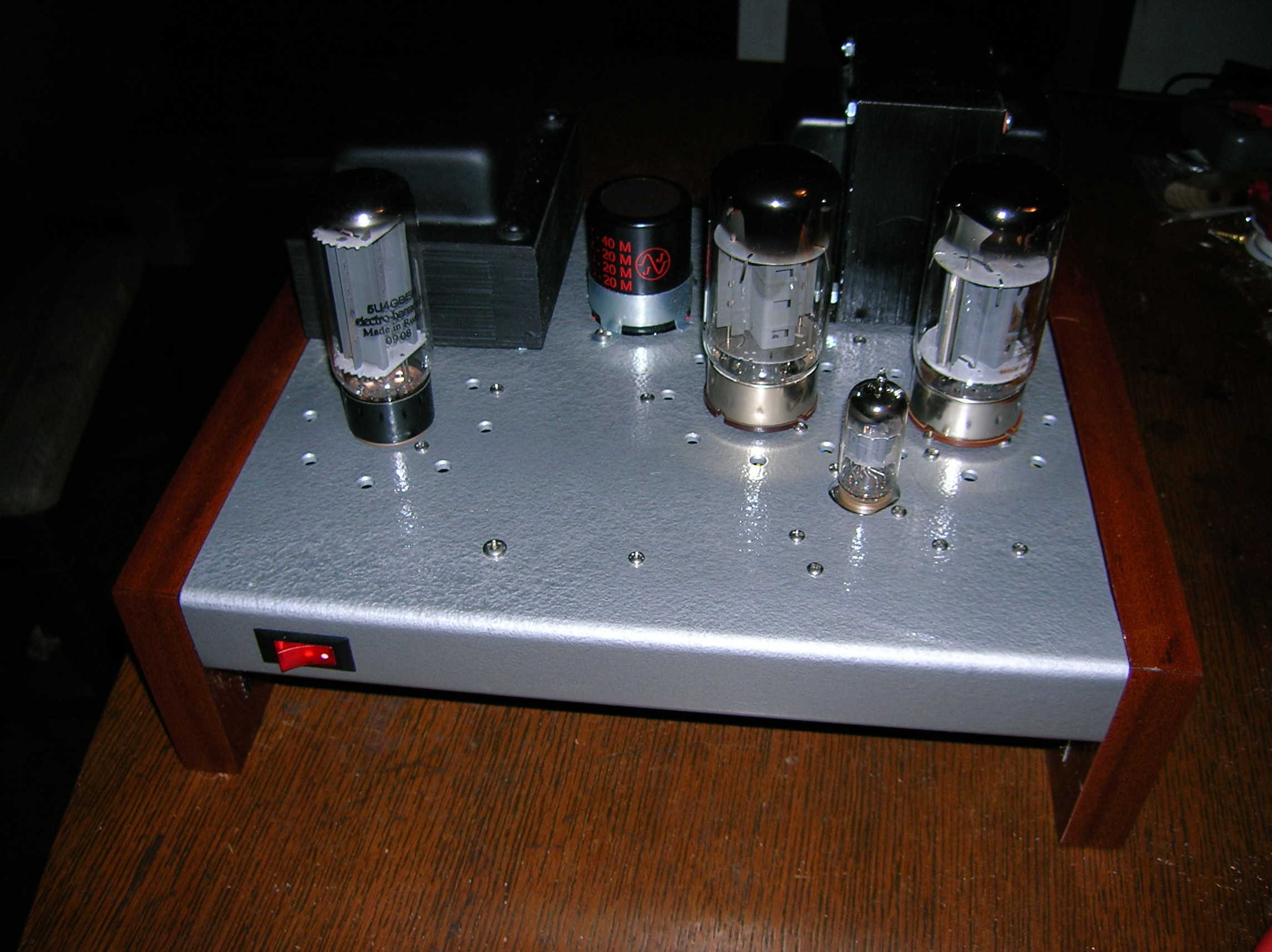

Evening All,
I finished the first Mark II/III, I attached a picture. On my scope the amp starts to clip the top of the wave form at about 64 watts. Below 50 watts it produces well over a 100db on my homemade 12" three ways. (I won't hook them up to the Snells till I've finished the second amp and have played them for a while.)
Meanwhile I think I may have found a use for the Motorola console OPT's. In the Dynaco transformer catalog (down-loadable from Triode) there is the "Low Power High Quality...Amplifier" (figure 3 schematic). It is a beautifully simple amplifier. One 5y3, one 12AX7, and two EL84's.
I think it would be cool to build a pair on a single chassis using a single CD phono input and a dual pot level control for the input to control volume.
The schematic calls for the ultralinear Dynaco A410 OPT. My Motorolas don't have an ultralinear connection. I have seen amps run in triode mode where the output from the screen grid is combined at the OPT end connections via a 100 - 500 ohm resistor. How can I determine the value for this resistor?
And thanks again for any suggestions you might offer, Kevin
In large measure, the value of the resistor used to tie g2 to the plate is governed by the toughness of g2. The screen grid in EL84s is quite tough and 100 Ω will do. However, since you are going triode mode, wire the sockets for the 6П15П (6p15p), AKA SV83, AKA EL84N, using 1 KOhm resistors to tie the screens to the plates. Sockets wired for the 6П15П work with it and the EL84/6BQ5. 6П15П-EB (ep15p-ev) stock makes a very good sounding triode.
BTW, the low gm 12AX7 can easily run into trouble driving the CMiller of triodes. A pair of 6GK5s will give you both high μ and high gm.
