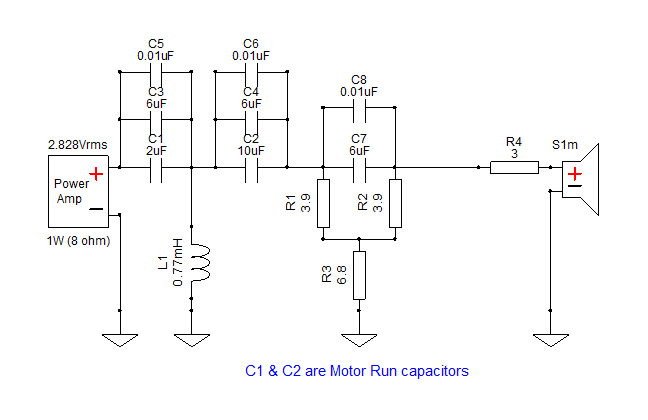

Hopefully these ( quick-pics ) add some clarity.
The motor-run cap values servicing C1 & C2 ( in the above pic ) would be 2uF & 10uF (as seen in the pic below ).
The size of C3 & C4 are ( roughly ) determined by the size of C7 ( which is 6 uF in this particular network ).
- "Roughly", means this is were experimentation comes into play / as long as the total capacitance is maintained for the Cascaded ( combined-value ) caps.
Only C1 & C2 are motor runs ( all the rest are poly's ).
I'd probably start with C1 being 4uF ( & of course, that choice will bump C3 down to 4uF because the combined value that must be maintained at that position is 8uF, from the original network ).

Alternatively, I am also running model 19s and used the following combos to good effect:
2 x 4uF oil with a .1 TFE bypass in place of the 8uF C1
1 x 15uF oil with a 1uF film and a .1 TFE bypass in place of the 16uF C2
1 x 20uF oil with a 1uF film and a .1 TFE bypass in place of the 21uF C3
For C4 I used a 6uF film as it's a HF compensation cap intended to enhance the upper Freq range and I didn't want the softening of the oil caps.

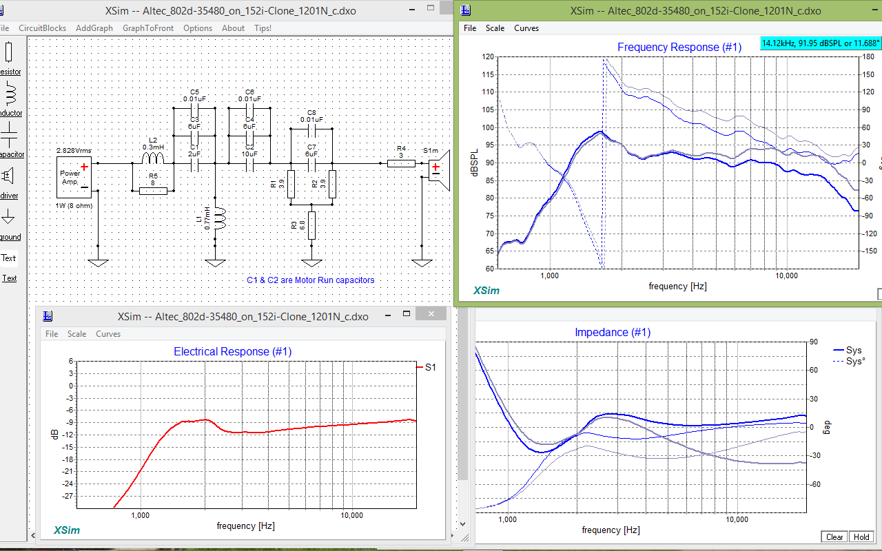

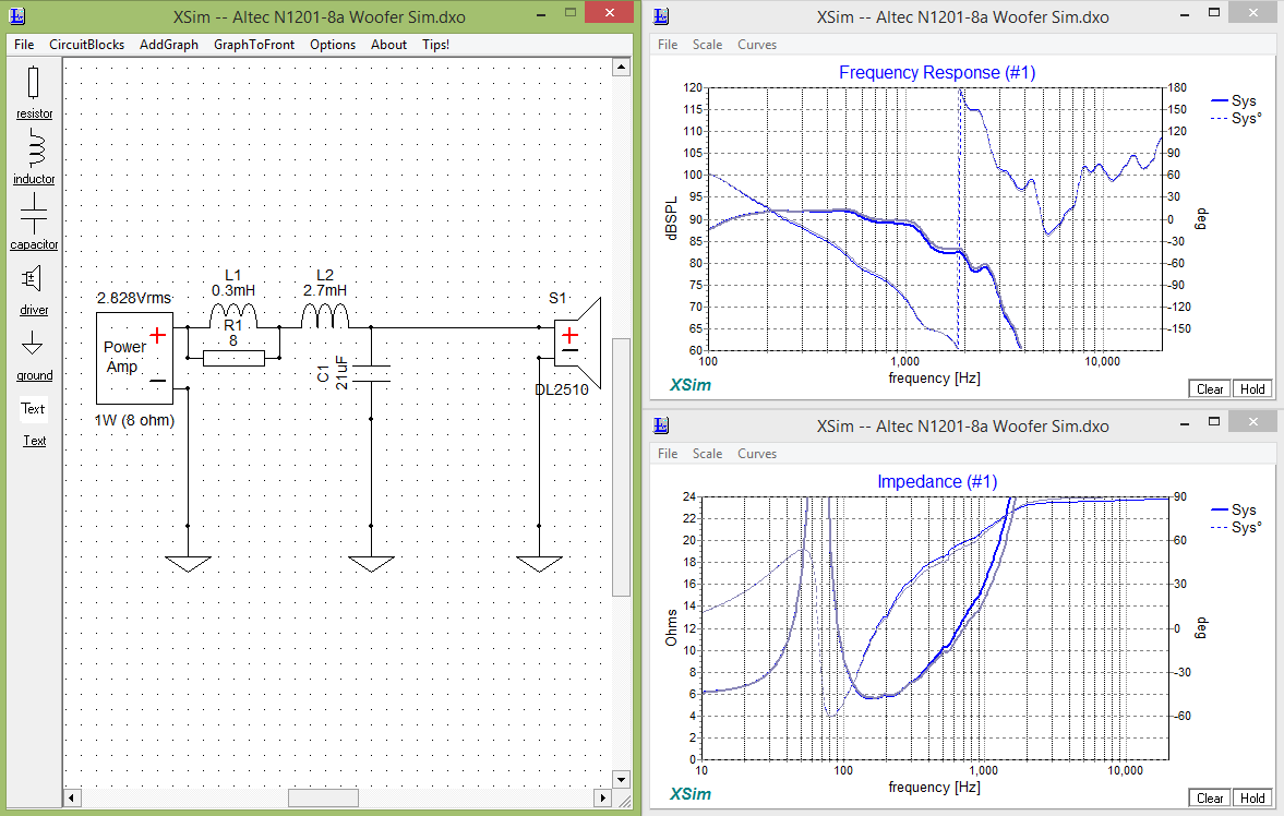

Here's a study of what that .3mH coil does to the HF circuit when the drive ( pot ) is toggled in value between 1R or 8R .
- The blue line is the 8 ohm end of the rotary pot.
( Click the pic for the readable version )
Note: this is not an Altec 811 horn, it's a PVR 152i Clone ( so the FR is not really indicative of what one would get with the 811b.

My graph simply demonstrates the effect ( on the HF above @ 4K ) which occurs when the HF Level knob is rotated to ( mostly ) full on ( ie; CW versus CCW ) .
IME, BSC is a term reserved for bass & bass-mid frequencies even though the net effect ( here ) is accomplished in the same technical manner .

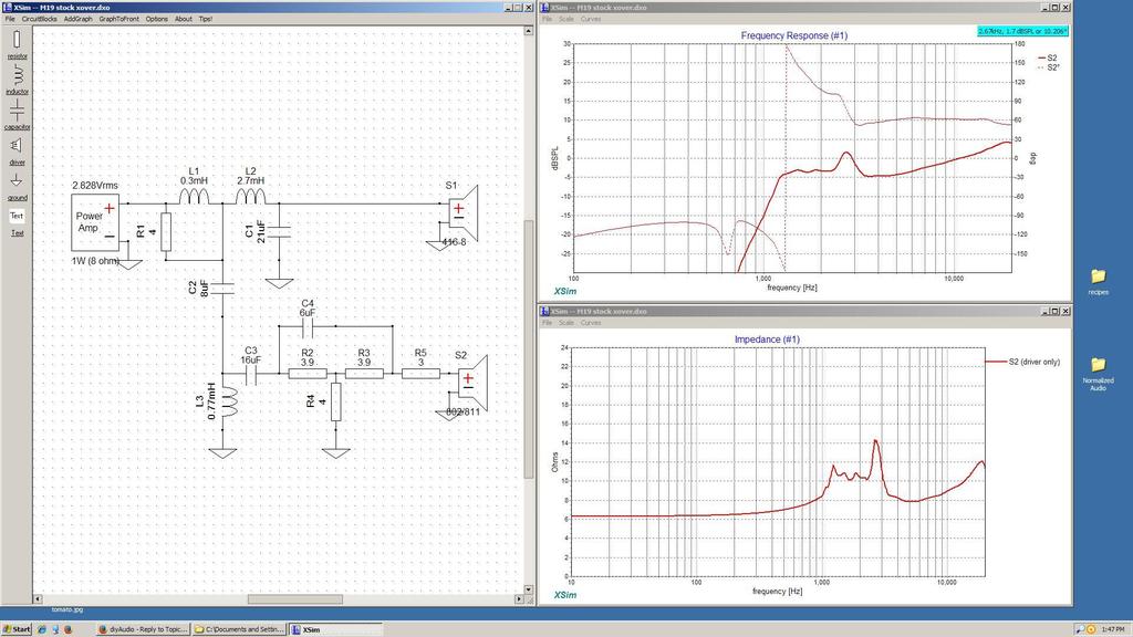

Here's an Xsim shot of the M19 with an actual 802-8G on an 811 horn (FRD & ZMA measured with a WT2) - 416 response not shown because I didn't measure it in the cabinet as yet so I just have the raw driver data.
As for my preference in tonal balance, I enjoy an even handed presentation. In regard to the Z19 xover, I did say analytical rather than clinical but that's splitting hairs. Most visitors here tend to think my 19s are well balanced over all but I realize they are big, old style speakers and I run them with 300B or 2A3 SE amps which have a highish output impedance and hence a lower damping factor. When I hook up a SS amp the bass tightens up and the highs are more pronounced but in either case I wouldn't say that I'm a bass hound.
I do stand by my opinion that the stock crossover with new caps of the same value sounds better to me, in my room.
