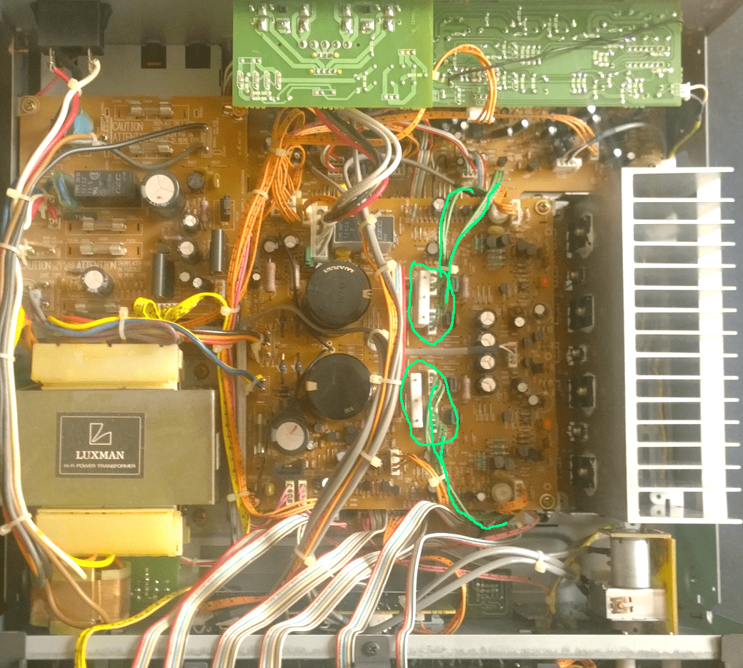

Hi, I have this very old Luxman model A 008 amp that I have never liked how it sounds. Even very basic AV receivers or car amps outperforms it. Currently I run it connected directly to the power section where the red dot on the provided schematic is. Also this cap to the red dot I changed to non polar. The idle current is set according the instructions. What else could I try in order to improve the sound? Thank you in advance

looking at the pcb layout, the output tranies are on a daughter board with leads connected by long plugin leads to the centre of the main pcb, see pic attached. the whole thing looks like a rats nest
If you are, adventurous/curios/bored/a masochist/on a spectrum disorder yet to be defined, you could shorten them and solder to bottom of the pcb to see if there is a difference?
the pics a 007 seems to be the same inside?

Thank you, yes, I will see if I could put the output transistors directly on the board. Their place is in the middle of the board and the heatsink montage could be tricky, but I will try this.
