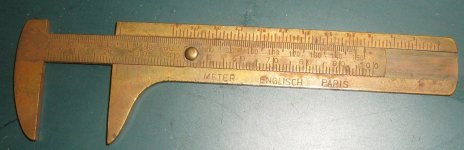

Almost 4 years later ...
At least the upper scale of my caliper - labeled "Paris" and running backwards - found an explanation:
https://en.wikipedia.org/wiki/LigneOne "Ligne" (or Paris Line) is exactly 2.2558291 mm.
When I set the caliper to 10 Lines on the upper scale I get 22.5mm - q.e.d.
The middle scale - labeled "Englisch" - is still waiting for an explanation ....

It is simply a vernier caliper with a different base, a bit like the old slide rules.
You can work it out by measuring drill bits and comparing the readings with a normal caliper, say, 2, 4, 6, 8 and 10 mm bits.
They are accurately ground, and easy to find compared to gauge blocks.
If it says English, then it may be fractional markings rather than decimal markings.
Then look at the pictures of Vernier calipers from English makers, that should help.
It is indicating 22.5 mm on the line just inside the jaw on the lower scale...that is mm.
The upper scale is reading 36 + 10/36 divisions..
So it is a leigne vernier / plain mm caliper, no vernier scale for the mm, only for the Leigne scale.
That has a reversed 0-36 vernier scale, compared to the straight 0-9 I have used on metric calipers.
Will take some getting used to.

The zero by the 150 reads 10, so a scale of 1/10ths of an inch, I presume none of the other scales could be obscure gauges ( wire/springe/sheet steel etc ) because they are generally exponential. Perhaps I can dig out an old mechanics year book and look through the pages of gauges. Unfortunately I only have half ( the moving part ) of the caliper - not like you rich folk with both bits.
Hmmm .... The upper scale is reading 36 + 10/36 divisions.. with "upper scale" you mean upper scale on the moving part, right.
but ... 10/36 of what ? and what does "English" mean in that context as it would refer to the vernier of a "French" scale ... Hmmm
But 10 x 1/10th of an inch should read 25.4mm and not 22.5mm .... ?
100 on the upper scale on the moving part is about 64 on the lower scale.
To that extent, it is a dual scale vernier.
I have seen steel vernier calipers with inches and millimeter markings, with corresponding vernier markings. Much more recent than this, made until the 1970s.
This is similar, so I had suggested measuring known drill bits to find out what scales they are.
You could use tooth paste, or lemon juice, or brass polish to clean the markings on the lower fixed side, might be a vernier scale there too, obscured by the patina.
Clean off the residue from juice...mildly corrosive.

1 ligne = 2.255...mm
See Wikipedia article, possibly a non linear or fractional scale existed, my browser is slow today.
