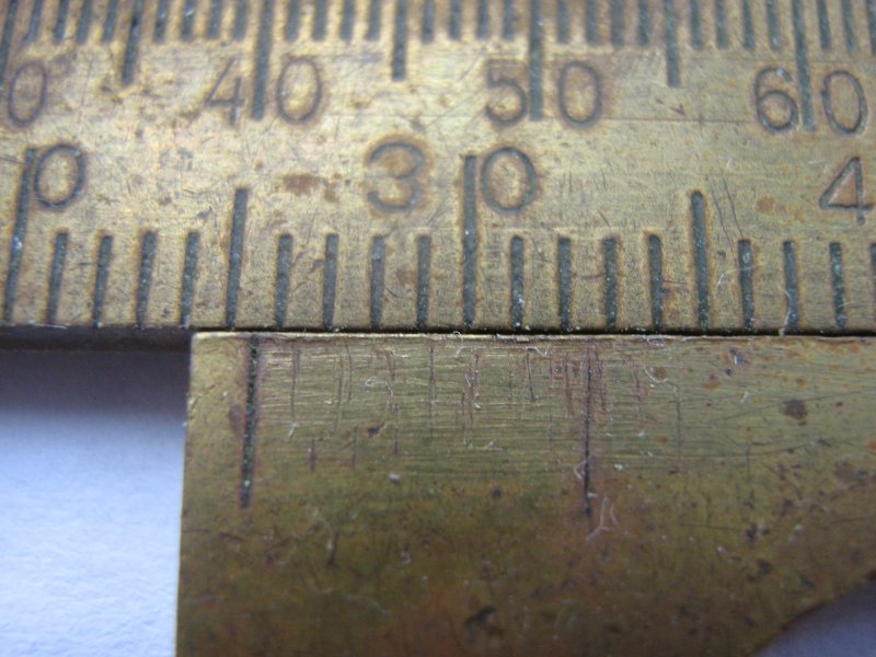

The other thing is a much simpler instrument, a small sliding-caliper, possibly brass-plated steel.
The max extension is 10cm / 100mm which is the lower scale.
But what puzzles me is the other two scales.
On the bottom it reads "Meter - Englisch - Paris"
If this is supposed to correspond to the three scales, then the middle scale should be english, but what english system ever used decimal subdivisions ?
The picture shows the caliper set to 25.4mm or one inch.
Now the english scale reads exactly 40 or 4.0. The only thing that comes to mind is 4/4 of an inch. But there is still the decimal subdivisions ...
But what should I make of the third scale. It runs backwards and yes, there is a separate Zero mark to accommodate this. It runs 0-3-6-9-12 a.s.o.
When set to one inch as shown it reads something like 11.
So, does anybody know what the non-metric scales are ... ?

Re. the caliper:
1) You can easily test if the material is brass or plated steel by using a magnet (won't stick to brass or similar alloys)
2) Sorry to nit-pick, but from your picture it looks like 40 on the middle scale corresponds to somewhere between 25.1 & 25.2 on the lower scale; not 25.4 as you've stated. It is close enough to suggest your conclusion, though. Do you know where in the pre-EU this might have originated? I've heard that in Deutschland, the inch ("Zoll") & foot ("Fuß") were in common use in years past, possibly in parallel with the metric system. Perhaps their definition of the inch varied slightly from today's convention?
3) You may be surprised to know that decimal divisons are/were VERY common with the English/"Imperial" measurement system as we were taught it - any precision machining work and calipers, micrometers, etc. were graduated in decimals (10th's/100th's/1000th's) of an inch.

You should look up Vernier scales! A method of increasing readout resolution before the digital age. Also explains why decimal calibration.
I grew up with analog verniers or nonius as it was called, and here's an example - a little corroded - set to 10.7 mm .
But hold on ... now that you mentioned it, a closer look actually reveals a makeshift vernier on the brass tool, hardly visible, crudely scratched ...
And the material might be solid brass, it is indeed non-magnetic.

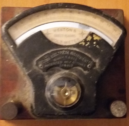

Weston meter low serial number (the scale is actually hand written on a printed template) so ~1890. As was the practice you enhanced resolution by using a mirror and parallax. I had a later version that I used to monitor my off grid solar setup. It was last calibrated in 1950 three days after I was born and was easily better than 1% out of the box (dumpster) :).

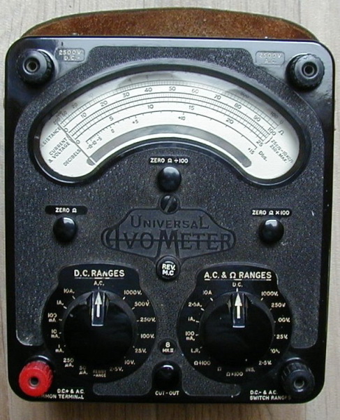

I still use my trusty AVO8 which was gifted to me 50 years ago! Still good to 1% and great for monitoring adjustment nulls. Built like a tank with a ballistic overload cutout to avoid the "needle wrapped around the end stop" syndrome.
The box with the moving arm, as my younger sister described it once! I'll bet a fair number of older (= ancient) UK members have one.
I have got two of the very similar AVO9s.
