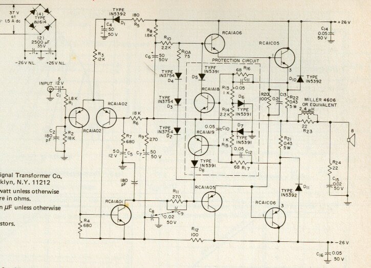

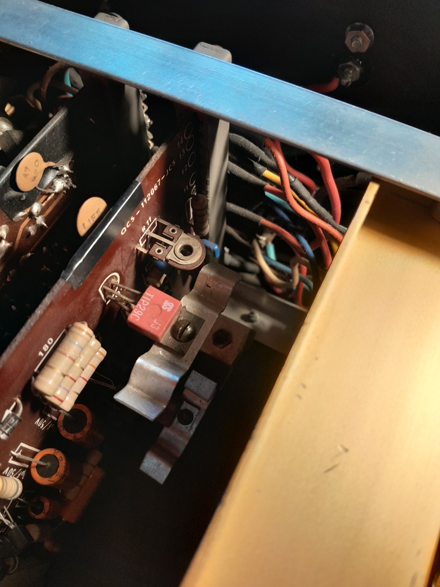

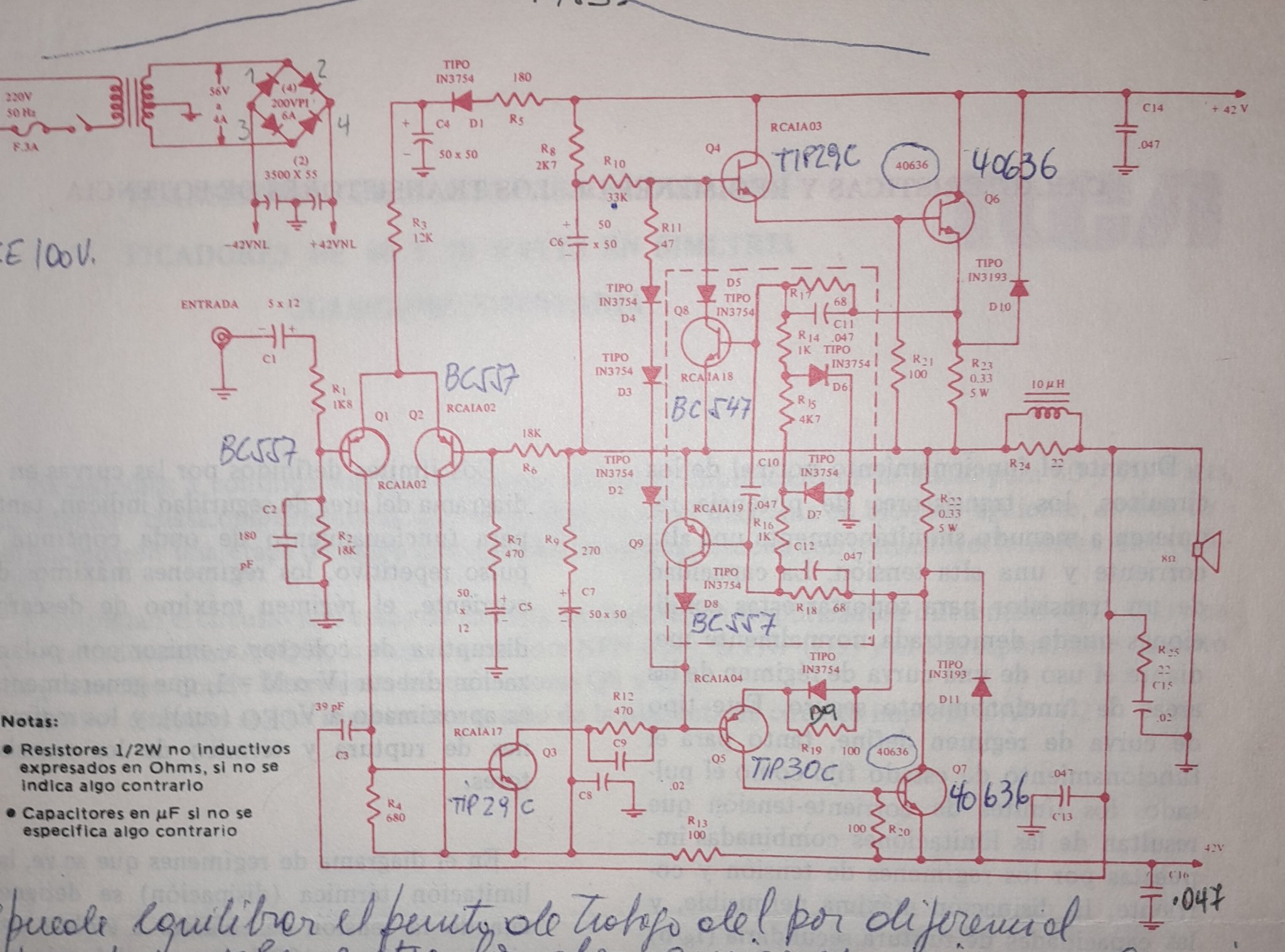

This is a request for help to the older ones here ( me too 😉 ) twho surely knew the RCA power amp based on the UAP-02 board. I'm talking about the 70's. I built the 70 Watt version of this amplifier back then, and every now and then I used it, normally I used it with my PC to feed two small speakers, so it was never used intensively or at high volumes. But, (there's always a first time) lately the left channel started to heat up so I decided to put the noble NAD 3020 in its place, and decided to see what was causing the overheating. I proceeded to check DC voltages at the output (Offset), 1.0 mV on the left channel and 9.0 mV on the right, which I considered acceptable, so the next step was to check the quiescent currents (Bias). As it was recommended in the days of analog multimeters, I did not use the typical procedure of inserting the ammeter in the collector junction of the output TRs with the + B, because the internal impedance of the same would slightly alter the measurement and this method forces us from physically opening the circuit. (Although I remember having done it on DIY - Phillips boards without problems - I do not know if using a digital multimeter the same thing happens) Applying Ohm's Law, in theory the Bias of the left channel was 41.5 mA, and of the right channel 45.9 mA, which caught my attention, I expected that the one that exceeded the maximum recommended by RCA (40 mA) was the channel that was heating up, the left one, but it is the other way around.
That said, I proceeded to adjust the presets of both channels. (RCA recommended installing a 100 Ohm preset instead of R11 in case of temperature problems.) and I managed to adjust both channels as you can see:
+B 39.5 Volts DC / 117.5 Ohms = 33.6 mA.

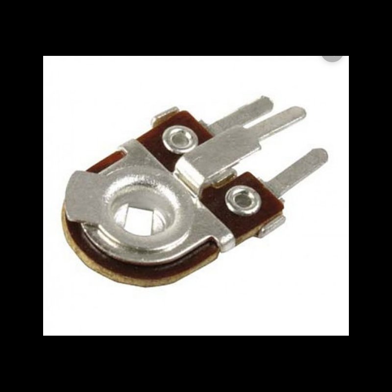

I was surprised that the preset allowed me to exceed the maximum 100 Ohms, but I suppose that the manufacturing tolerances in those years were quite large.
But, I was greatly surprised to find that after these adjustments, BOTH channels overheated much more, evenly and gradually, and in a few minutes!
With an ambient temperature of 27 ° C, in 10 minutes the heat sinks reached 45 ° C! The amplifier works well, and the offset now, with this temperature, is 8 mV on the right channel and 0.7 mV on the left channel.....At this point, I turn off the amplifier, the 40636 output from RCA indicates maximum 200 °C, but I won't wait to spoil them, this operation is not normal...
I really can't figure out why this can happen, I thought that some TR - input differential pair - could have become unbalanced, which usually causes anomalies in the DC output, but, that failure in both channels simultaneously? And also the DC at the speaker output is not so high...
Should I go back to the traditional Bias adjustment?
What have I forgotten in all these years ?
I will appreciate any thoughts that help !
PS: The diagrams are taken from the web, the notes and measurements do not correspond to my amplifier. I will look for the original diagram and upload it, although being in red I fear that it is not very visible.

The pictures you provided do not show how big your heat sink is, nor whether the mica pad and thermal grease are any good after these years. I found the heat sink in my dynakit ST-120 that used 40636 outputs was totally inadequate for anything but the FTC one hour test, and changed over to two salvaged from Pentium II computers. 2 cm x 10 cm x 6 cm with about 6 fins.
None of the quasicomp designs of those days have an emitter resistor on the bottom output transistor. Diagram 3 and your later diagram do not have one. You could get away with that with real 60636, 1C05 or other homotaxial transistors, but anything epitaxial like TIP3055 MJ802 or later requires an emitter resistor to not run away thermally. Modern stock labeled 2n3055 is not homotaxial and requires emitter resistor protection. The old RCA factory is now a county park in New Jersey.
Unusual heating can be ultrasonic oscillation. If your analog VOM has 20 vac scale, block the negative probe with a 390 pf capacitor 50 v or higher. Connect that to speaker ground and plus to speaker hot. If you are getting significant AC voltage, it has to be ultrasonic because 390 pf will not pass music frequencies. Note the Simpson 266-XLPM I own will read voltage below 0.7 vac because it has a selenium bridge, not silicon diodes.
BTW if you want to signal trace, exercise input with a FM radio turned down to 1/3 to produce 1.5 vac music. Block the negative probe on 20 vac, or 2 vac on the front end, with a .047 uf 100 v or more capacitor.
Yes, when setting idle bias current I short the input then read DC voltage on one of the emitter resistors of an output transistor. R23 or R22 of your last schematic diagram.
As long as the PNP driver emitter is tied to the output collector, and both are run through the “emitter” resistor in the collector of the lower output, an additional resistor in the emitter is unnecessary. The lower output is a bog standard CFP, and that’s where the resistor usually goes when CFP is used in a complementary design.
In other RCA designs multiple outputs are paralleled. Since this requires ballasting, the resistors are put in the emitter, and the driver emitter is tied directly to the speaker out (through the Baxandall diode, if one is used). This configuration can be used with only one output device - it’s just not used here. The emitter resistor goes in one place or the other. Both result in slightly different “negative half” characteristics. Neither is exactly the same as the positive half.
As far as thermal stability, it’s the total emitter resistance that matters. One side doesn’t even need one, if the other is doubled. This however, results in more distortion.

If you replace the string of diodes by a Vbe multiplier, you will be able to adjust it to the chosen value, it is better to do it without any load connected to avoid error caused by the small offset voltage at the output.
Time and thermal inertia also play in the adjustment, the transistor used for the Vbe multiplier can be glued on top of the output transistors.
At that time, I only had an oscilloscope, so I increased the idle current until the crossover distortion "disappeared" on the screen.
How many NTE60 (1988) or other MJ15003 copies have you burnt up? My count is 4, driven by the dyna PC-14 with only one emitter resistor. Apex AX6 has an emitter resistor on both output transistors. As does the PC-14 side of my ST-120 these days. No telling whether the second emitter resistor or the fans stopped the damage.
My RCA catalogs totally skip the 40636 1A 1B 1C days. Sorry. Why the 70 w -6 amp schematic has 1C05 is a mystery to me.
The -6 isn’t 70W, it’s only +/-26V and uses the TO220 output types. They can of course be used as rugged drivers (more rugged than 40409/10). My current RCA catalog is missing most of the 1A 1B 1C stuff too, but an old one I had years ago had it all. Back when the 40411 was the primo 2N3055-oid. This one from 82 doesn’t have the 40411 in it anymore.
For the circuit in question R22 is the emitter resistor in the lower half. I’ve seen plenty of stable circuits using only one side. They increase the value to 1 to 1.5 ohms. 0.22 to 0.33 isn’t enough. And ALL of those were single supply so it never tried to force the output to zero volts, either.
AnibalThe easiest way is measuring the voltage drop across the emitter resistors of the output transistors.

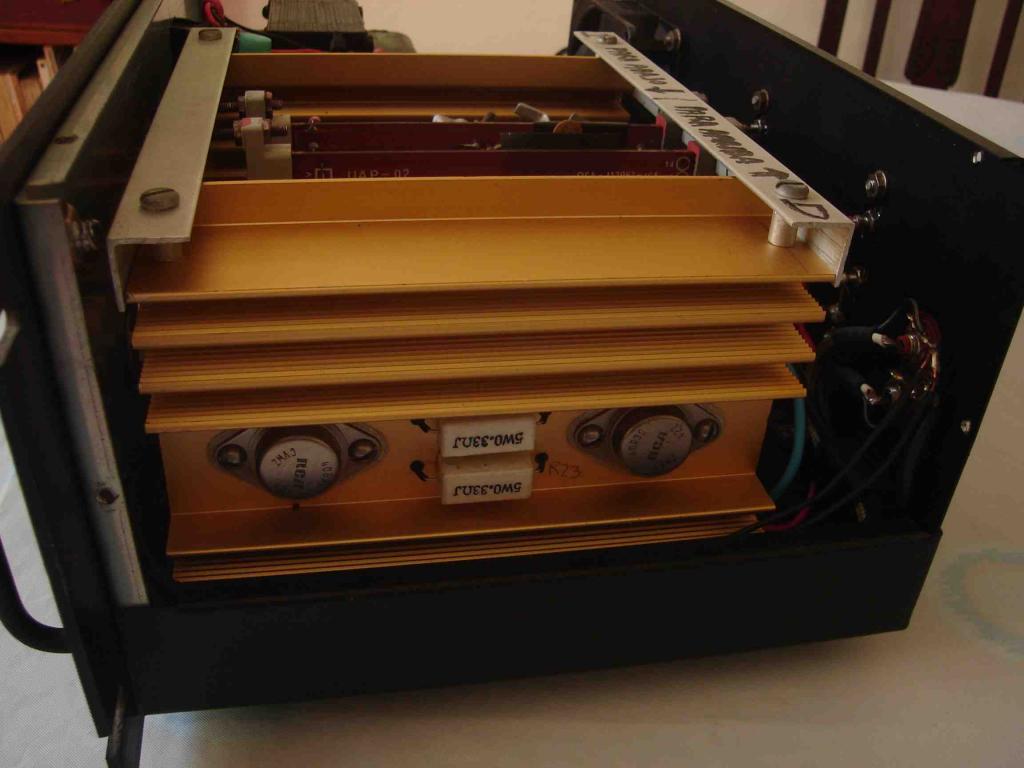

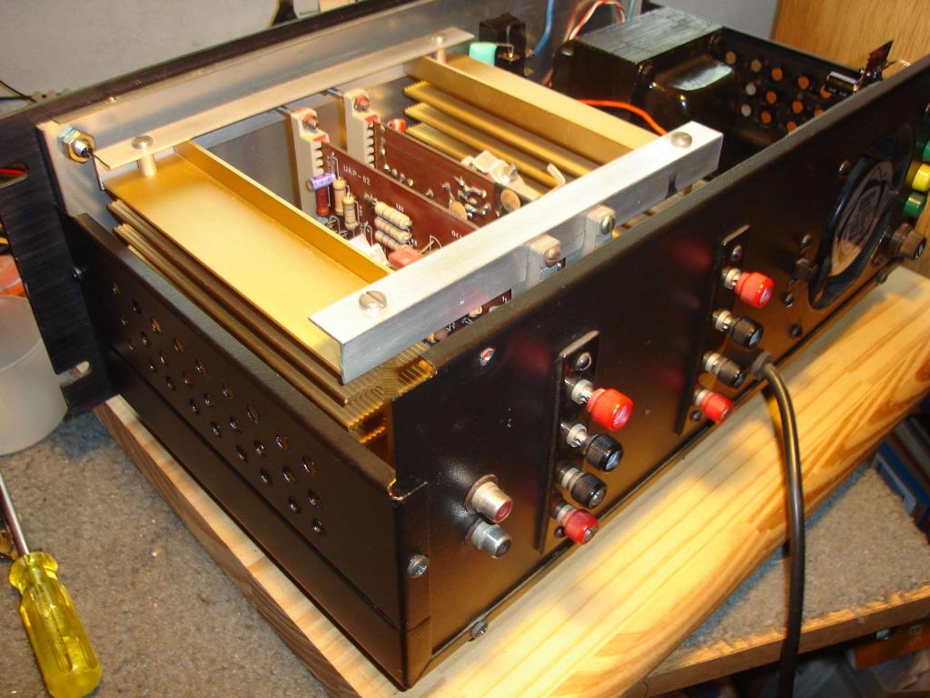

As you can see in the pictures above, the heatsinks I used at the time are extruded aluminum heatsinks with good performance, the problem was that I couldn't place them vertically, which would have been ideal, because they didn't fit inside the cabinet.The pictures you provided do not show how big your heat sink is, nor whether the mica pad and thermal grease are any good after these years ...........
The cabinet is 35.5 cm wide x 20 cm deep x 14 cm high
Each heatsink measures (Taking the position inside the cabinet)
15 cm deep x 11 cm high x 3.2 cm wide
Anyway, you'll see that the problem wasn't the heatsinks, let me give you a little suspense on this, because I've been lucky in the arrangement and I don't want to end the thread so soon! ....😉

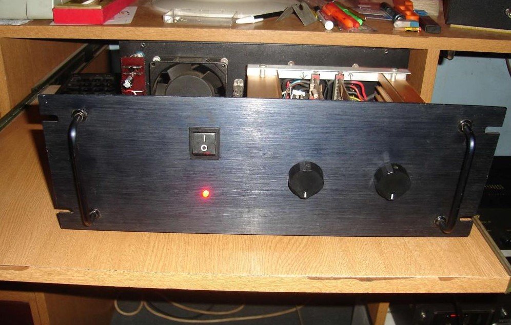

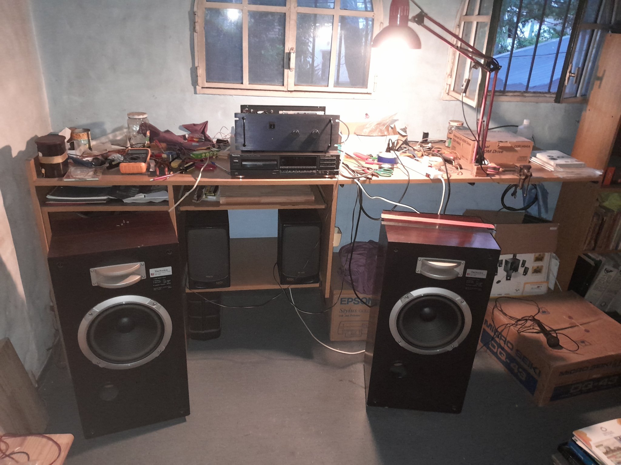

I took this picture a few moments ago in my "man cave", (very messy, yes...) you can see the amp being tested with some Technics SB1950s....hey, that's the year I was born ! 😳
Yes, actually the circuit I attached (in red) already had the latest updates from RCA in those years. It corresponds to a bulletin from Eneka, distributor here of the plates and components to assemble the amplifierit ( was not a kit ) , is from August 1977. On the advice of my friend David that I mentioned before, (who checked in the oscilloscope that there were no oscillations in the output), only two 47 Pf capacitors were added to this diagram between C and B of Q4 and Q5, and 18 Pf in parallel with R6. Don't ask me what function they perform, I have forgotten and currently I have no more contact with him, he moved to Barcelona, Spain. A pity, because he was my consultant here and he really knew a lot....🙄The -6 isn’t 70W, it’s only +/-26V and uses the TO220 output types.....
50 pf c to b on the drivers were added in the "TIP mod" to the dynaco ST-120 which also used quasi comp homotaxial output transistors. My shorted TO3 transistor were dynaco house number marked so no telling if 40411 40636 or 2n3773. I got the number 40636 from the Armstrong 621 schematic, dynaco never revealed their part secrets. Cap parallel to R6 is called "compensation" and has something to do with preventing feedback oscillation. My ST-120 had no feedback transistor Q2.only two 47 Pf capacitors were added to this diagram between C and B of Q4 and Q5, and 18 Pf in parallel with R6.
Sorry I did not spot the heat sinks picture lower left of post #1. Enthusiastically large.

Bueno, volviendo a mi problema, parece que tuve un error al intentar ajustar la corriente de reposo. Pensé que R11 se insertaba directamente entre el colector de Q6 y VCC, y no es así, ajusta el driver de Q6, es decir Q4. Al observar el circuito observé esto y me equivoqué...:ups:
Así que ajusté el valor predeterminado de 100 ohmios a 45 ohmios en cada canal y todo volvió a la normalidad. Tenga en cuenta que es ligeramente inferior al valor original de R11, es decir, 47 ohmios. No hubo más sobrecalentamiento, la temperatura en cada disipador de calor después de un largo tiempo de reproducción de música (con una temperatura ambiente de 25 °C) es de 33 °C a un volumen medio.
¿Y cuál es entonces la corriente de reposo real? Bueno, no más cálculos ni mediciones por ahora, ¡hoy es Navidad!

If R11 is a potentiometer that shorts one end to the wiper, then that is subject to opening up when the wiper oxidizes in 5 to 20 years. The resistance then goes maximum value. 45 versus 47 would net be dangerous, but any value below that, I would clamp R11 end to end with a 1n4148 or schottky diode (0.3 v) as appropriate to prevent thermal overload.
You will notice R11 d2 d3 d4 form a stack driven by the VAS Q3. This makes the base of driver Q4 more than 2 v above the base of driver Q5. This approximates the 4 diode drops Q4 Q6 Q7 Q5 necessary to keep both output transistors on slightly at the same time.
Q8 Q9 appear to be VI limiters, that limit base drive current to the drivers if the currents in R23 R22 get too high. Kind of a frill on an amp this low power.

Reading in some books I updated my somewhat forgotten knowledge:
" Depending on the type of circuit, the quiescent current is normally between 20 to 45 mA "
" If it is less than the minimum recommended, the amplifier will have crossover distortion, and this will mainly affect the low frequencies "
" If it is greater than the maximum recommended, the amplifier will enter thermal runaway "
" The voltage drop across the emitter R must be exact or at least approximately equal in each of them."
So, in this quasi-complementary symmetrical RCA circuit, we have a recommendation of 20 to 40 mA, so I proceeded - with some patience and a lot of care not to cause any short circuits with the multimeter tips - to adjust the two channels to the following values.
Left channel :
R22 = 95 mV / 0.33 Ohms = 28,7 mA
R23 = 93 mV / 0.33 Ohms = 28,1 mA
Right channel :
R22 = 97 mV / 0.33 Ohms = 29,3 mA
R23 = 96 mV / 0.33 Ohms = 29,0 mA
Finished the work, thanks for stopping by. 🙂
